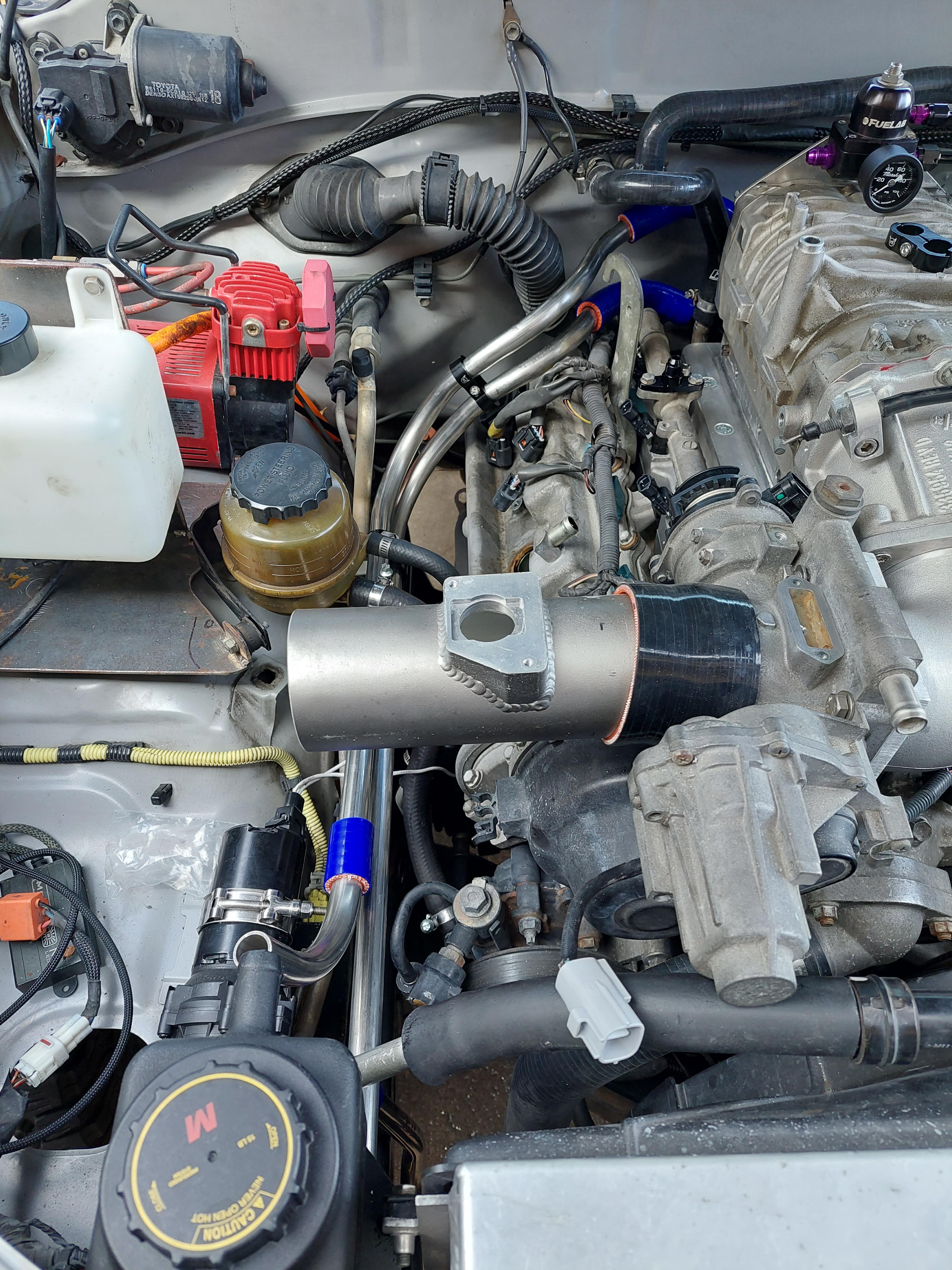

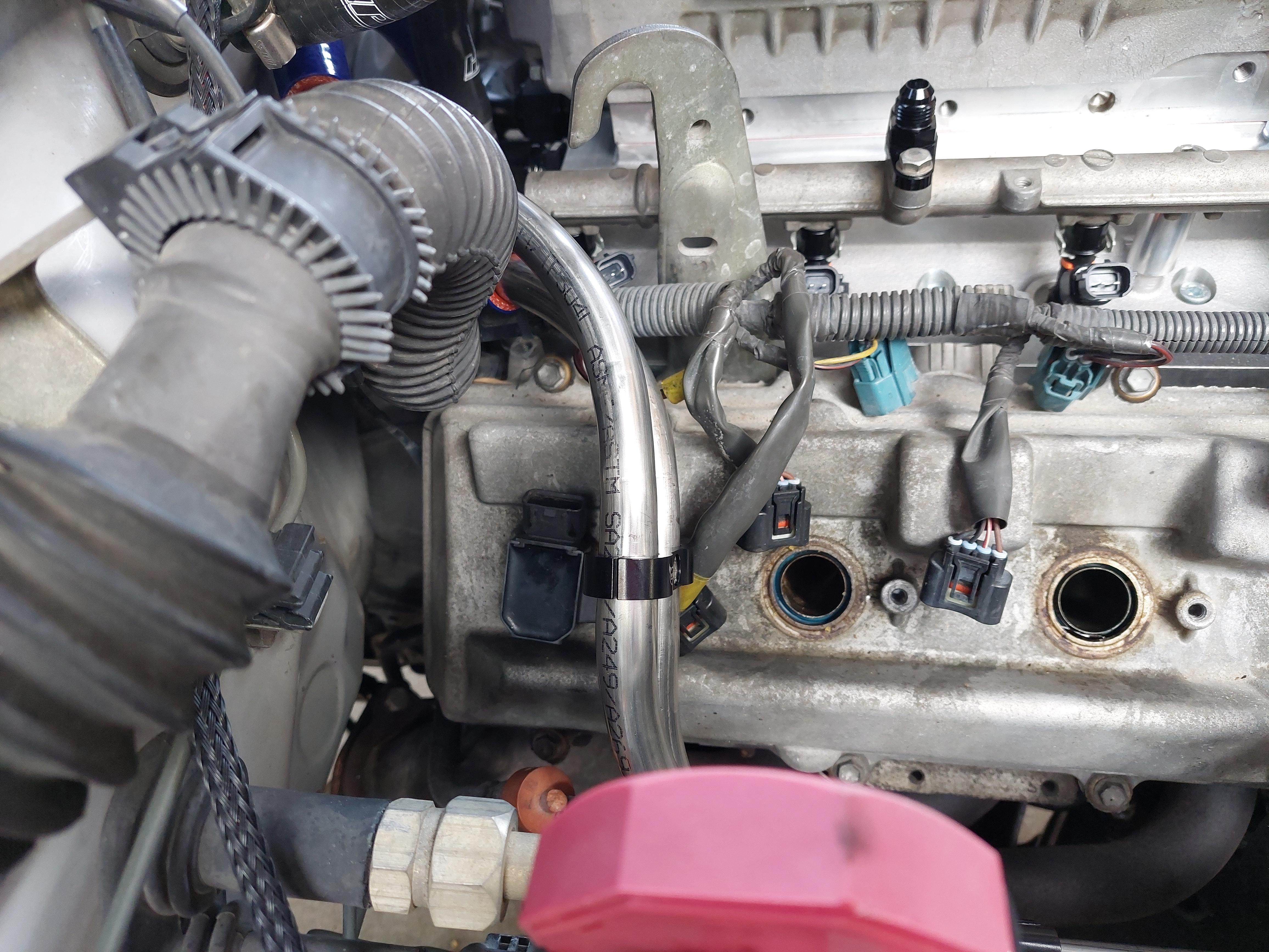

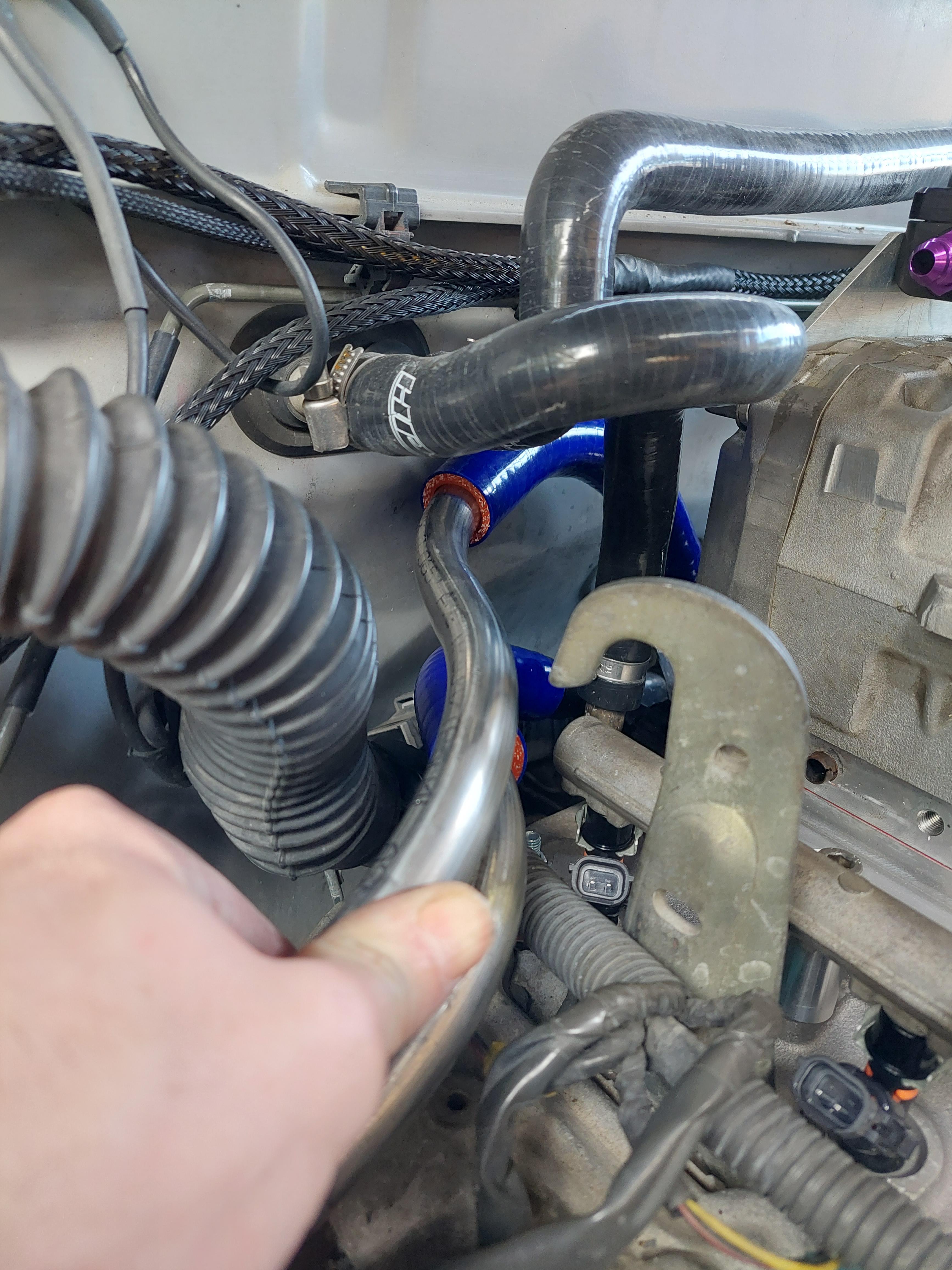

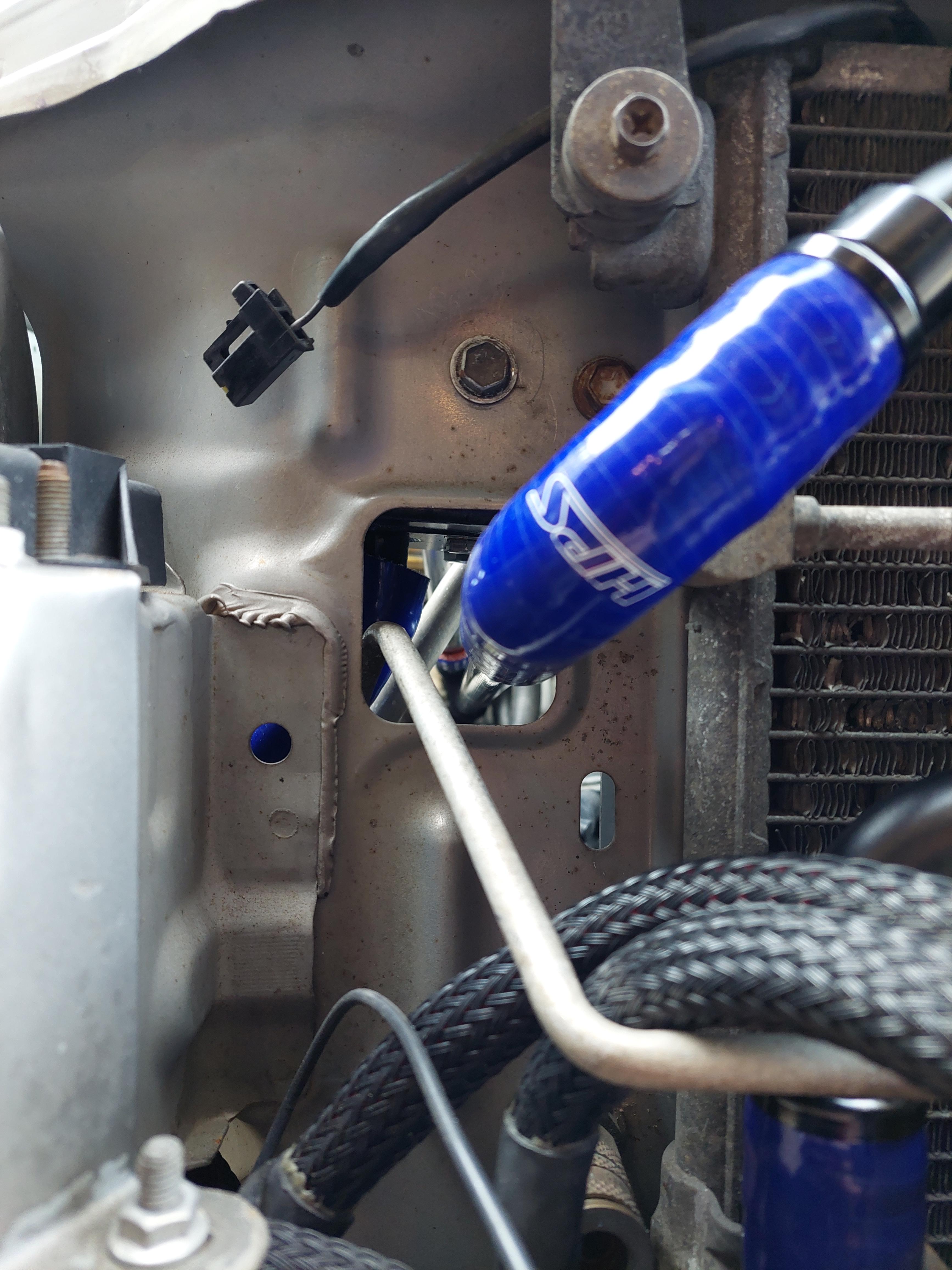

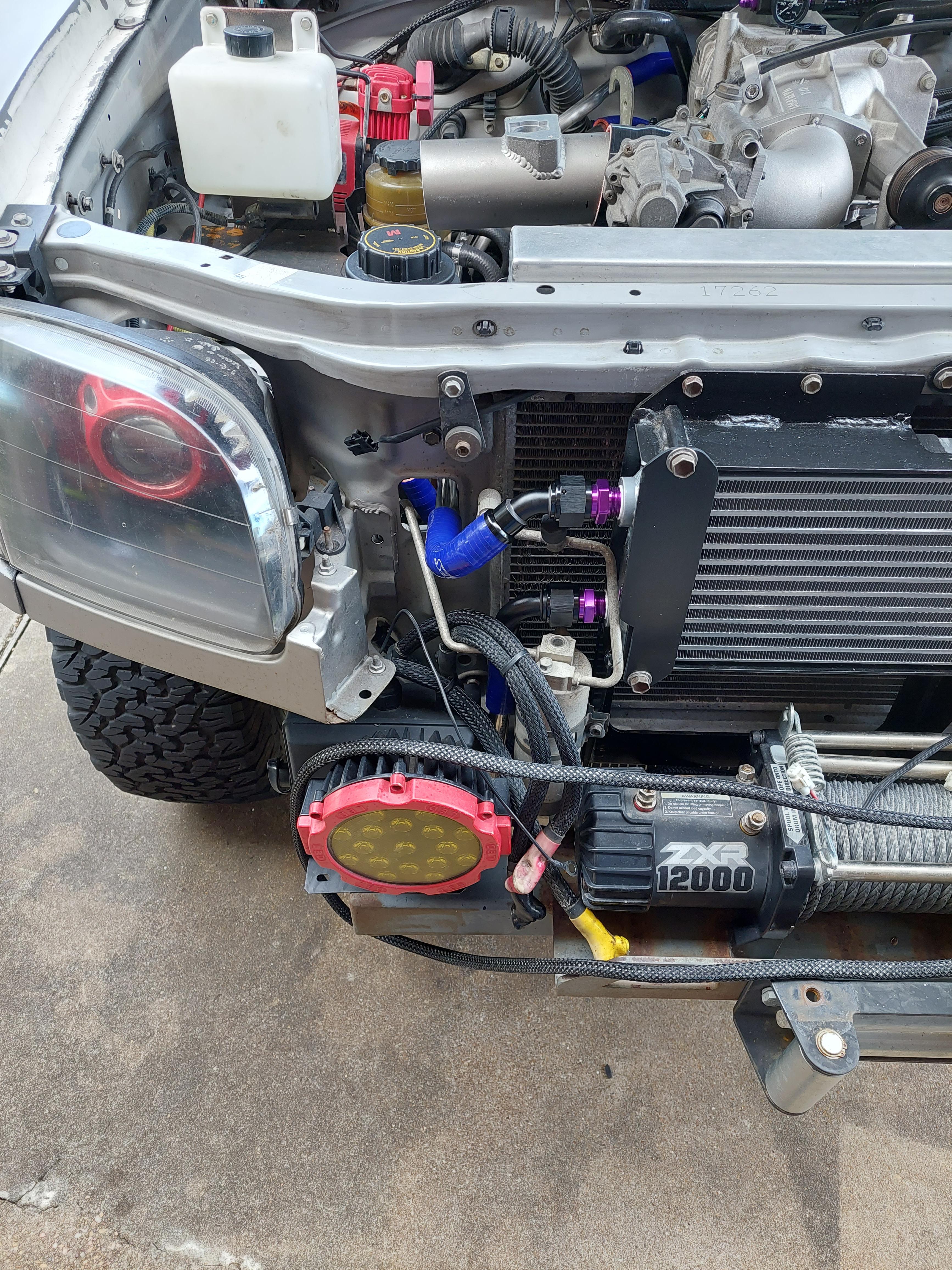

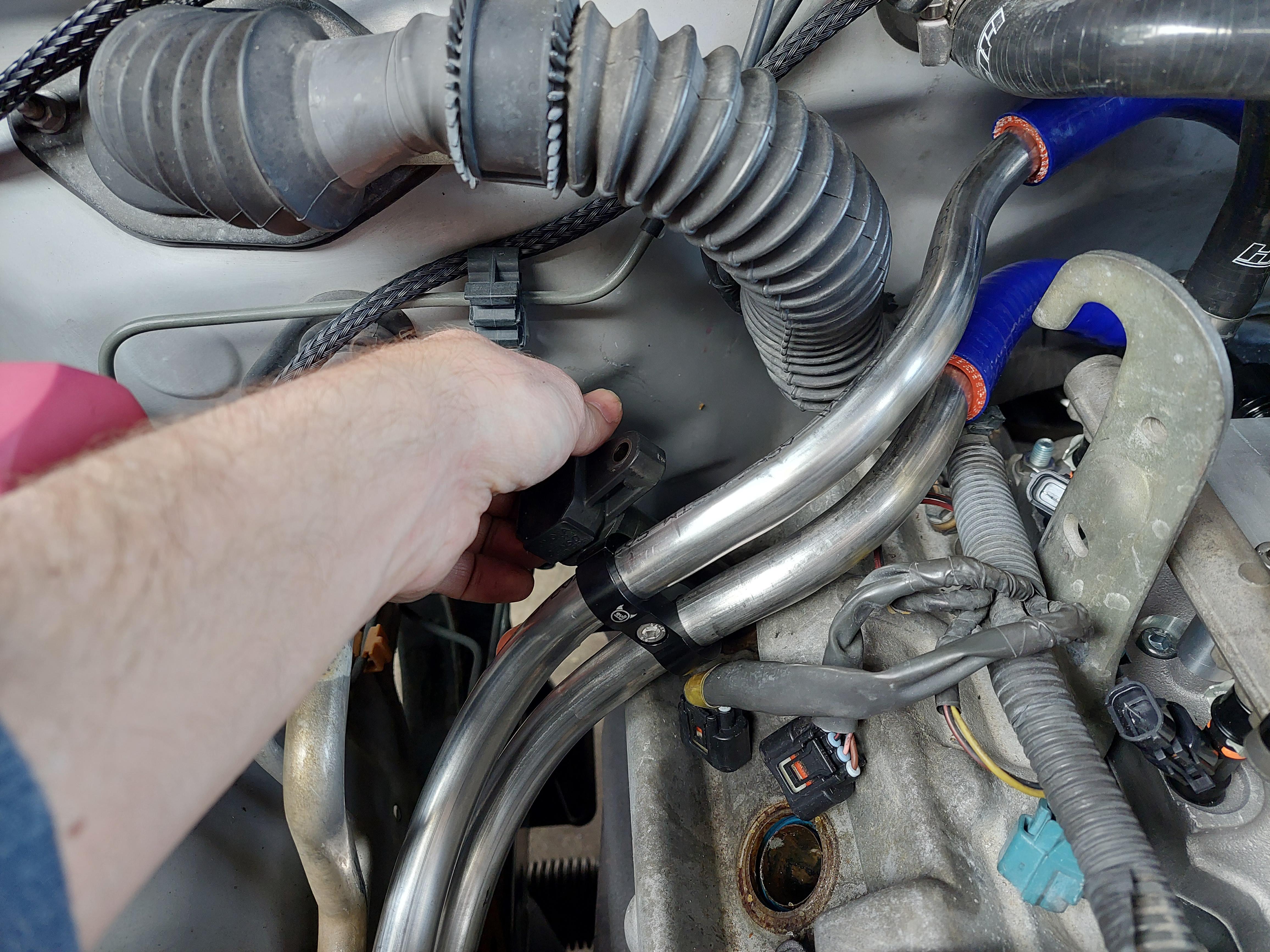

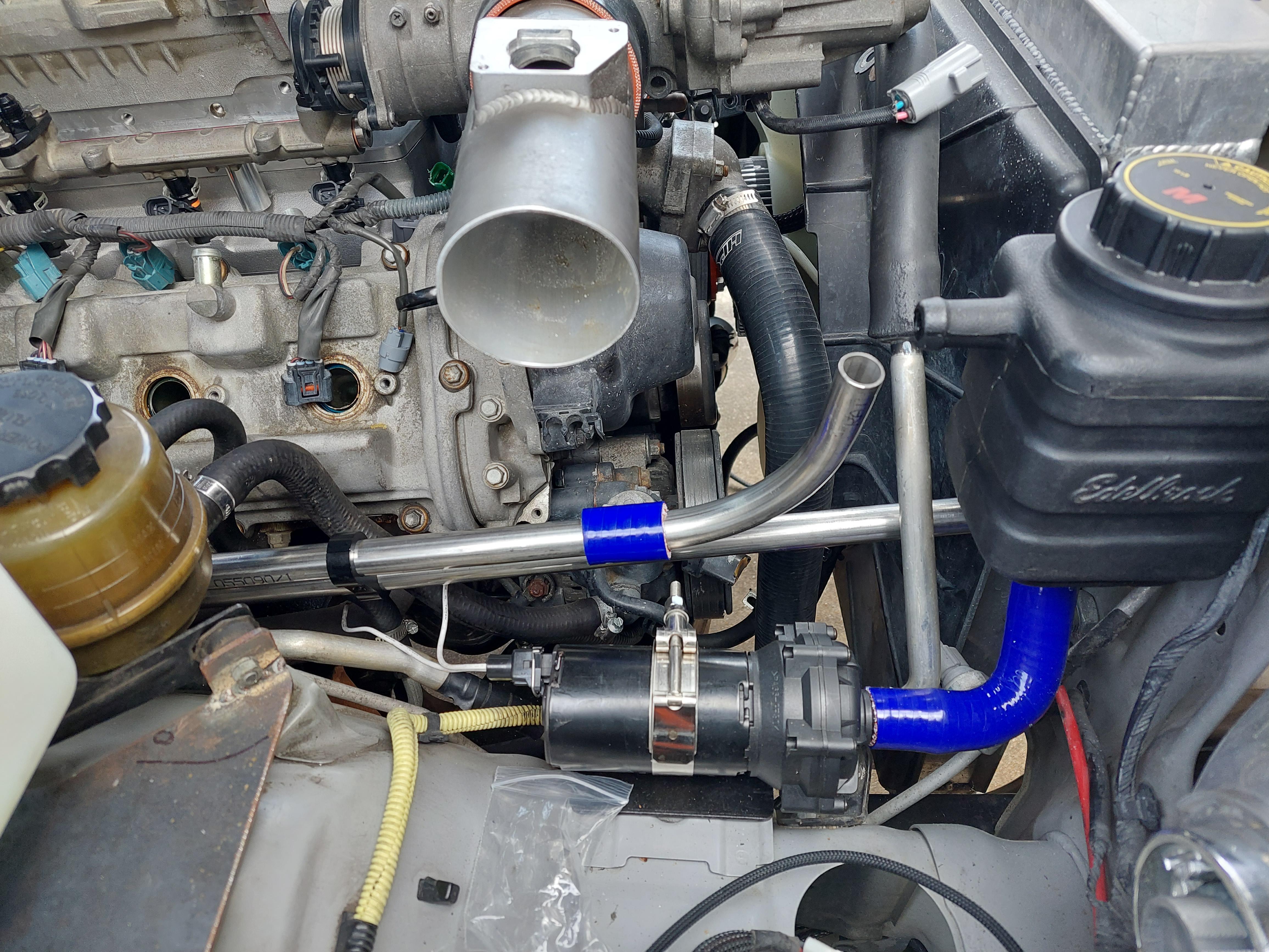

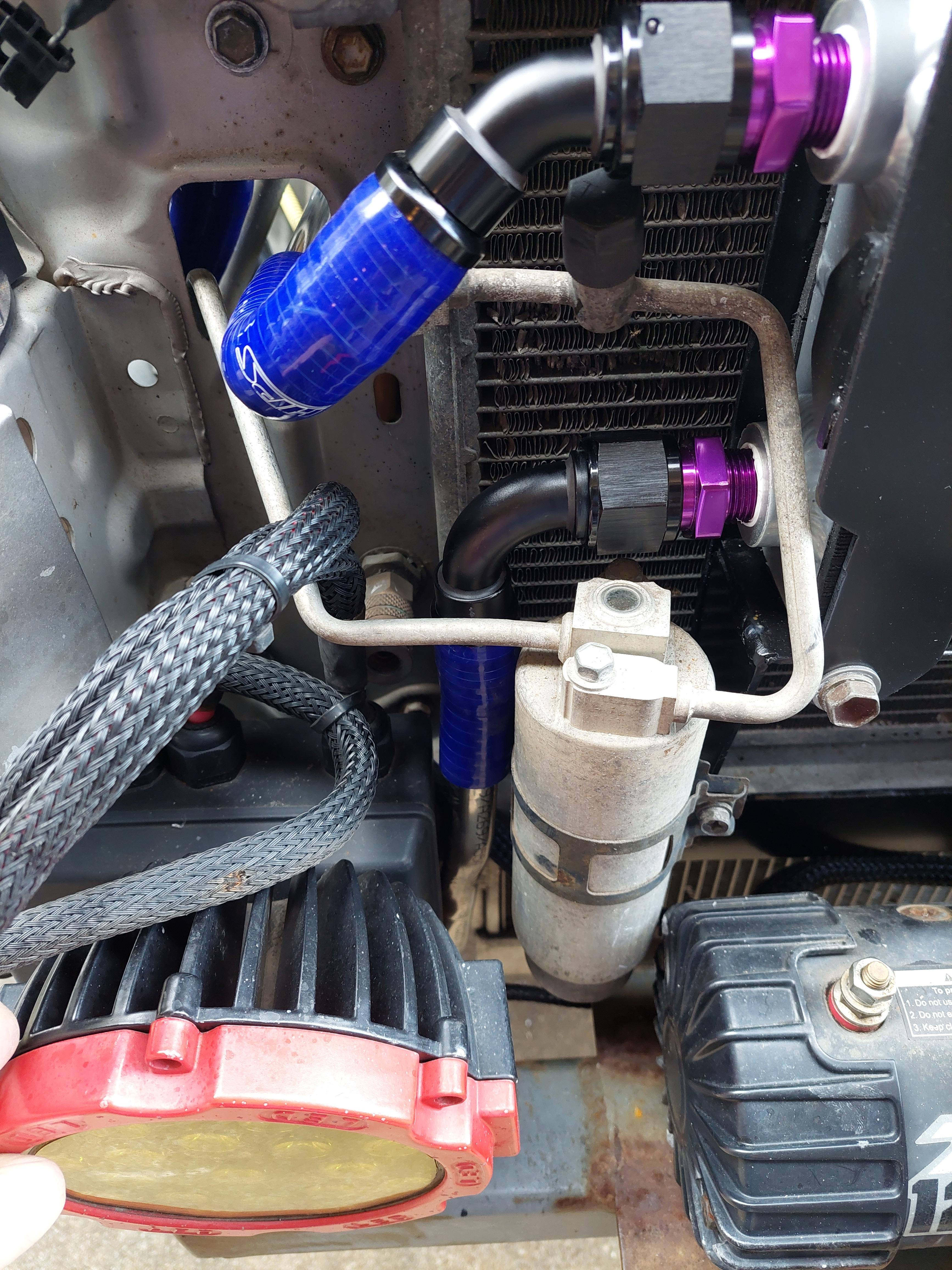

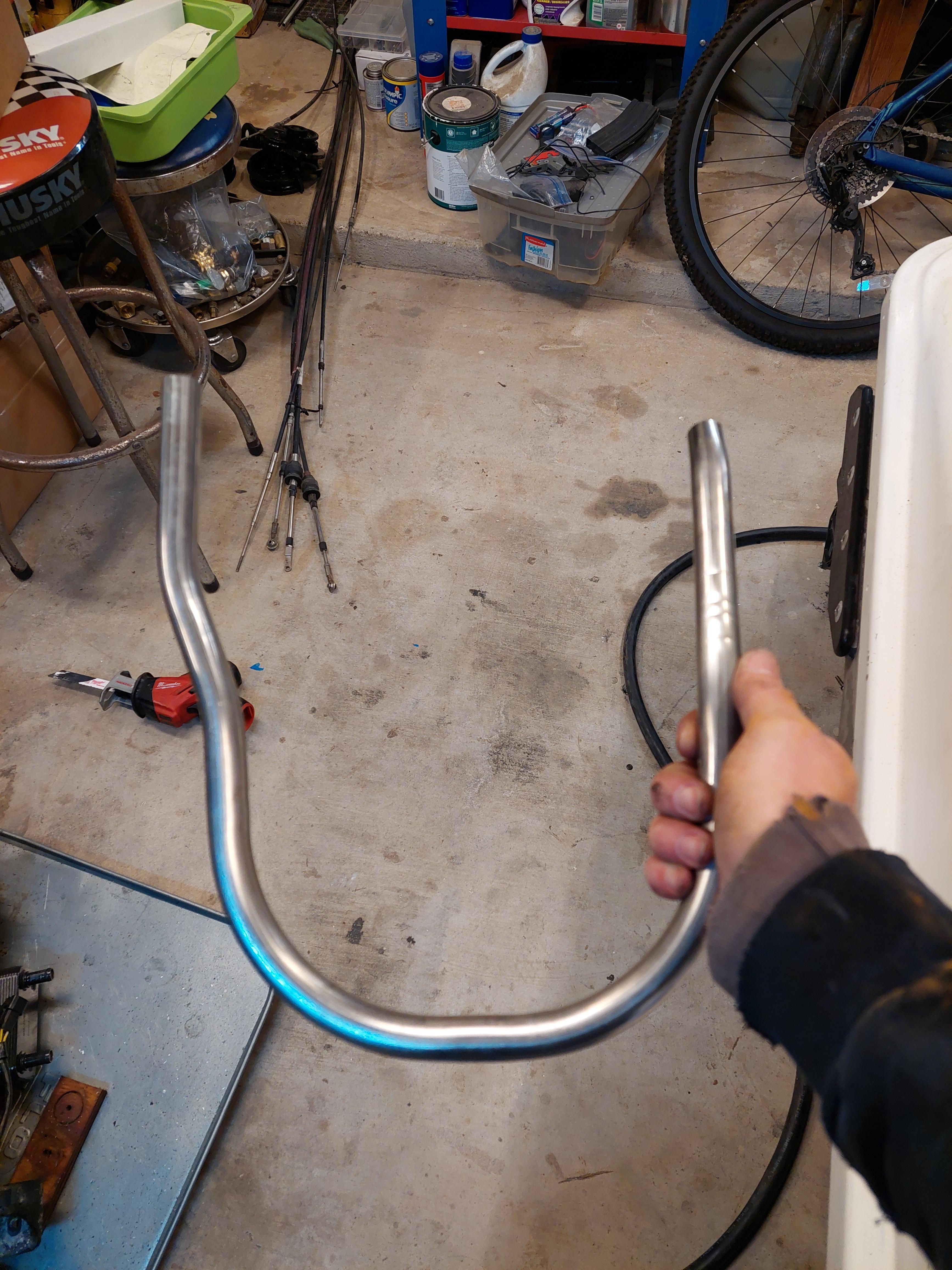

Intercooler heat exchanger plumbing.
All 3/4" stainless tube and hps silicone piping. I need to fab the mounts for the tubes but I am pretty happy with how it has tuned out considering the bender I used was cheap and broke in the proceess.
I still need to fab the mounts for it and do end prep for the hoses.

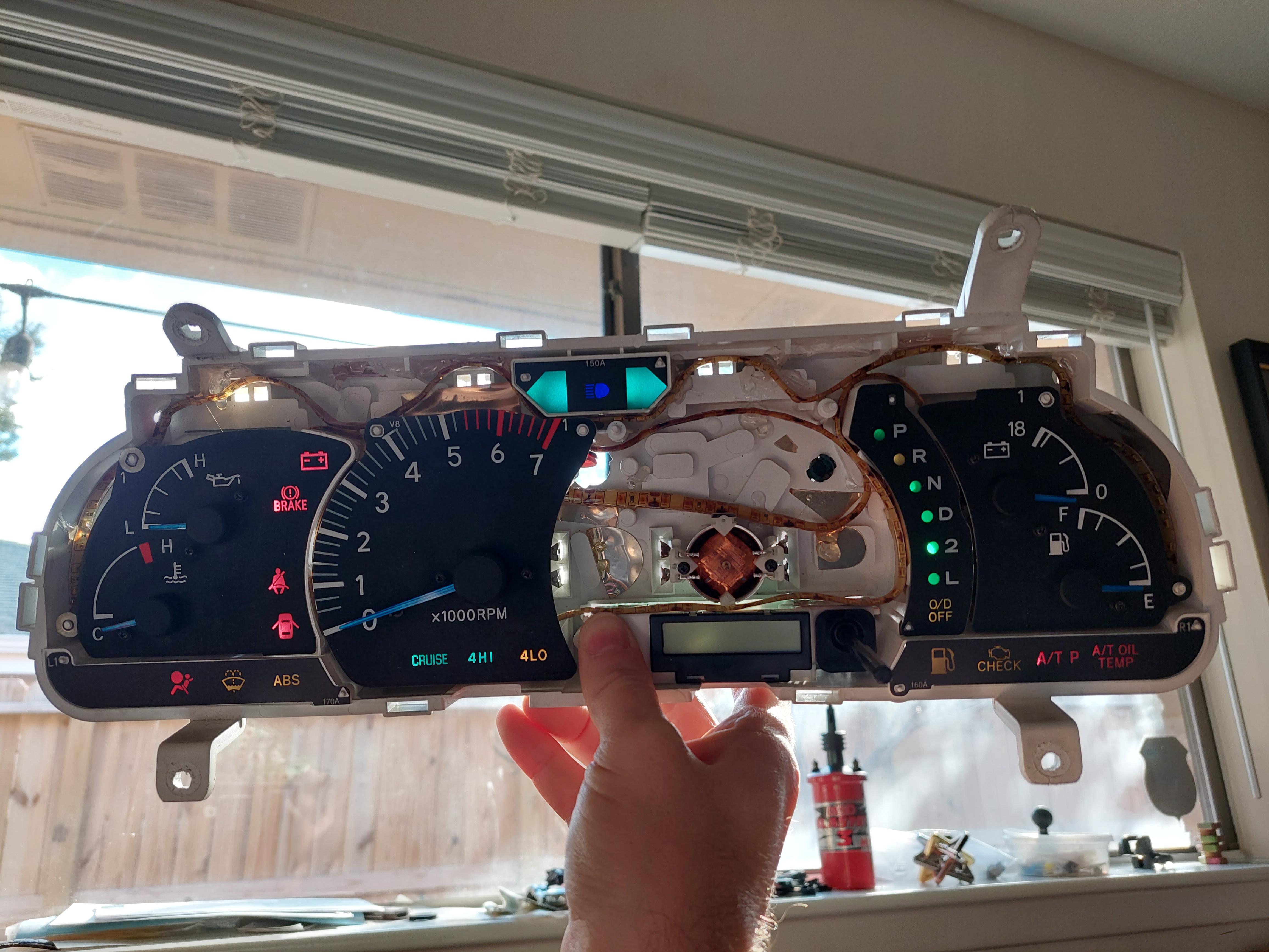

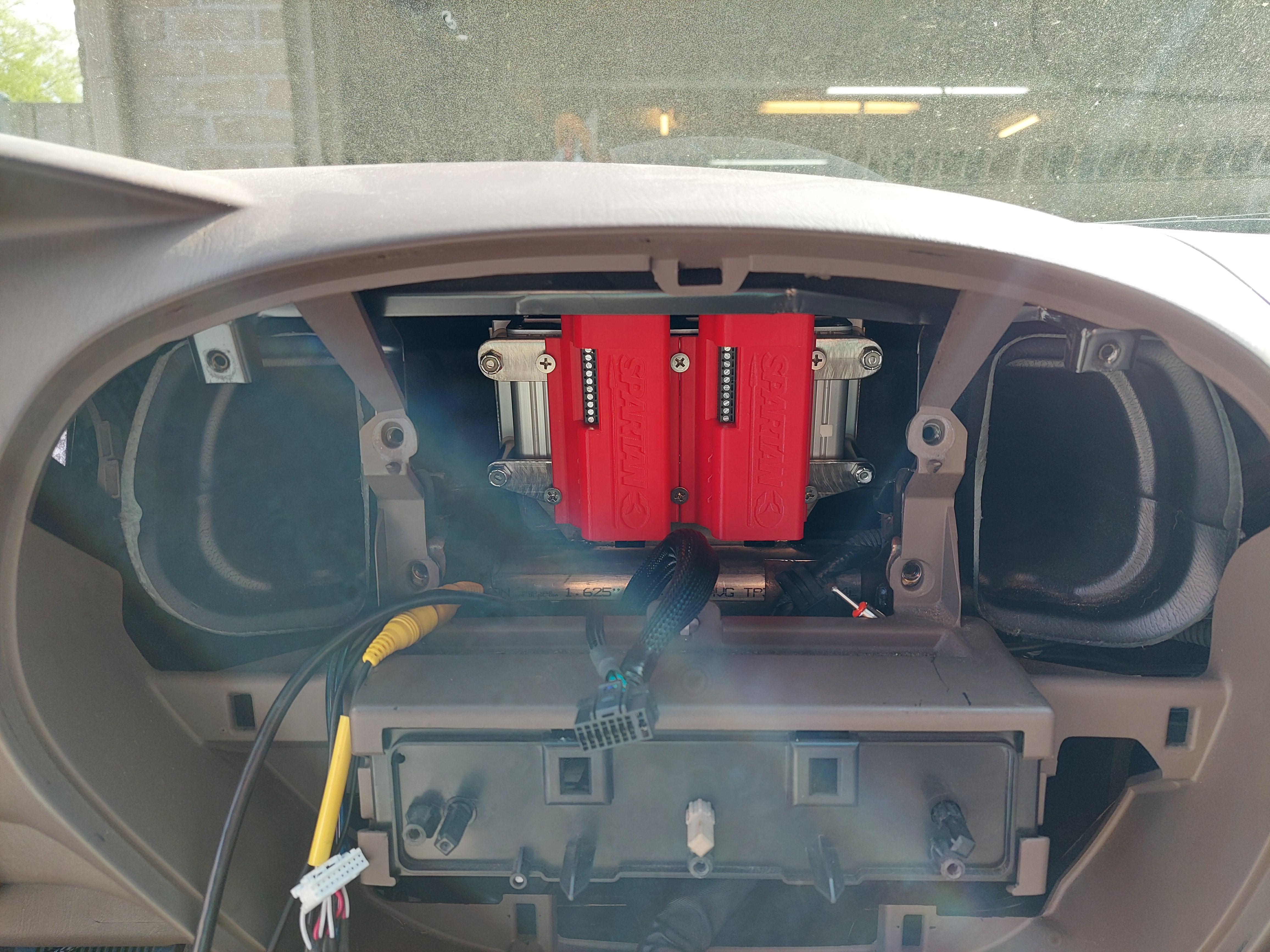

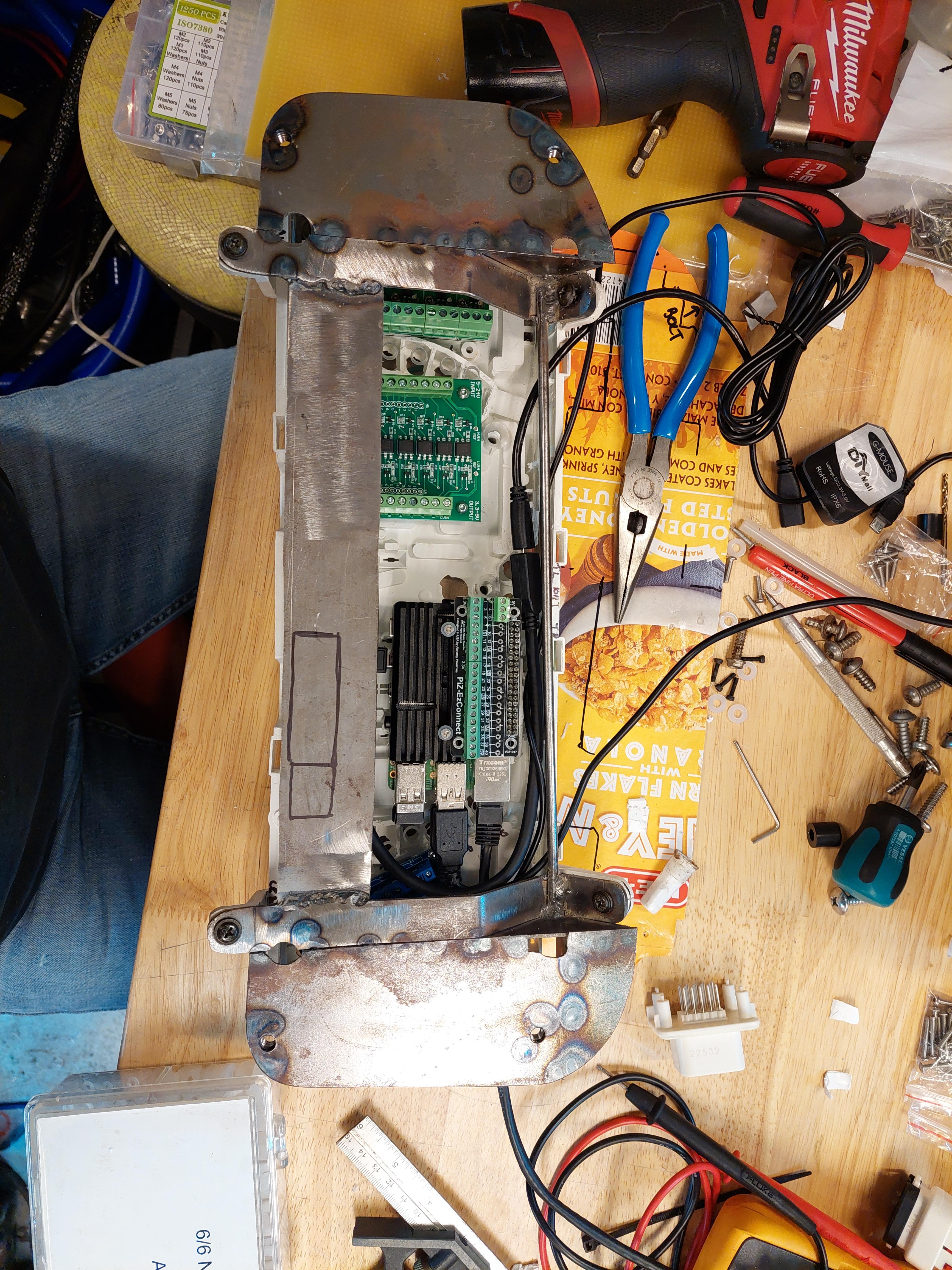

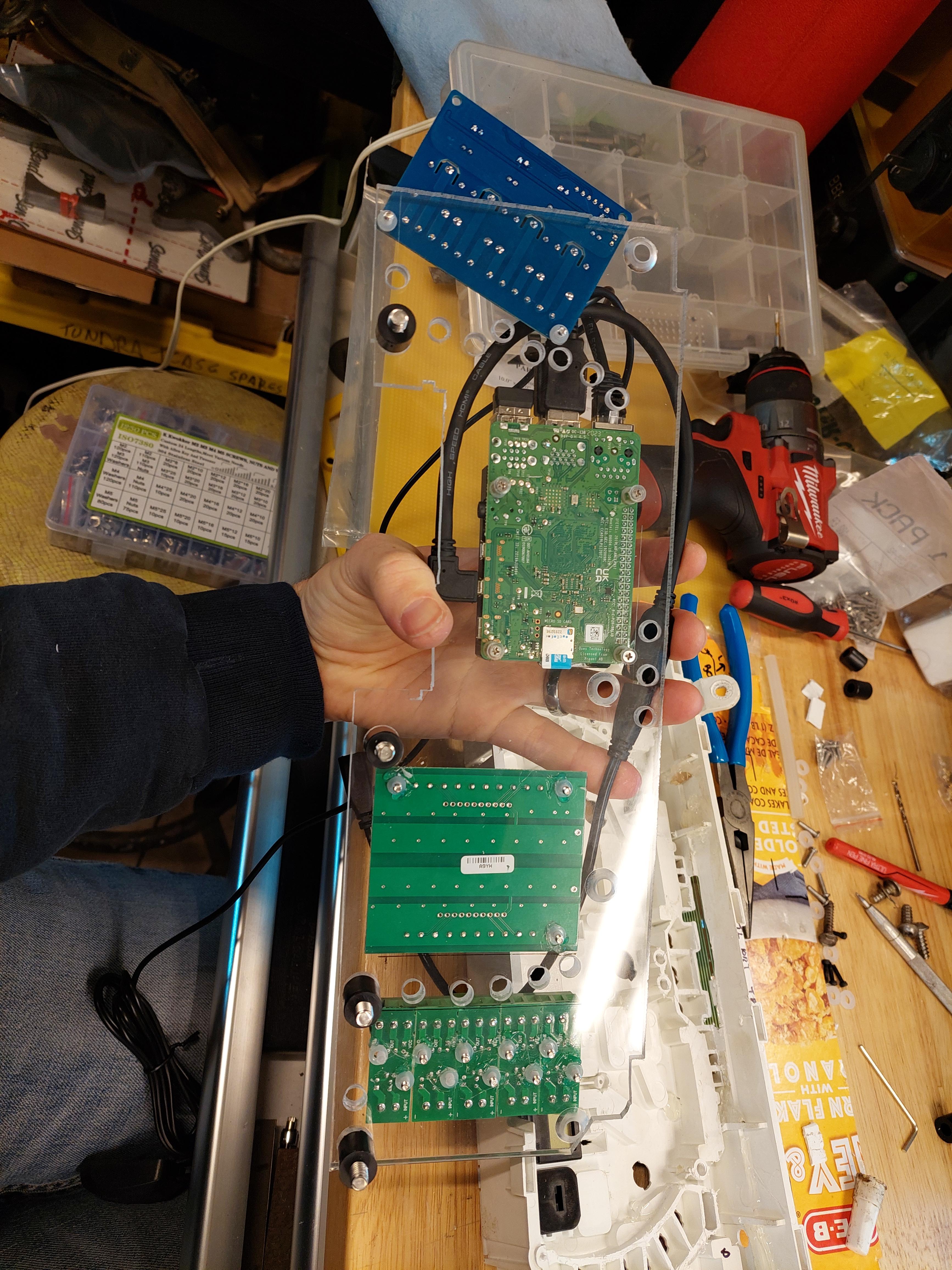

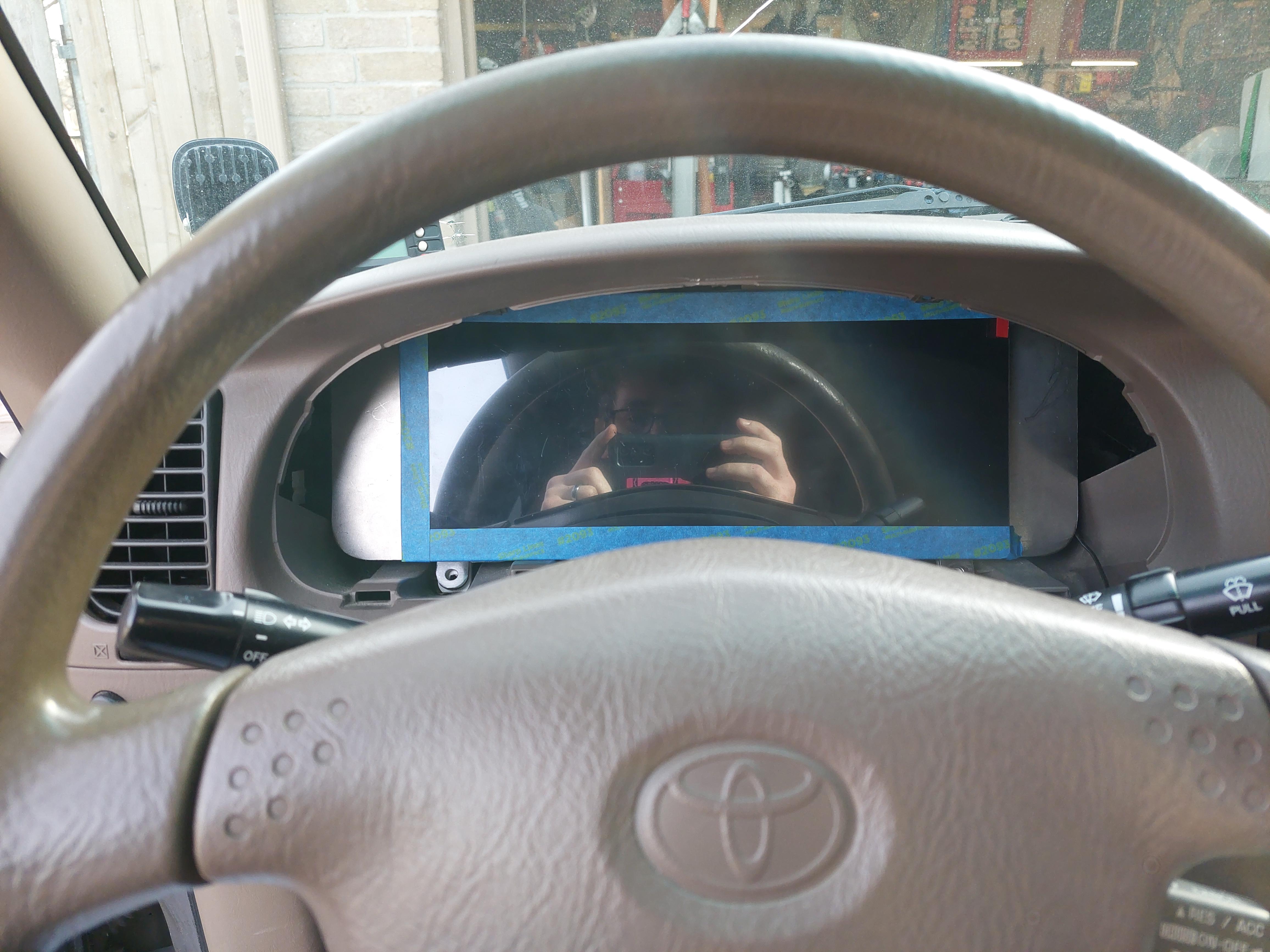

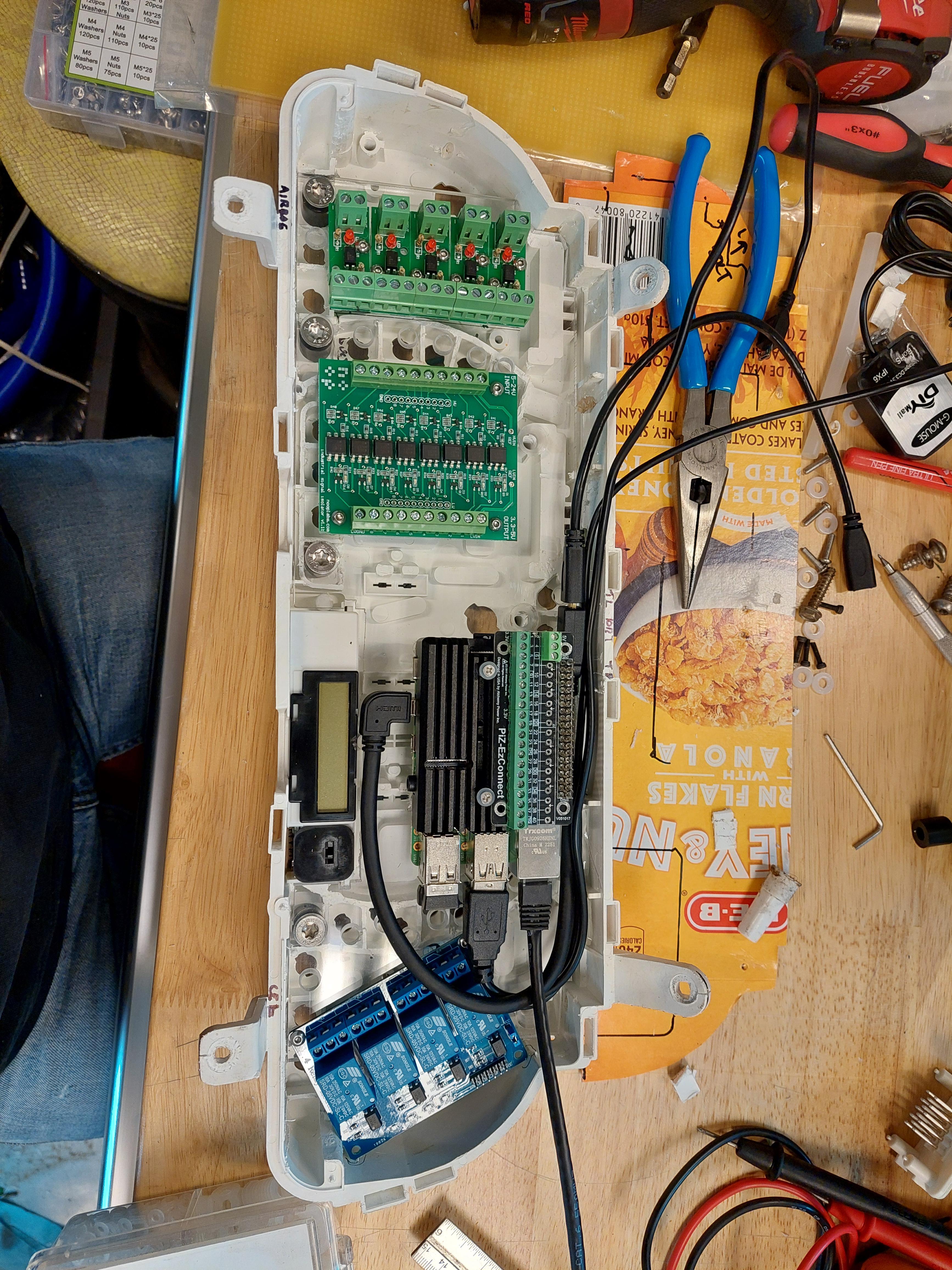

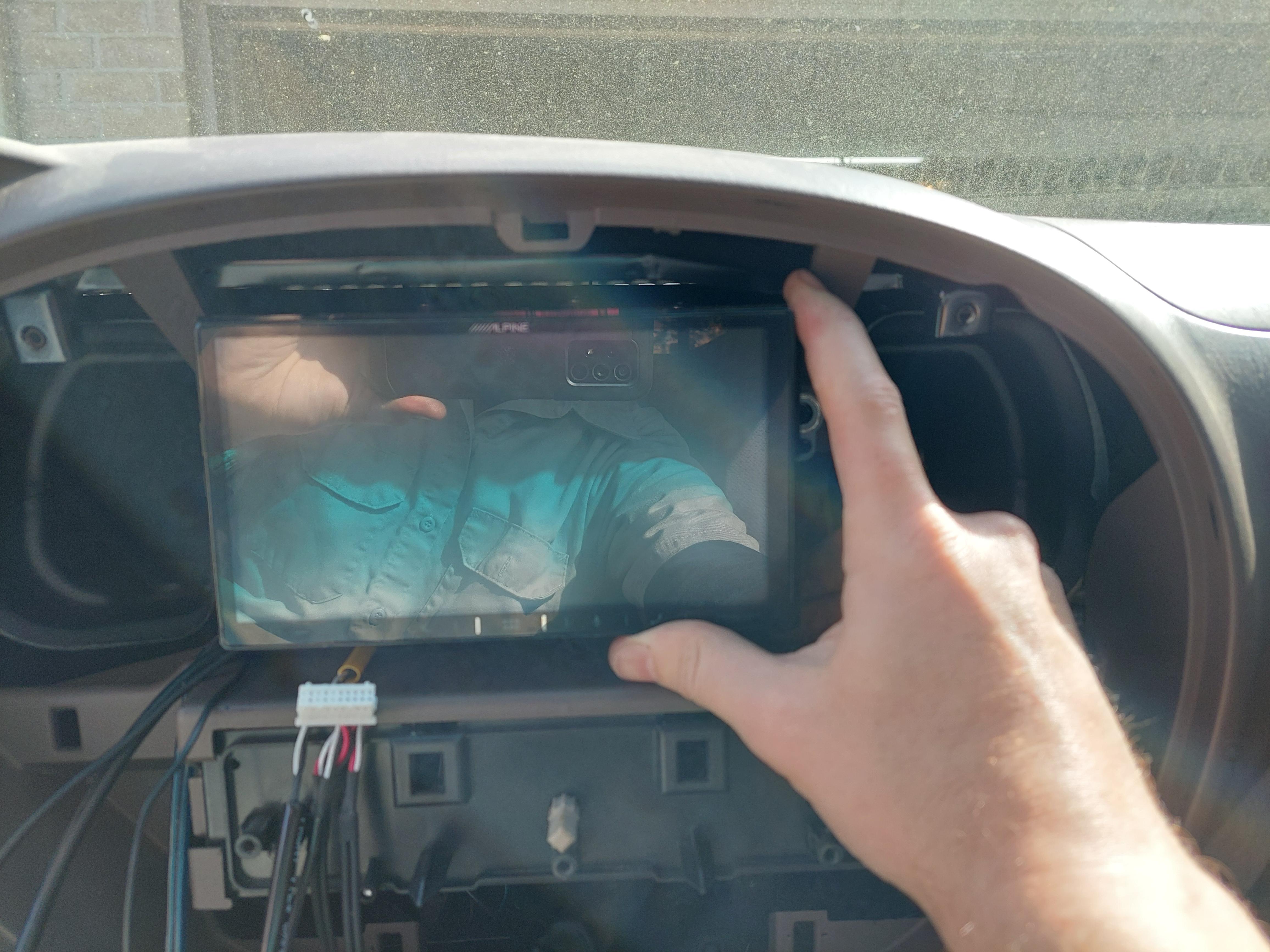

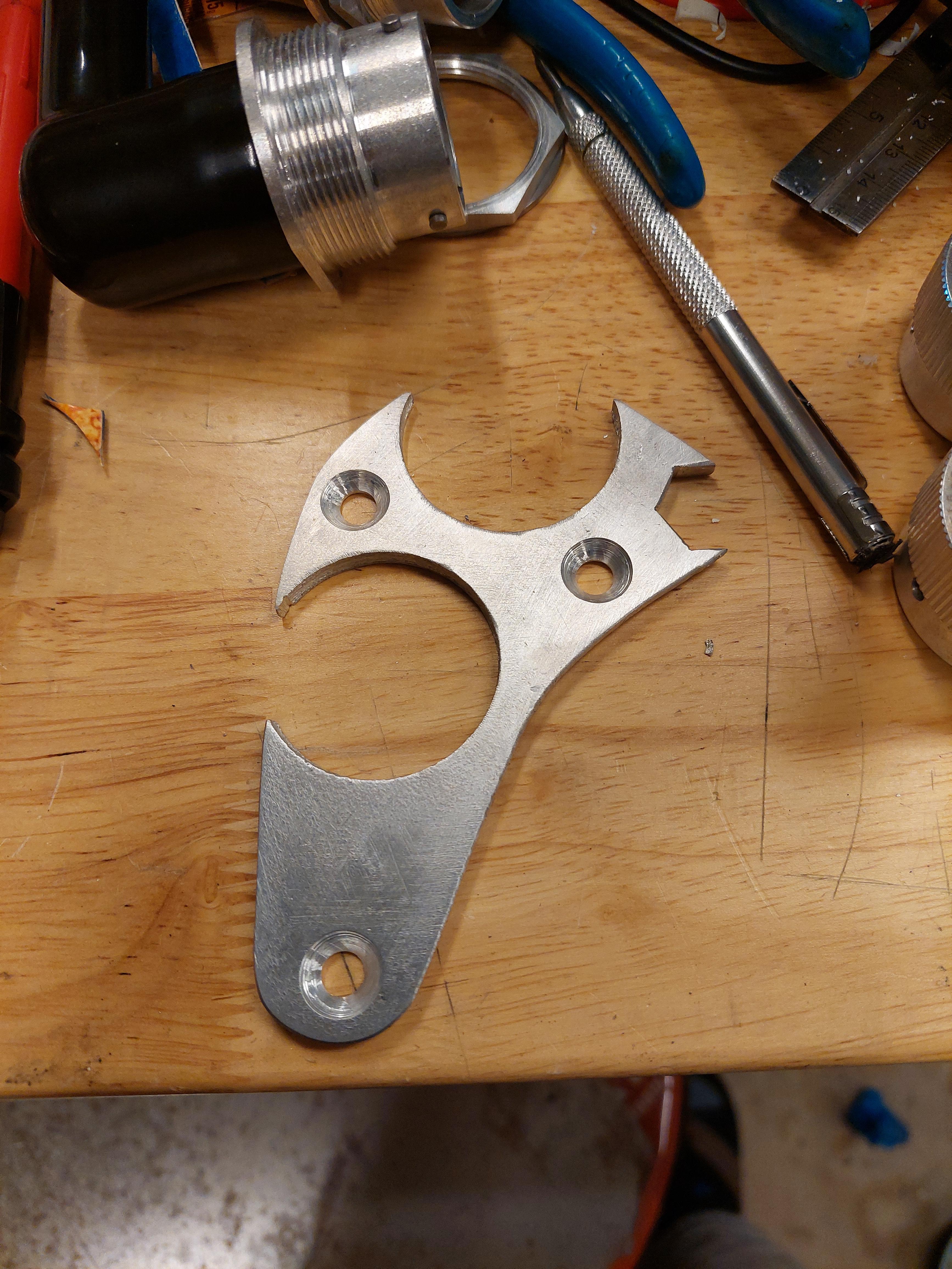

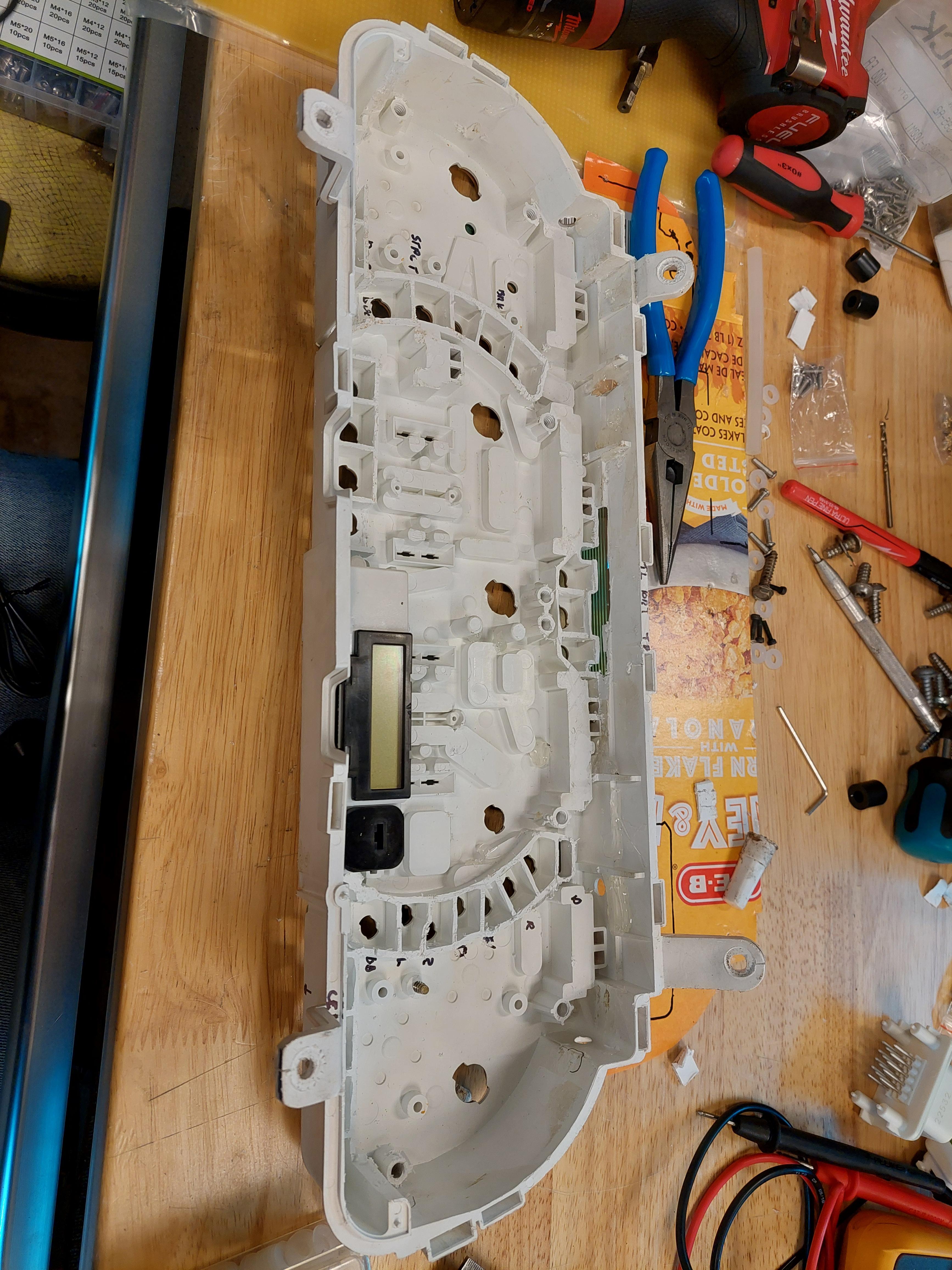

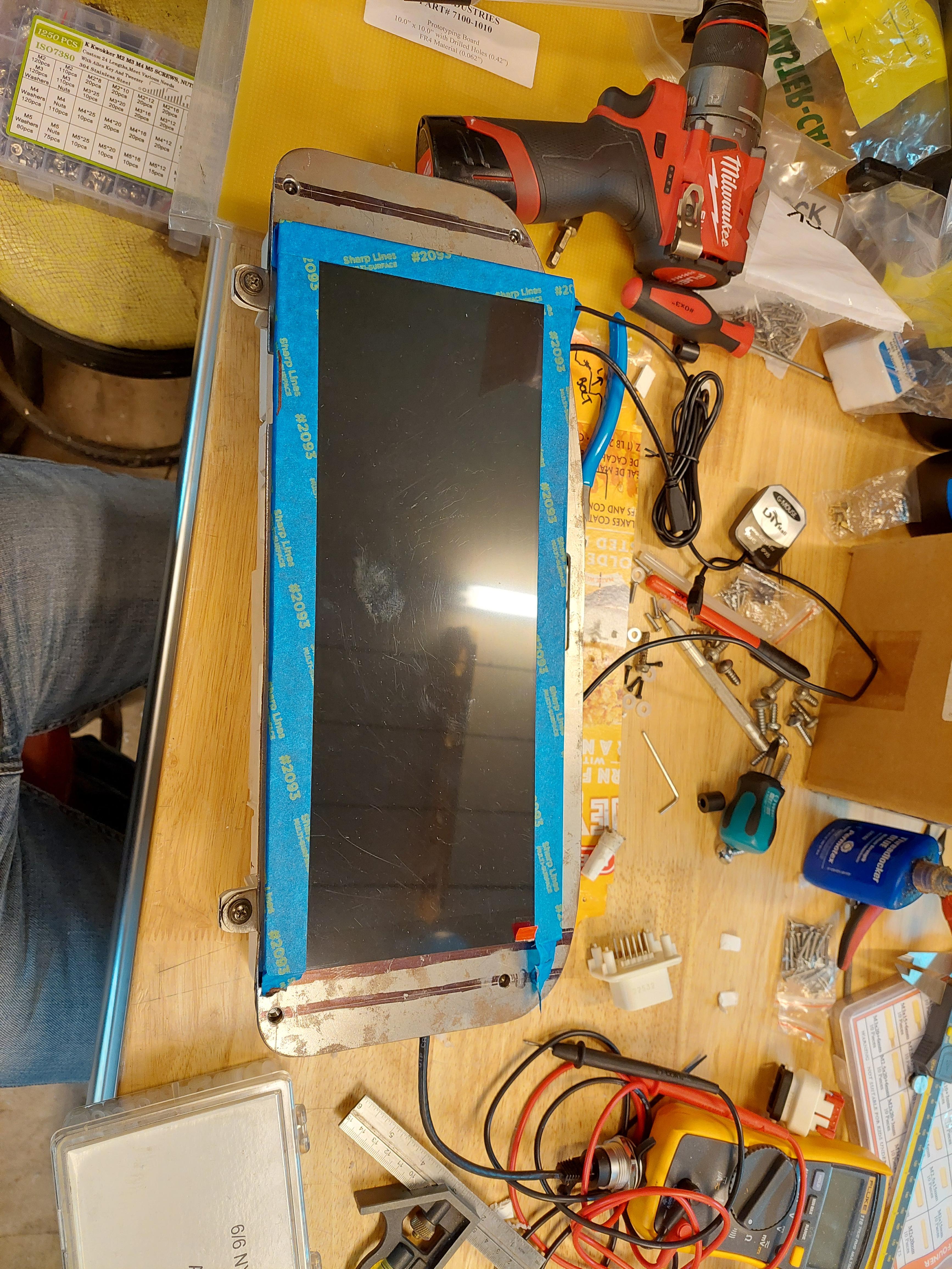

Gauge fab and hardware
8gb rpi 4b+
Waveshare 12.3" display
13 channels of optoisolated level shift to pull factory io from the dash and a 4 channel relay to control extra io
Running ts dash it will pull info straight from the ms3 and let me tune if I want. Im working on the gauge display now but its not ready yet.

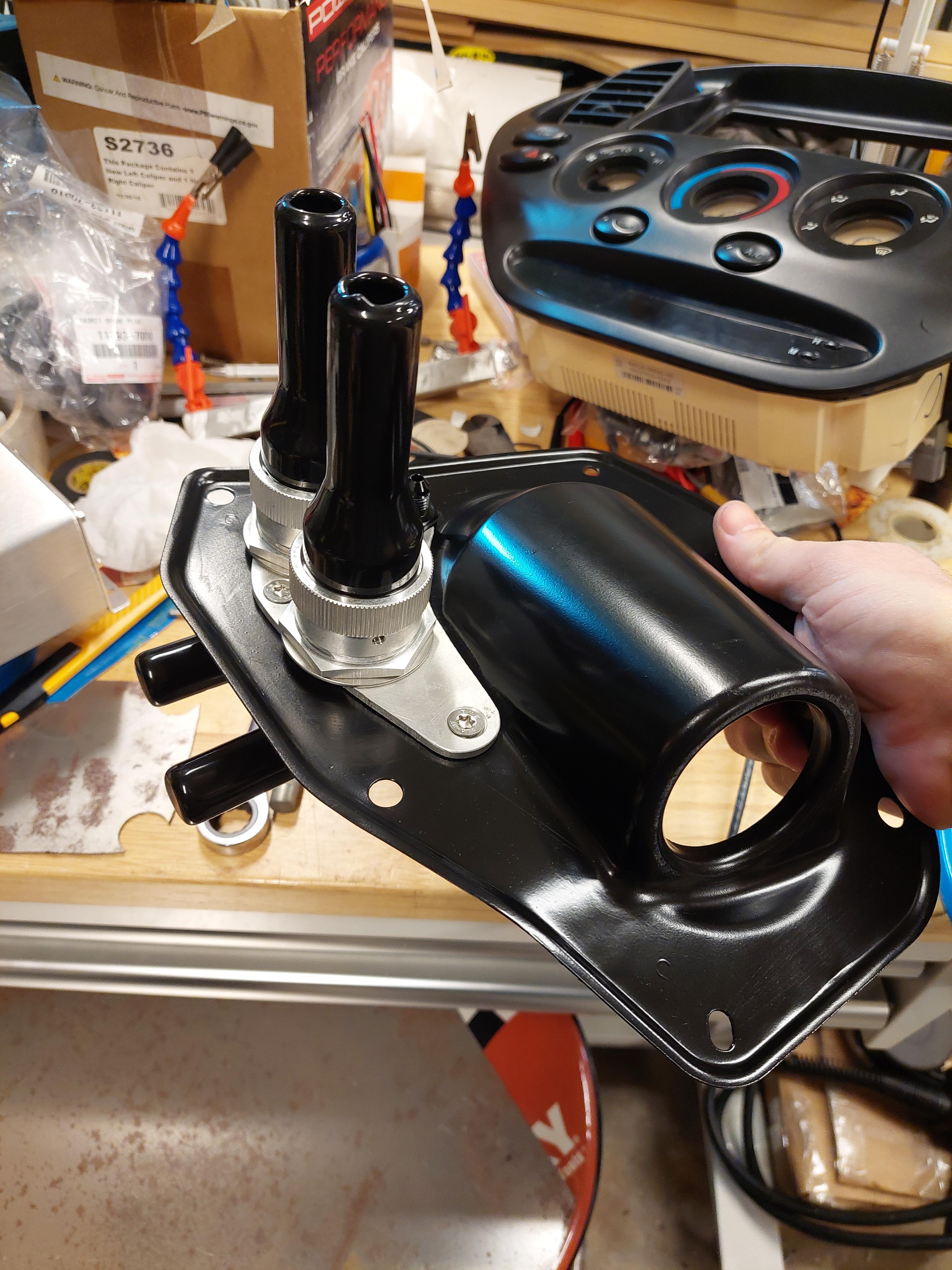

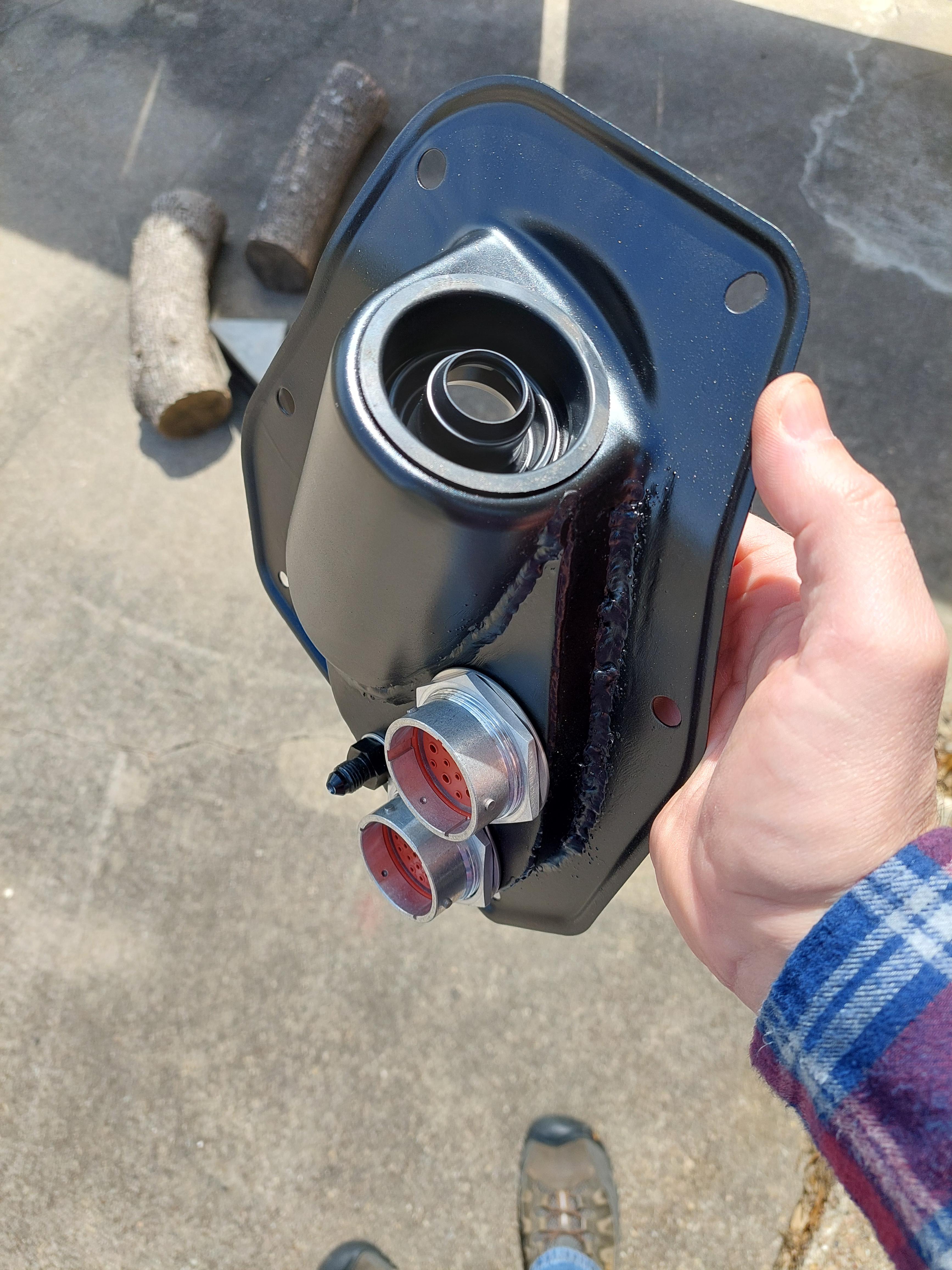

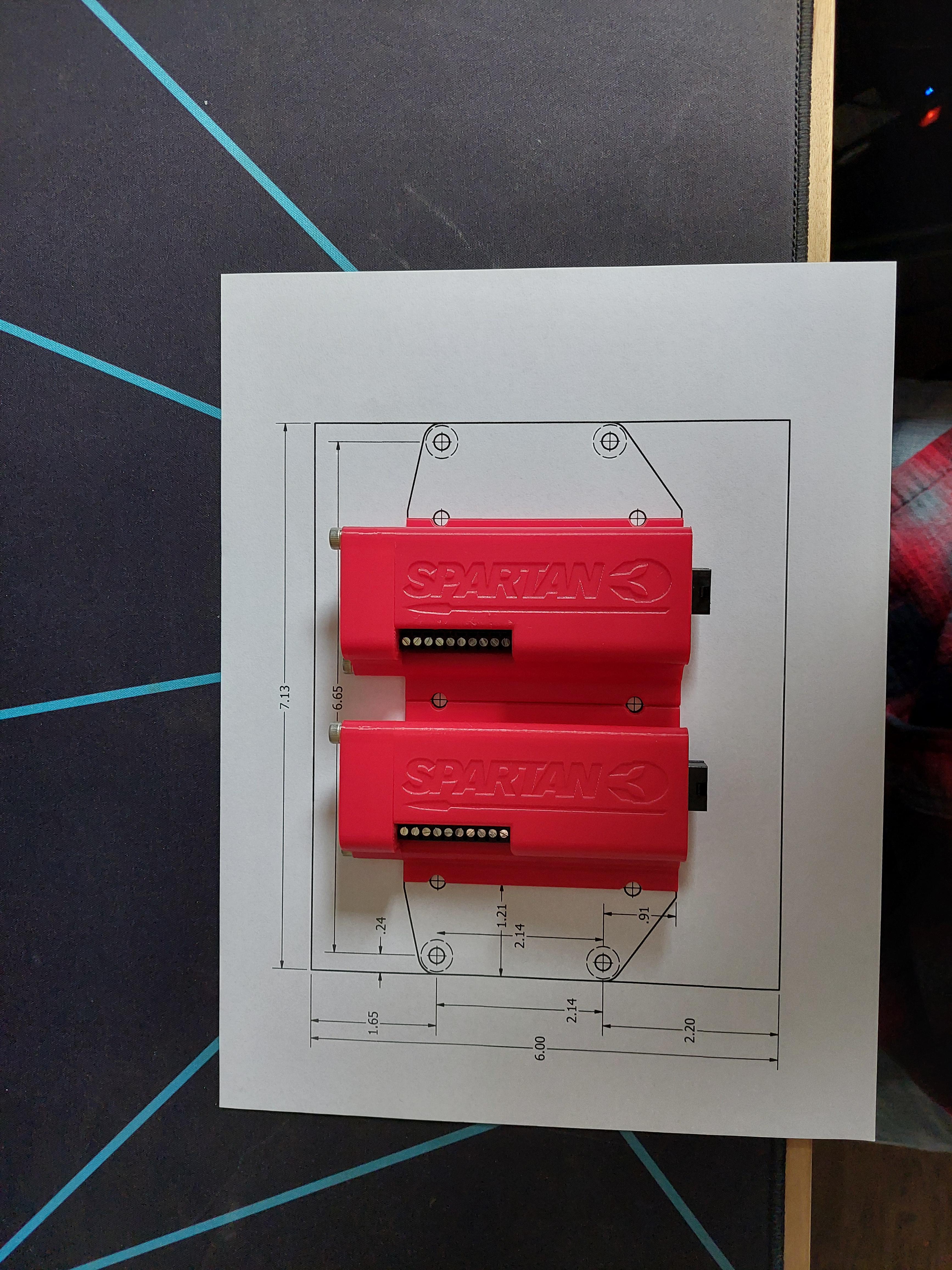

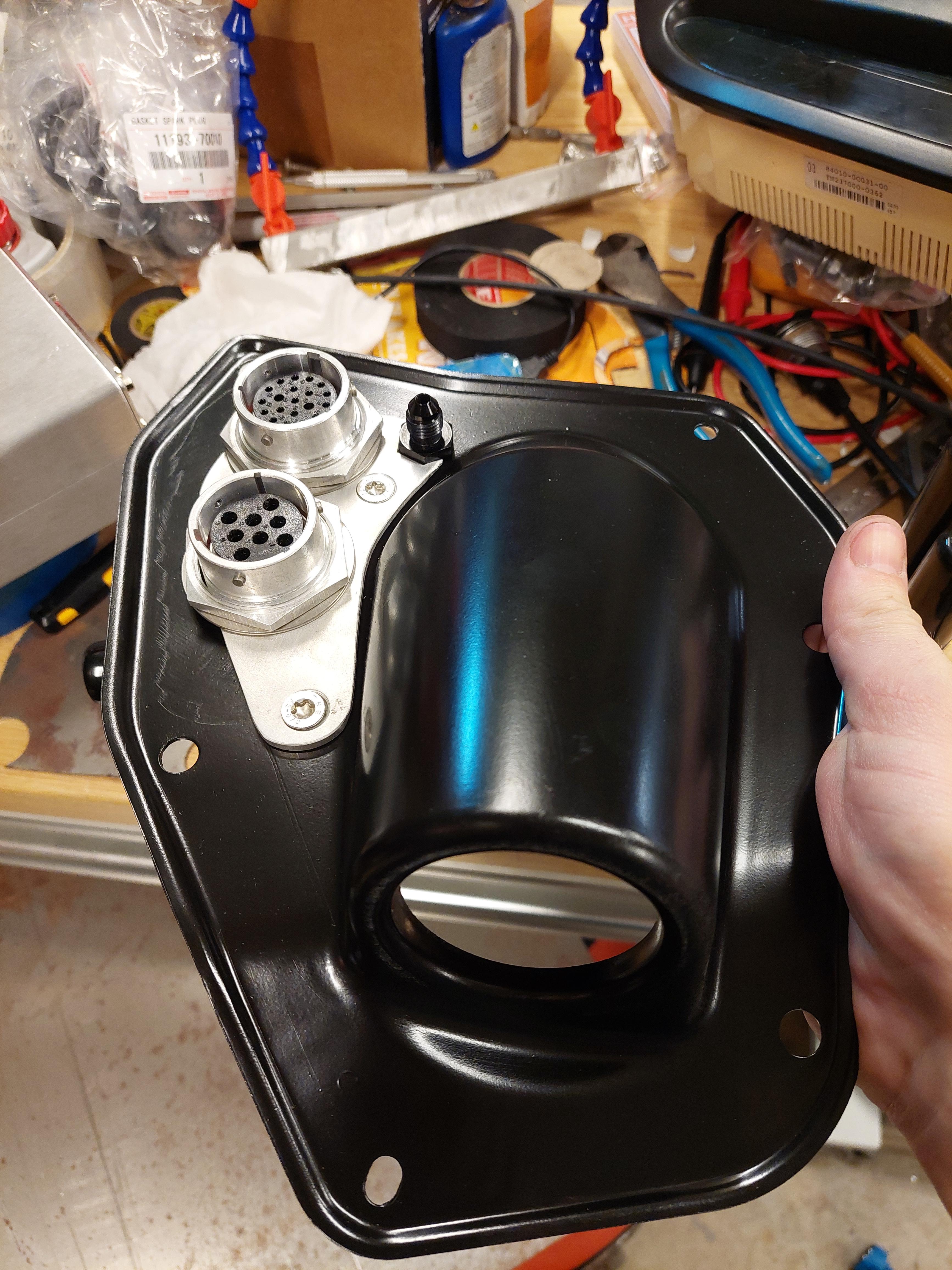

Bulkhead mount to connect my hd30 connectors for power/sensors.
Sean

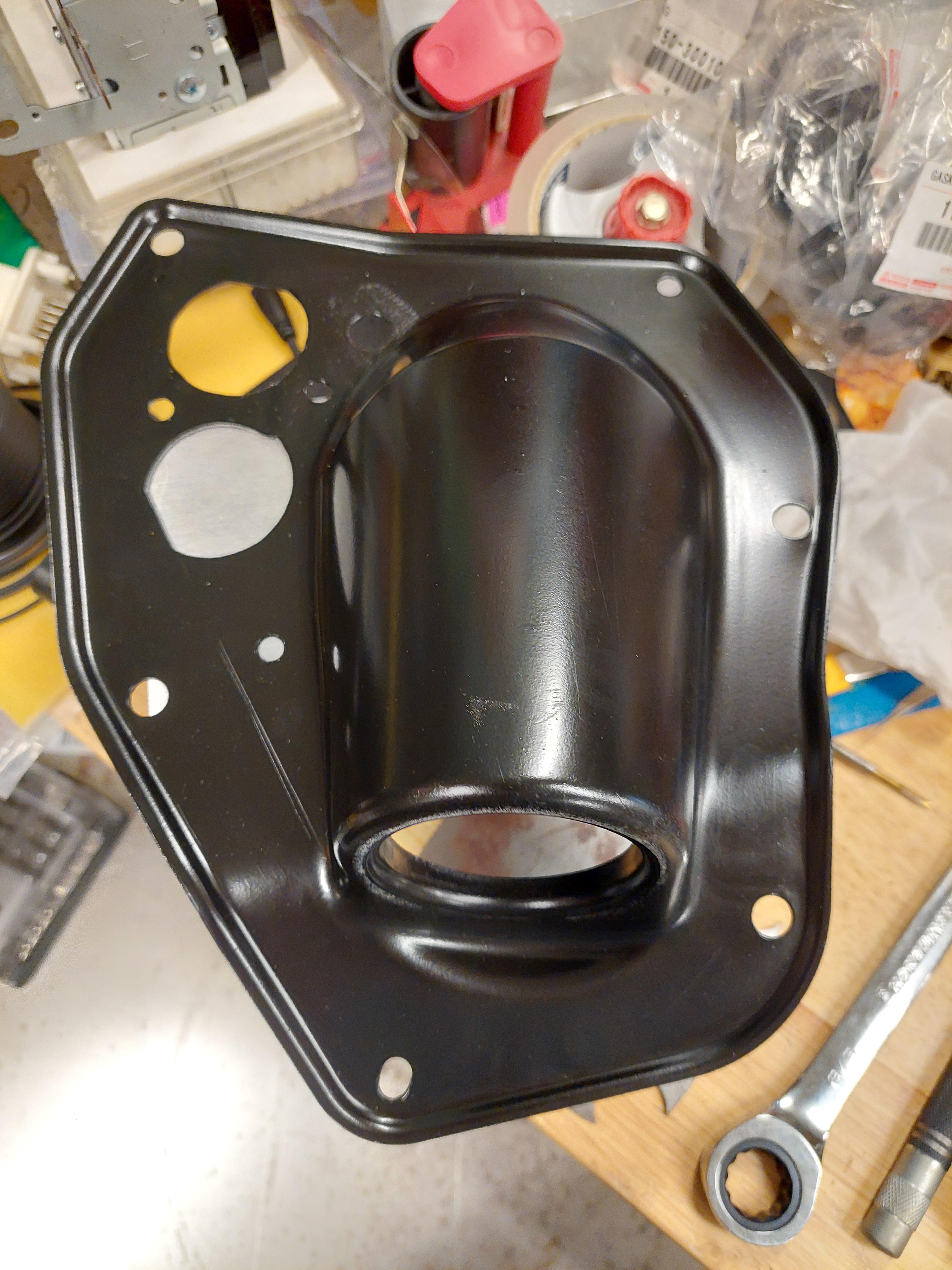

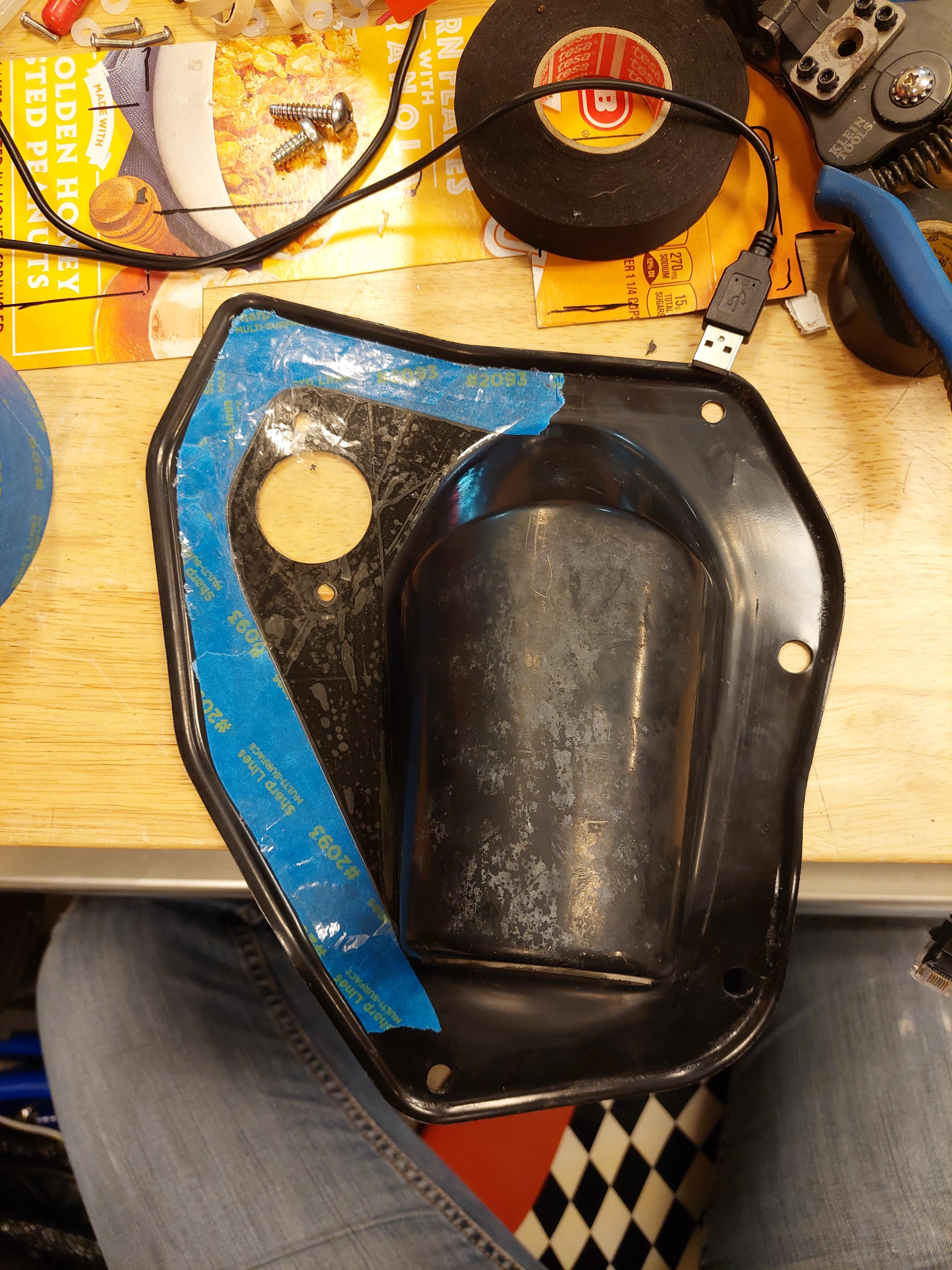

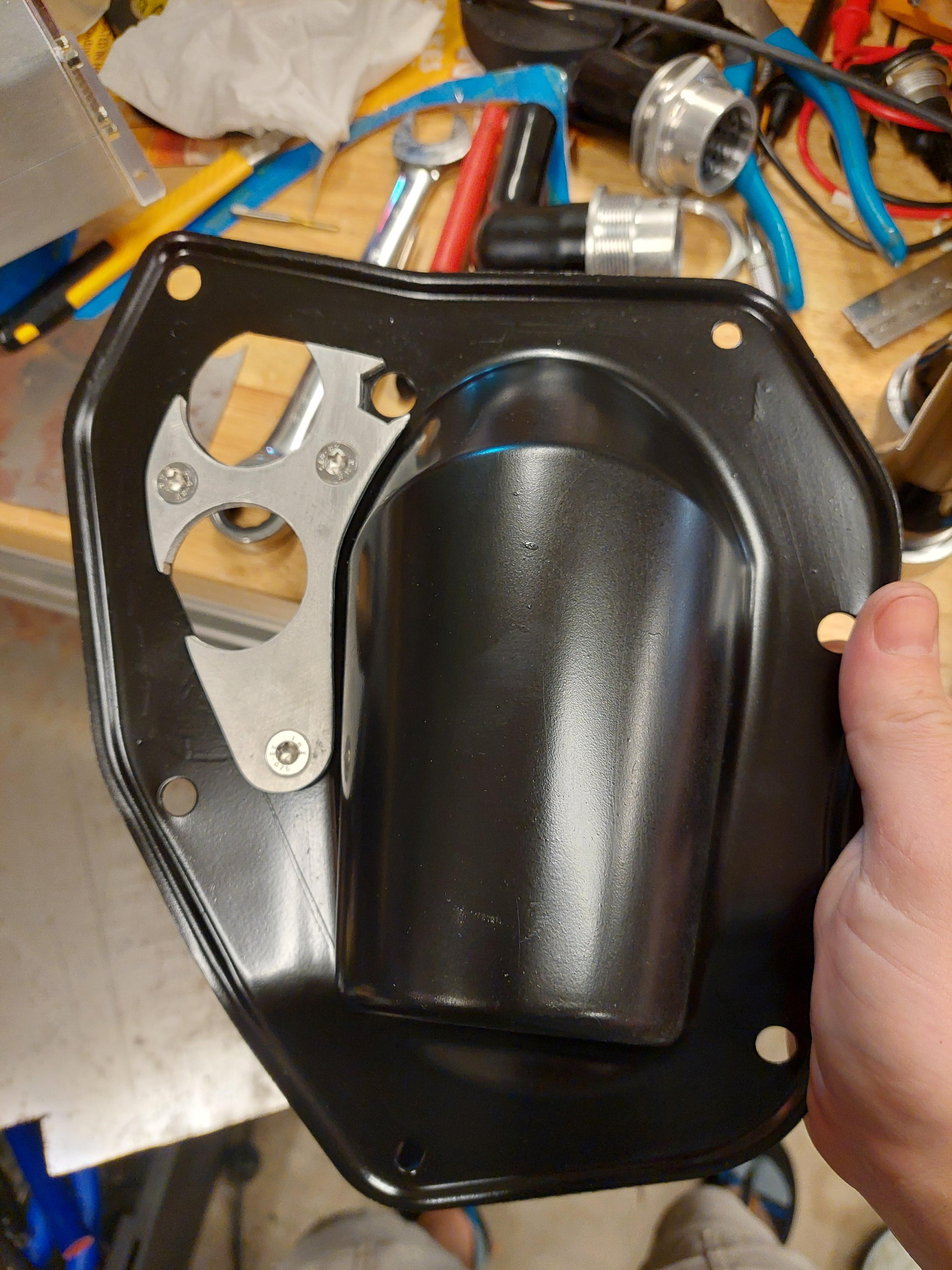

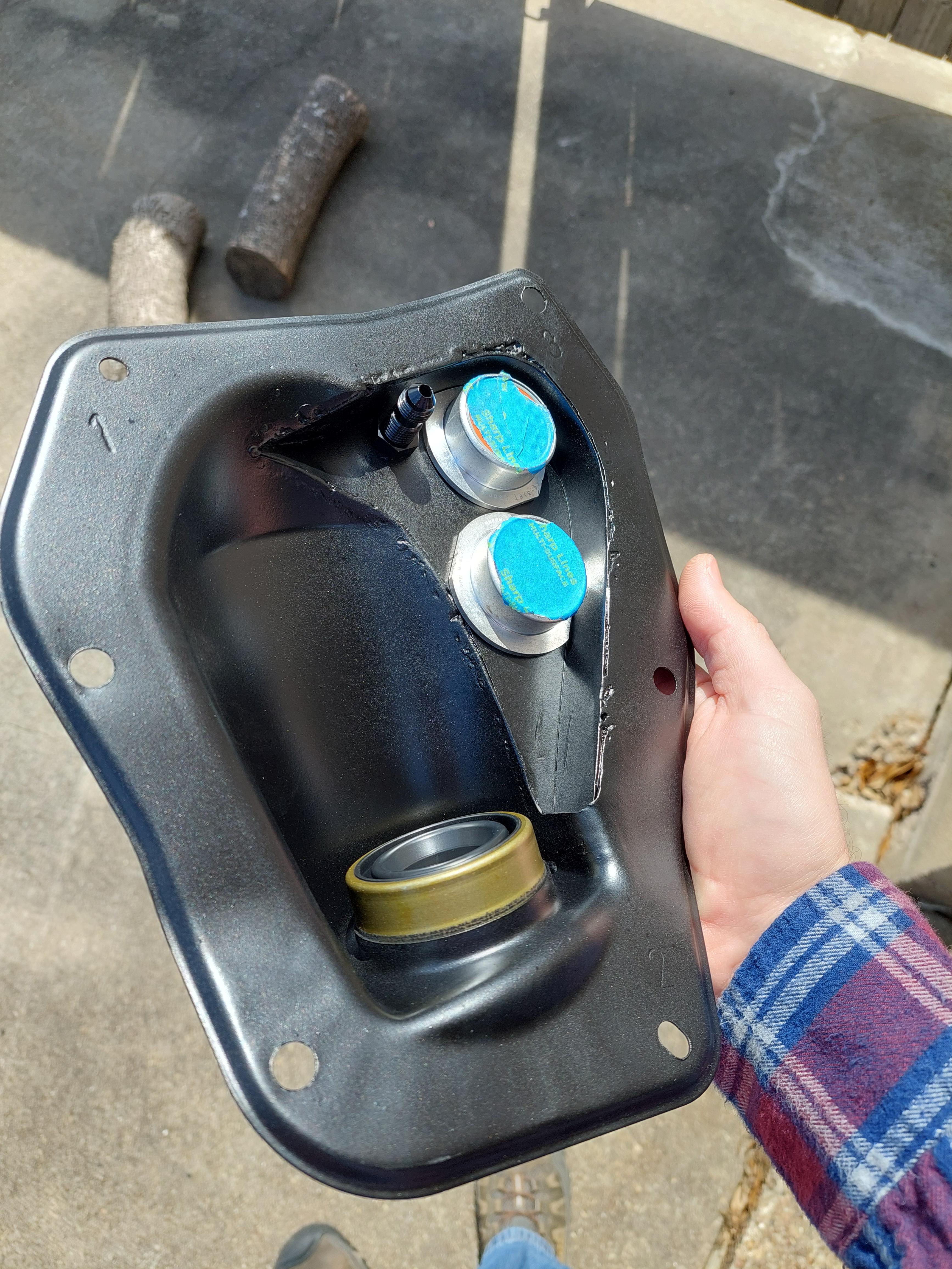

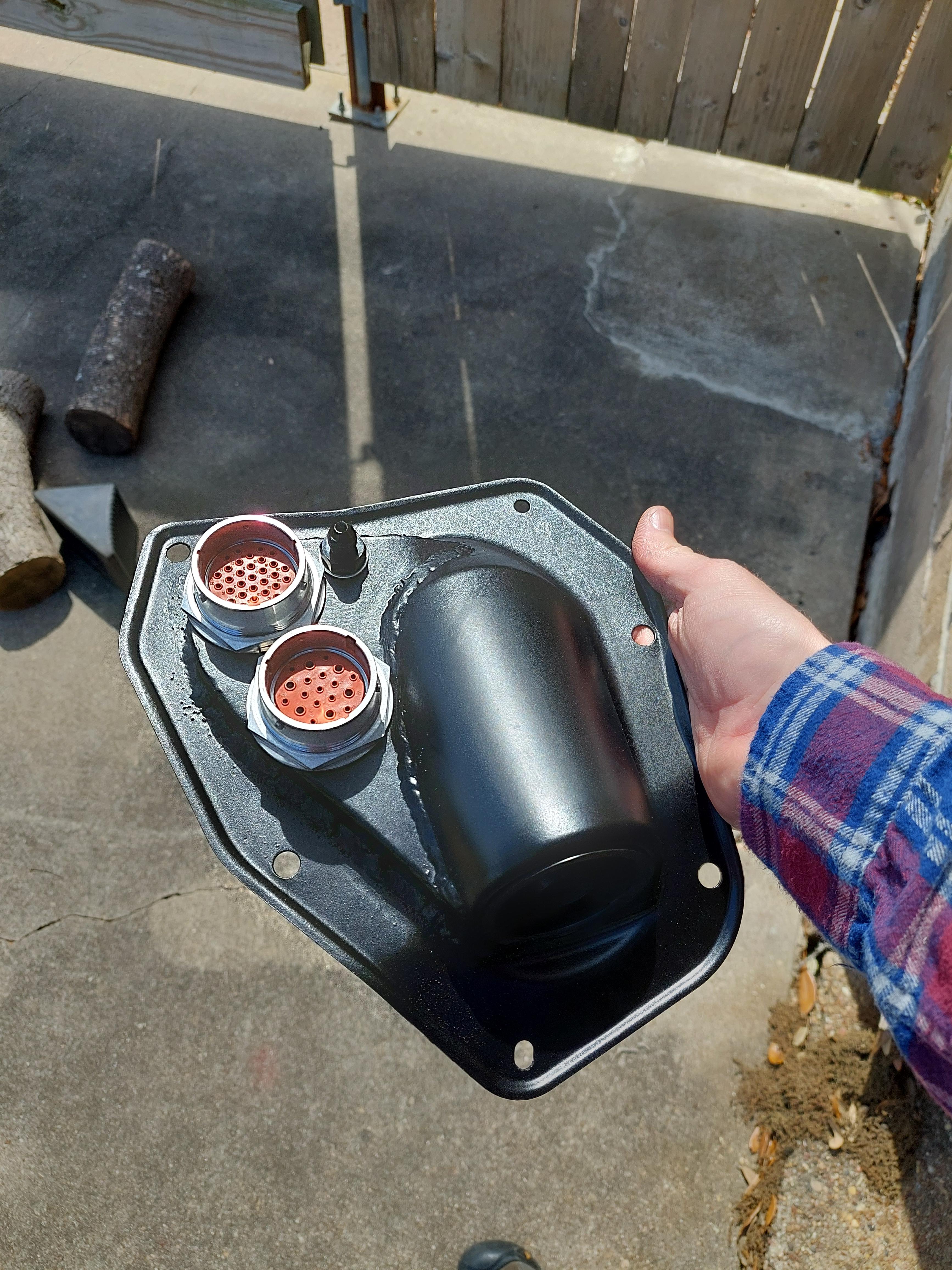

Redoing work because I can't count pins correctly, FUN.
I had used the 18 series hd30 connectors because I thought I had enough contacts but my list was incomplete. So for my hubris, I had to cut a big chunk out and poorly weld in a band, and plate, then replace the connectors with the 24 series hd30 connectors. Its ugly but no one will see it once installed. I'll own up to my shame here though.

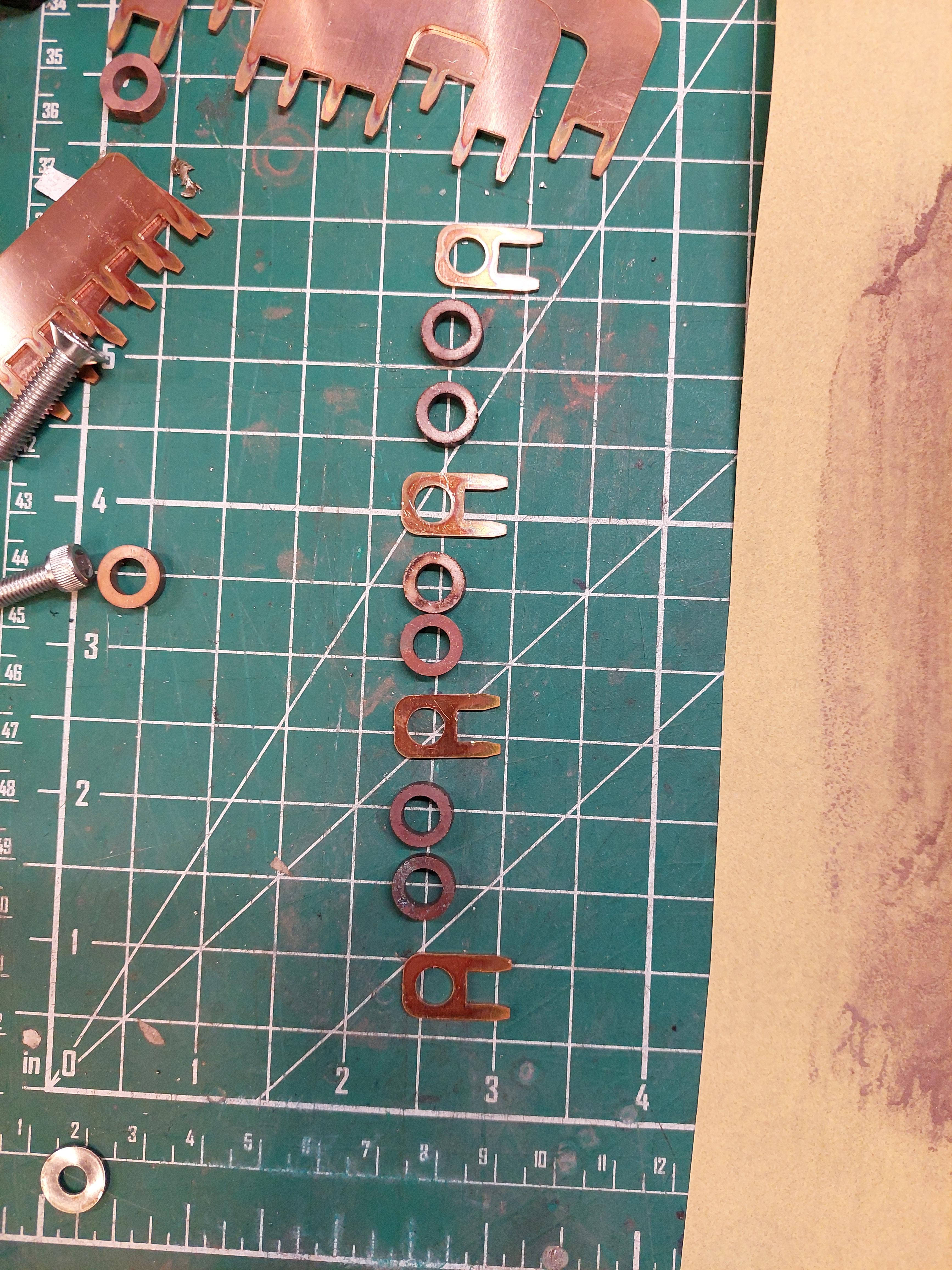

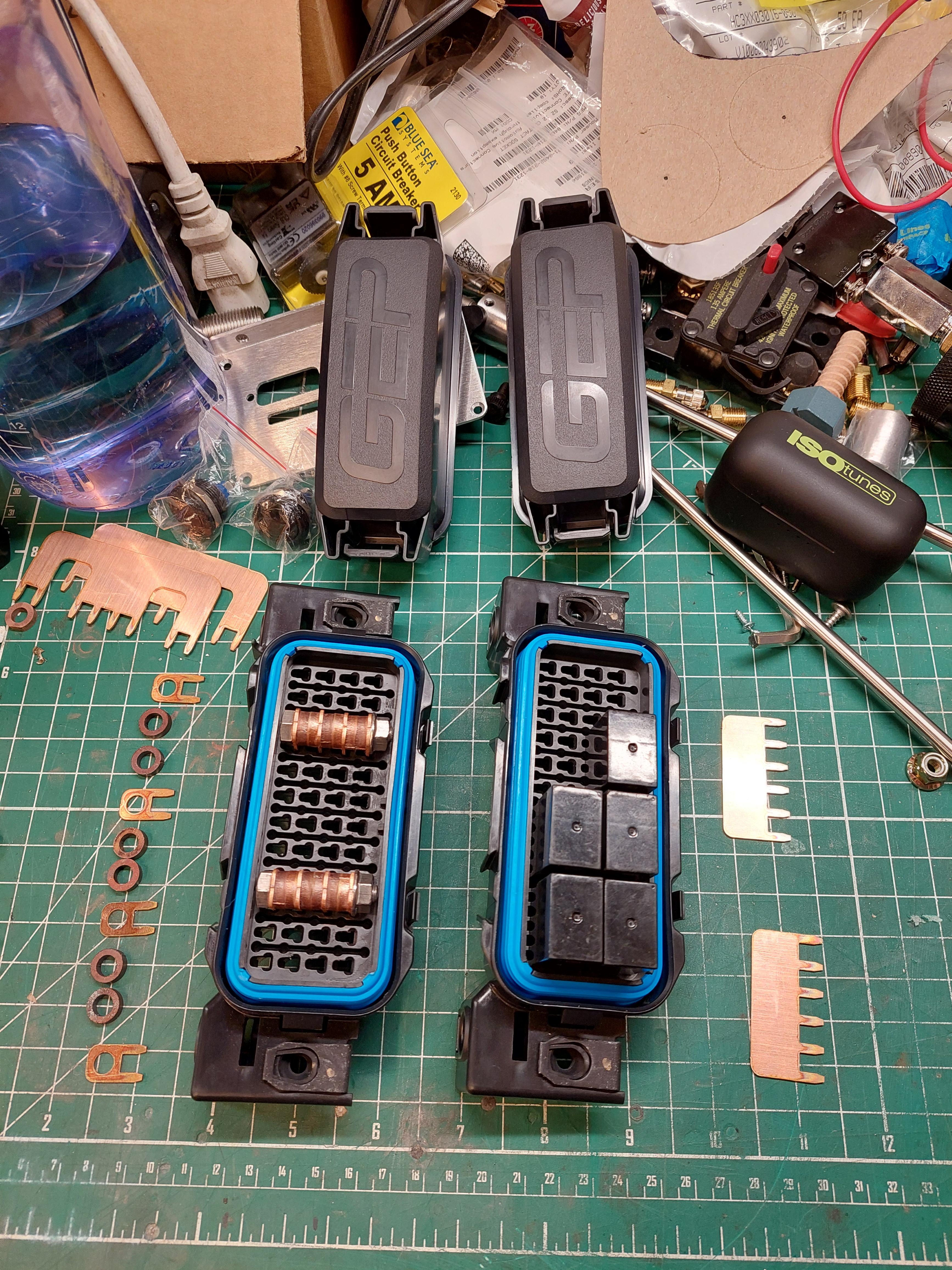

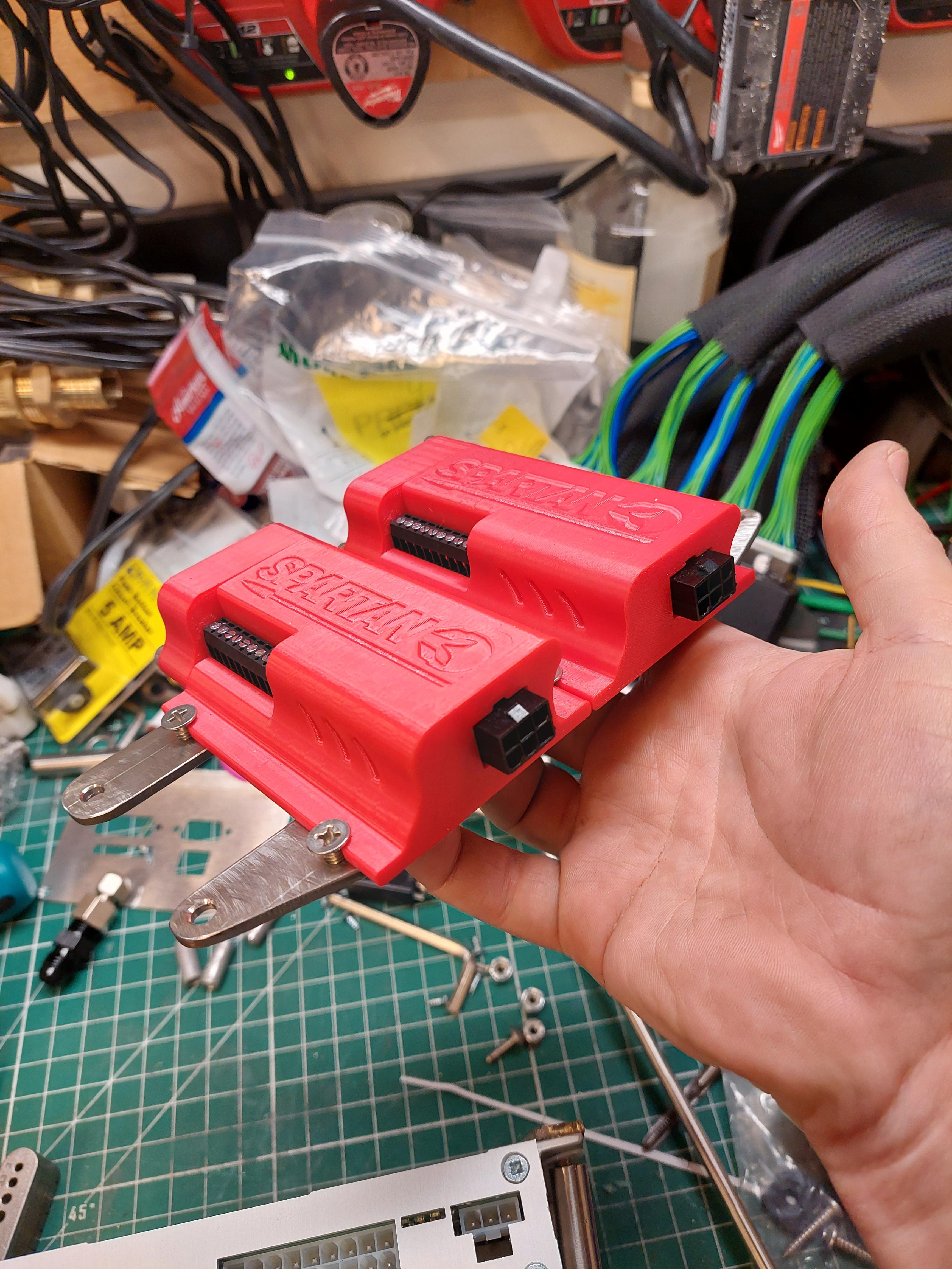

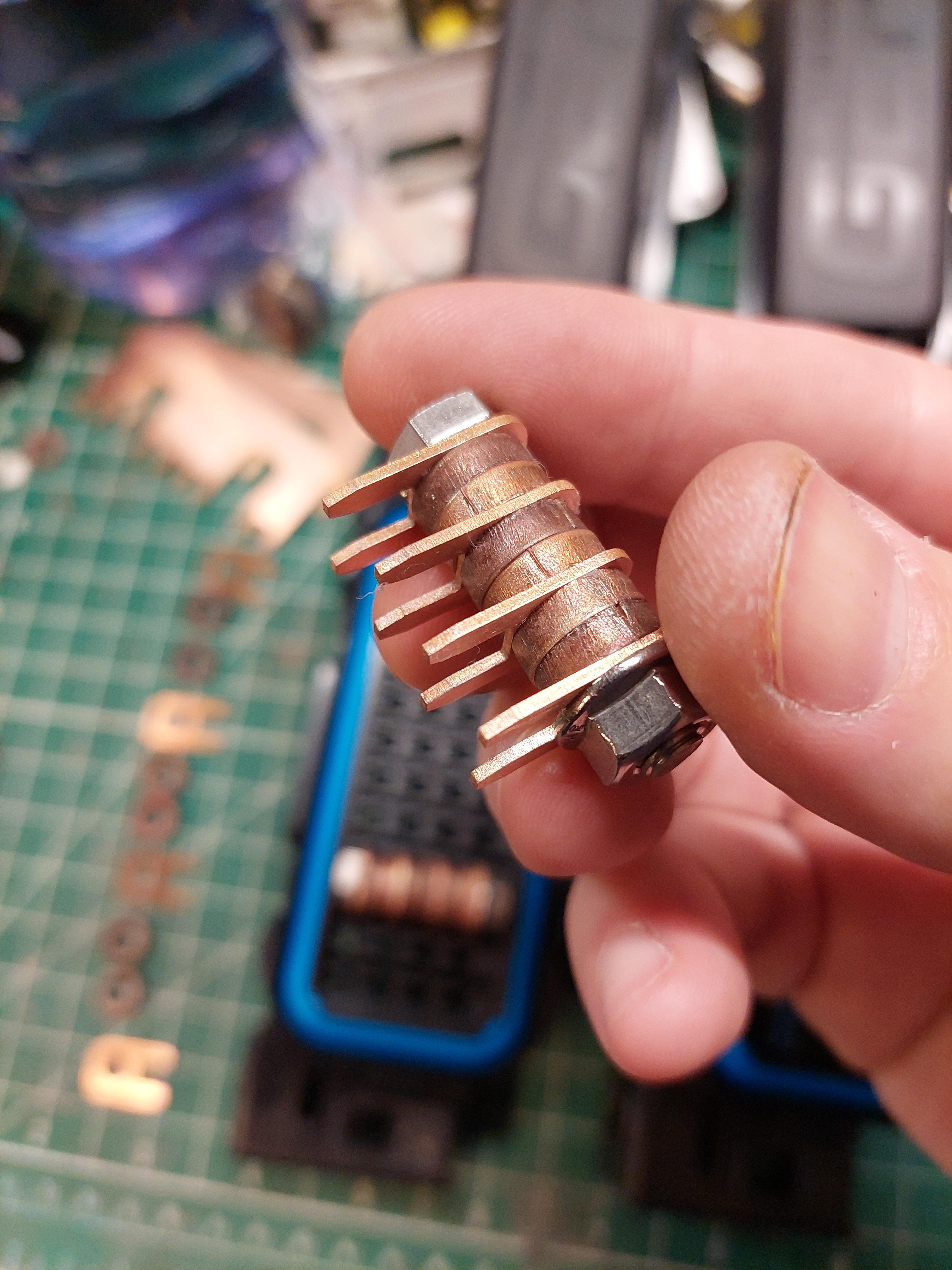

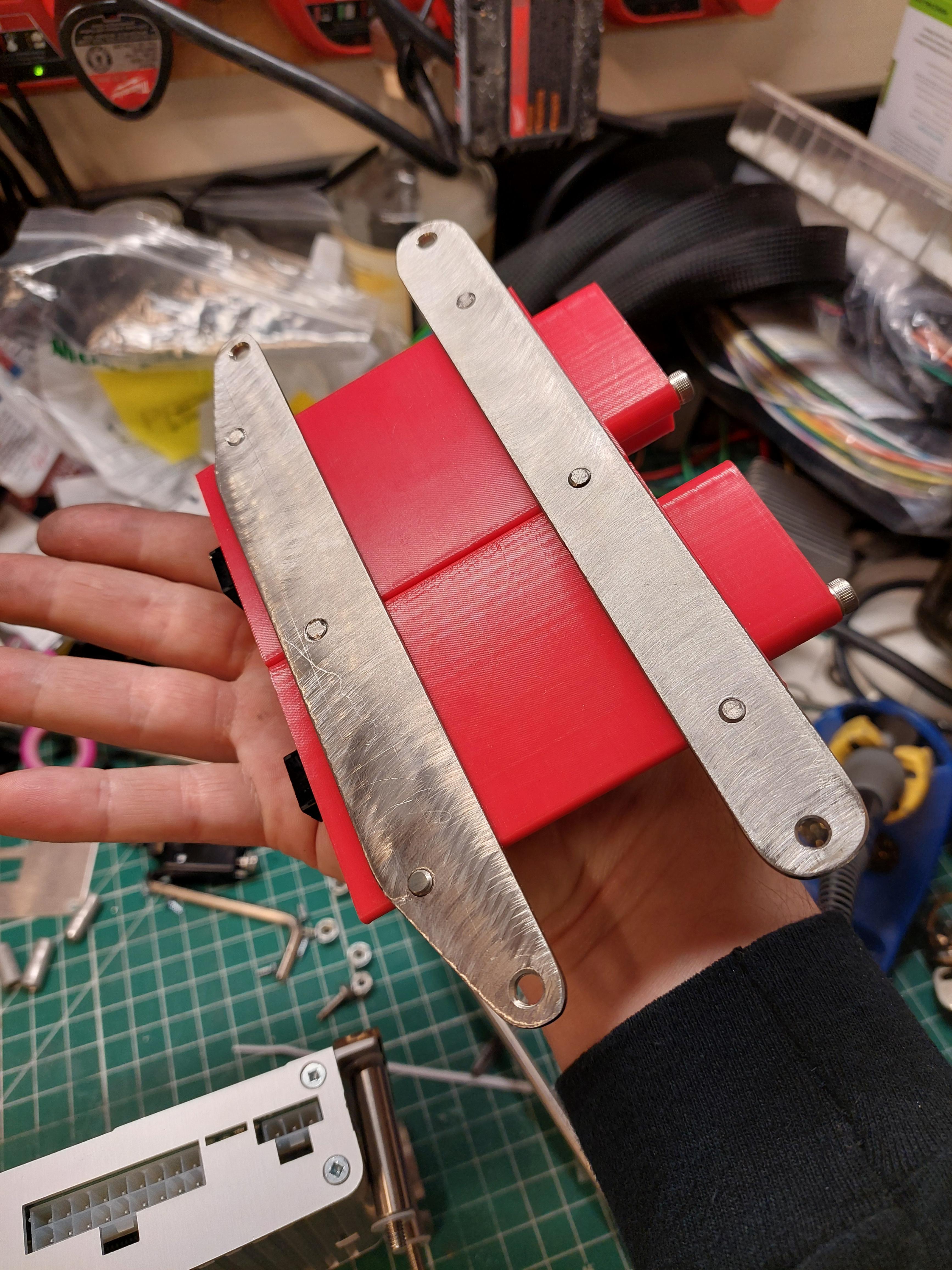

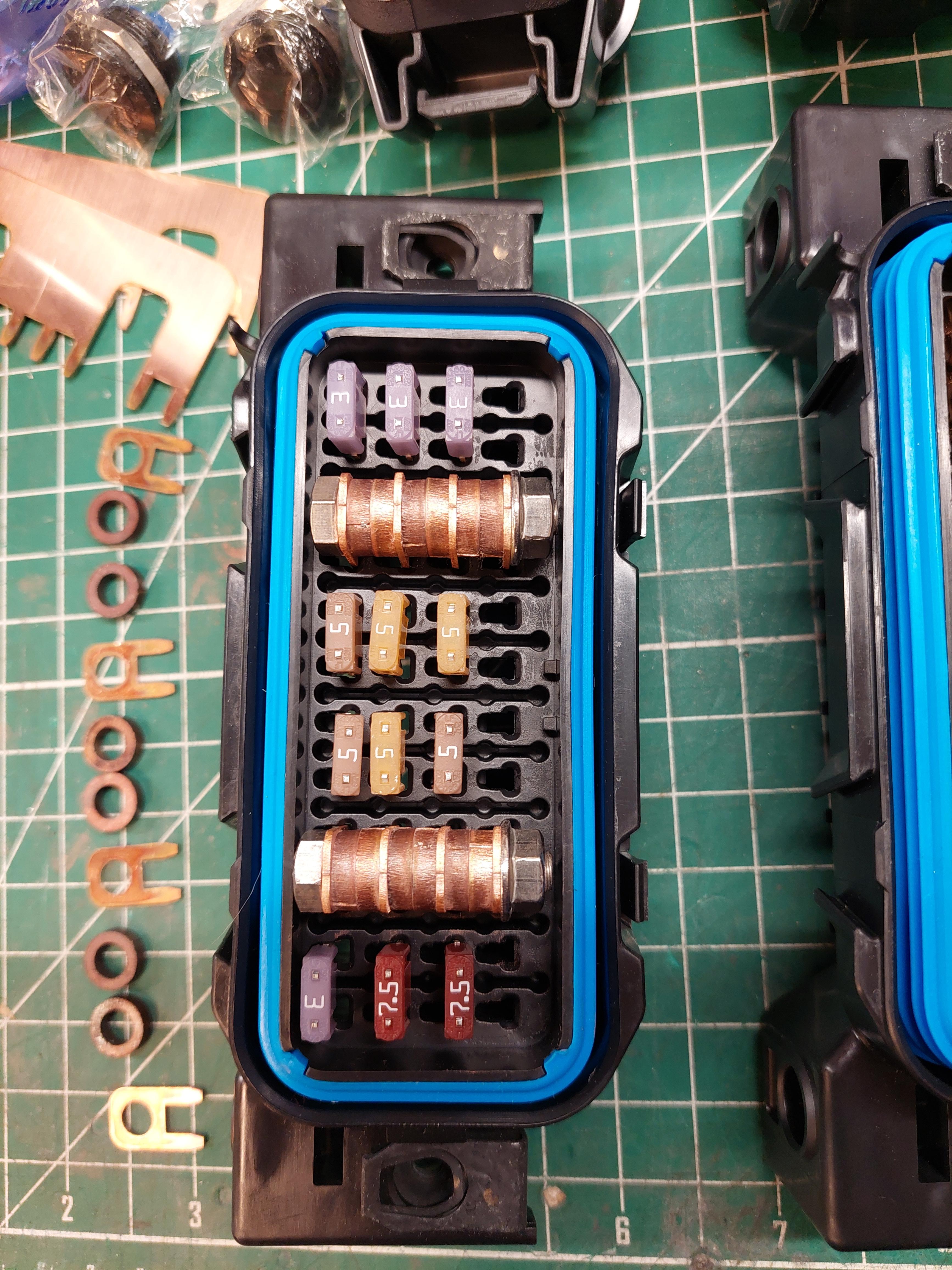

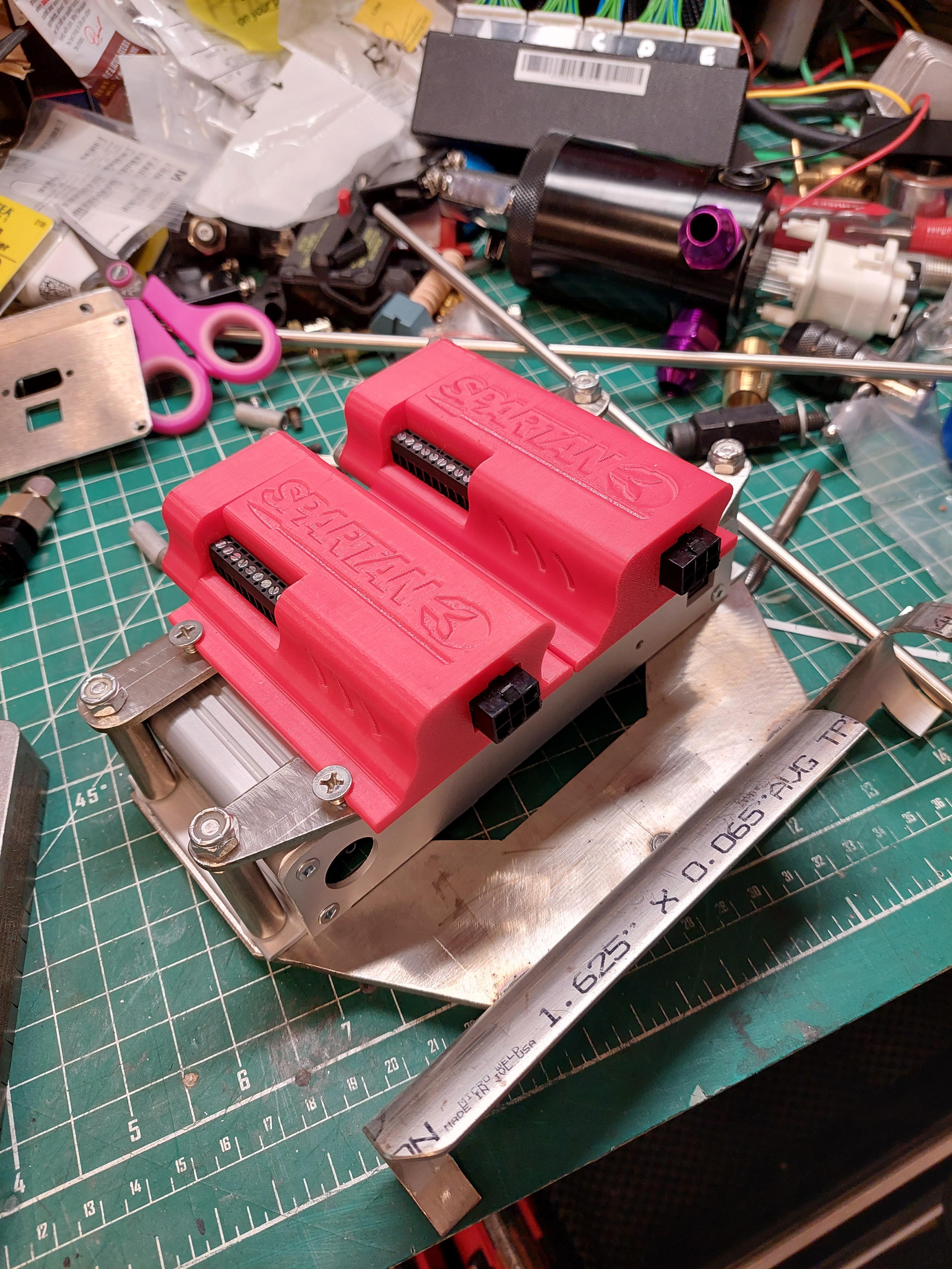

Moving on, I had some bussed contacts cut from 0.040 copper so I can avoid splices on the power feeds to the internal fuse box. I have one power from each relay coming to the main buss bars, then jumpers to one side of the fuse, then wires out to the devices.
I messed up the spacing on negative bus bar for the interior fuse box and now I have to reorder it.

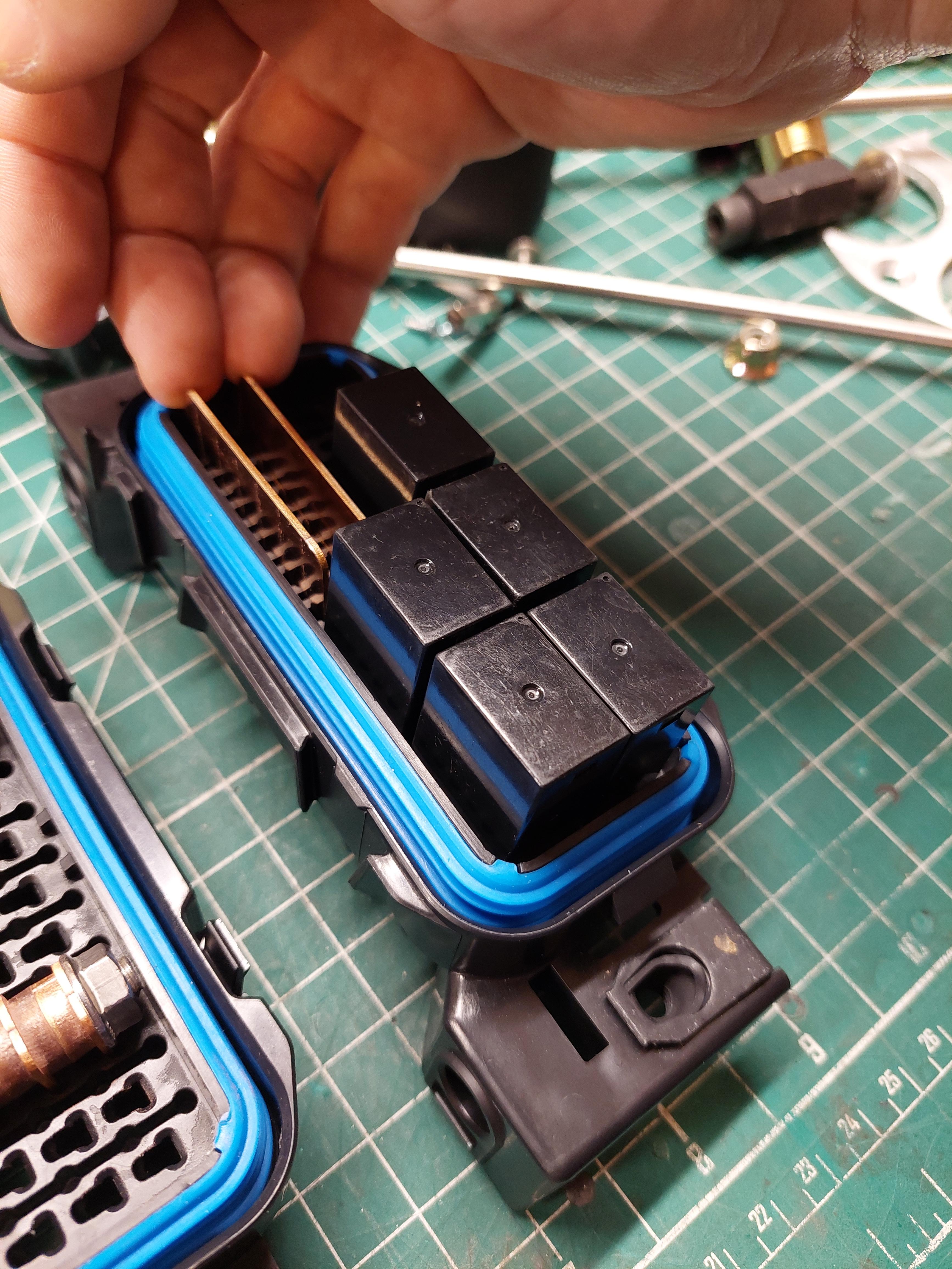

These little gep relay/fuse boxes are nice and compact and reasonably cheap. The relay one will go under the hood next to the battery and has a positive and negative bus bar for the relay triggers so it can work with high side or ground switching on each relay depending on source.
All these will get coated with conformal coating or similar on the non-contact surfaces so if they ever bounce around in the case, they don't immediately set my s*** on fire.
