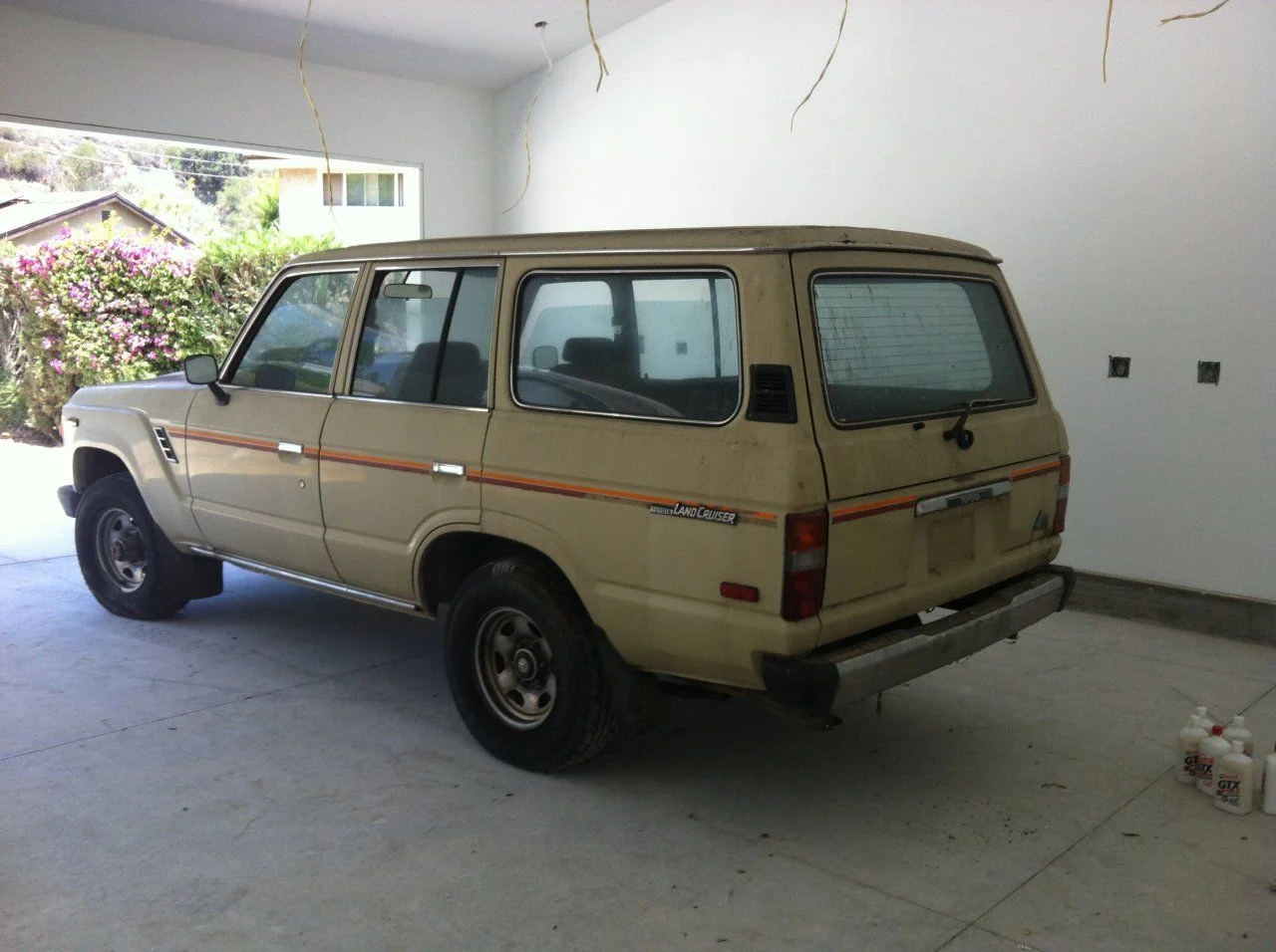

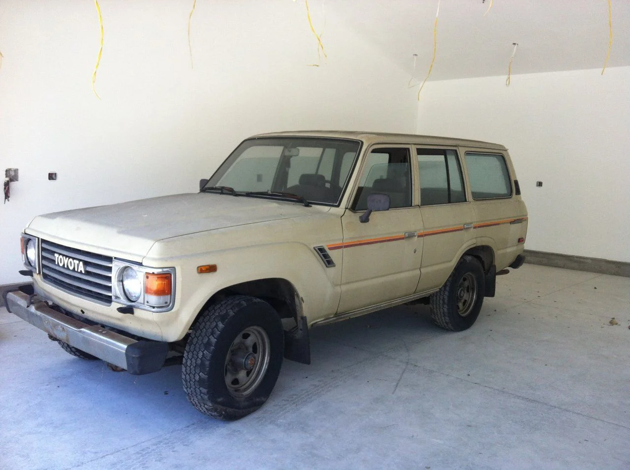

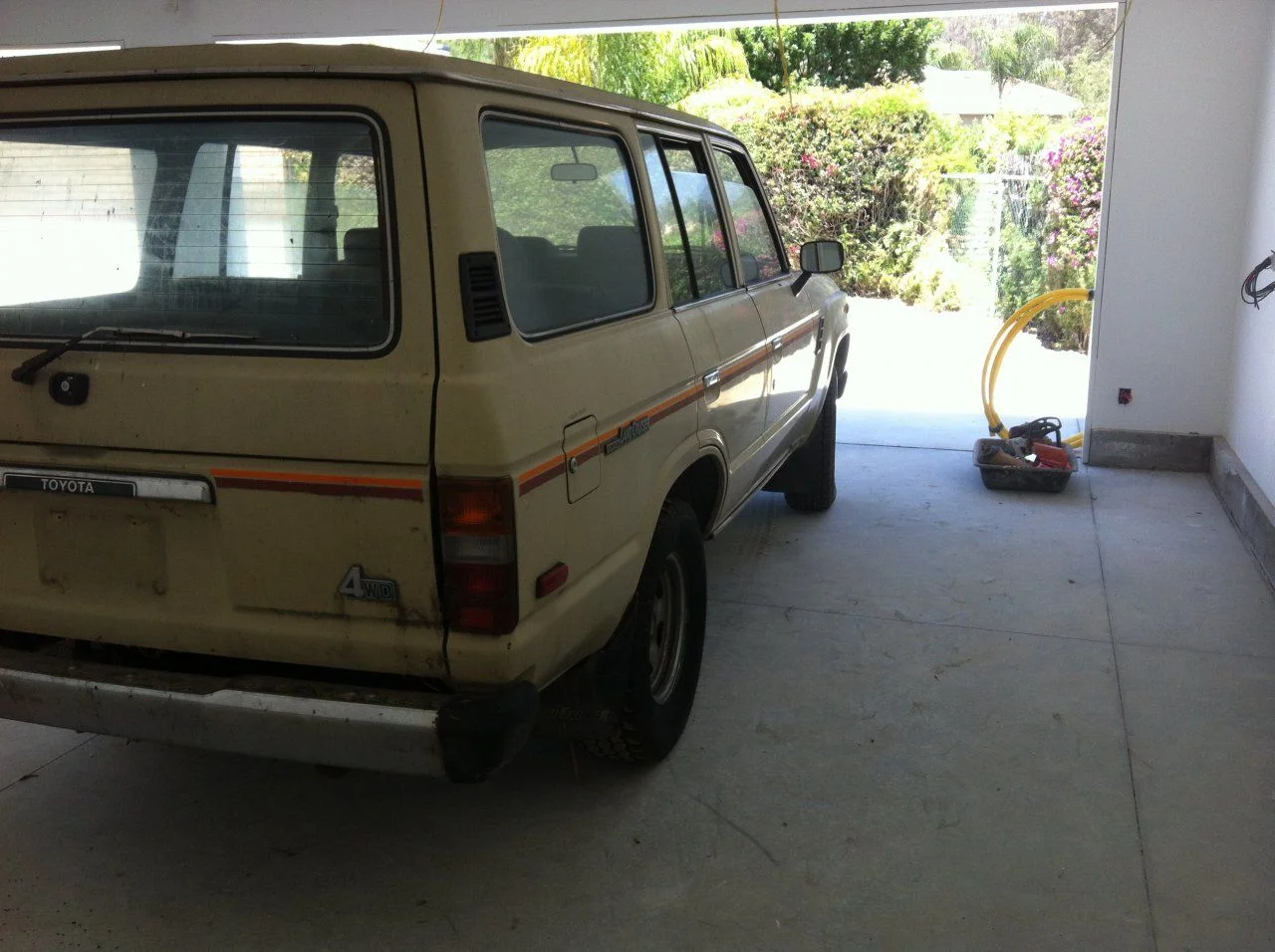

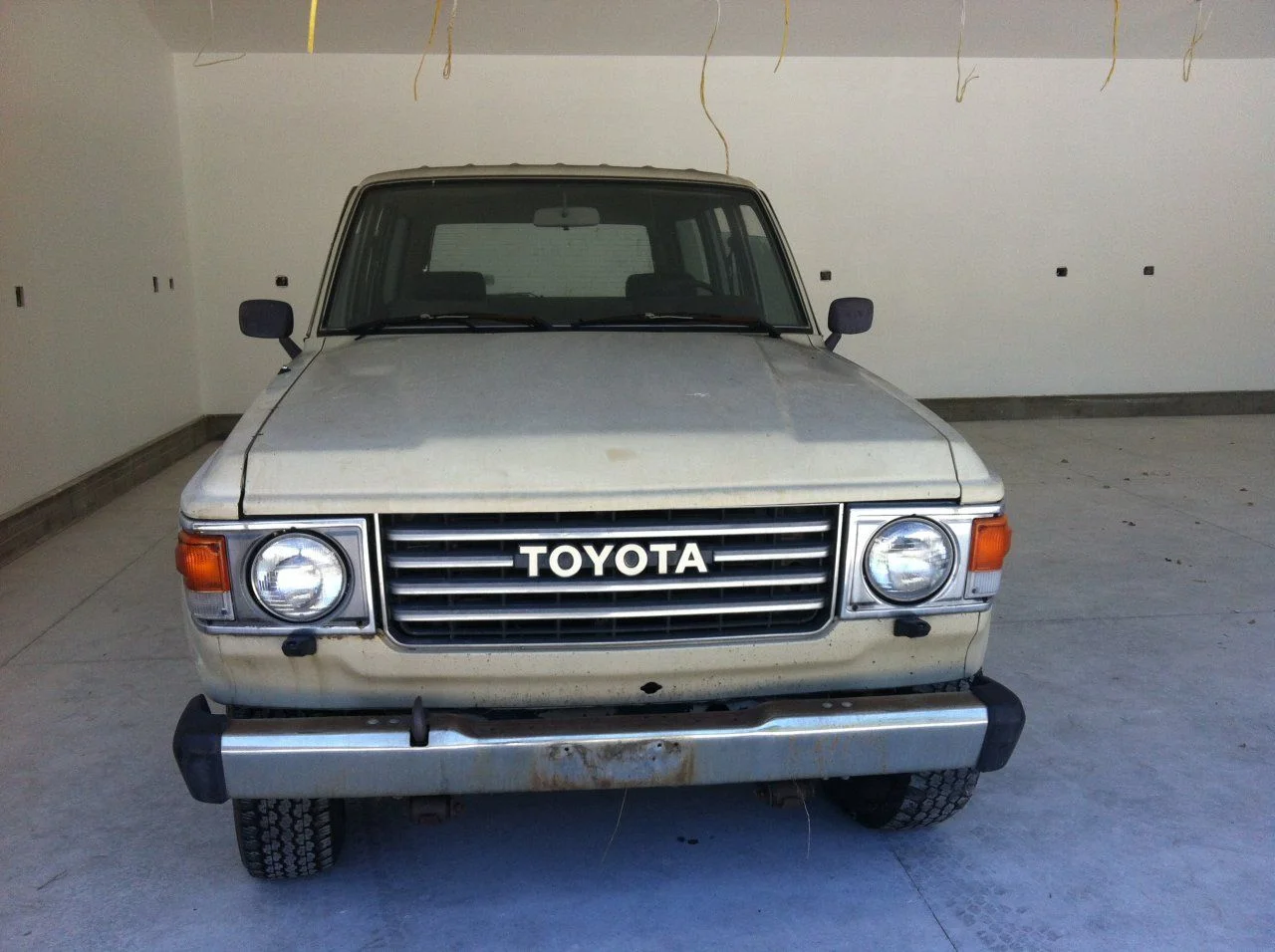

A couple of pix as I rolled it into my shop.
