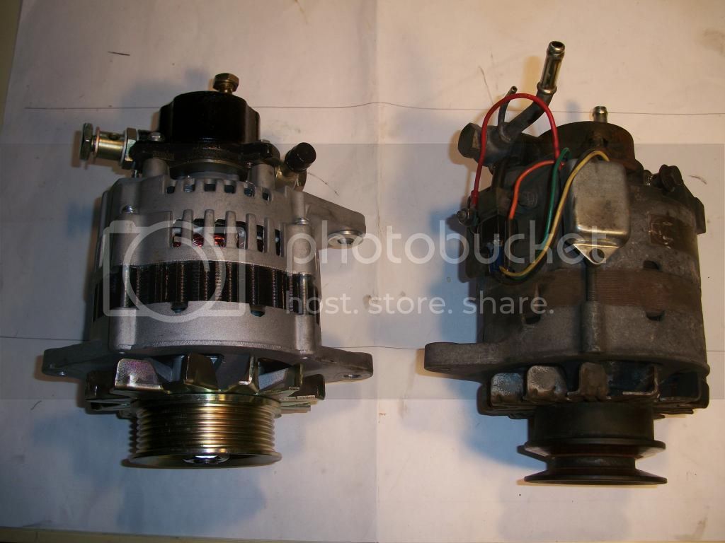

To clarify for the thread, I'm referring to the LINK not the alternator here. I have no comment on whatever alternator that the link was supposed to reference. Here's one last pic of the new vs old from a 12HT. I replaced the new pulley and vacuum fitting with the originals.

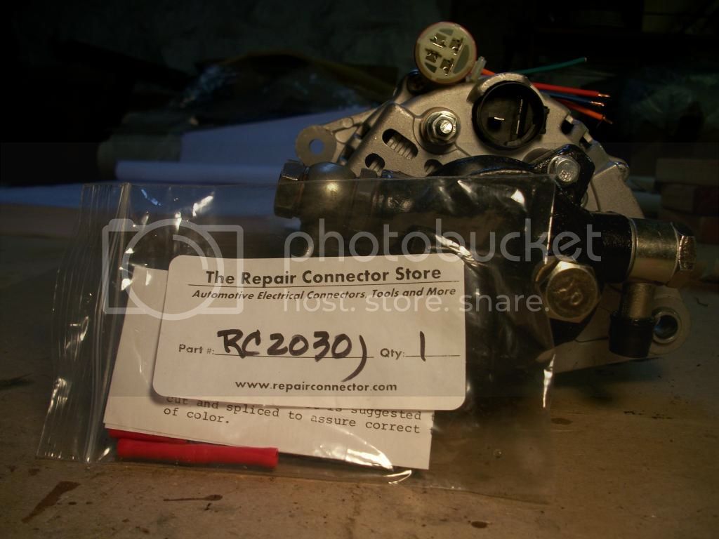

Electrical connection.
