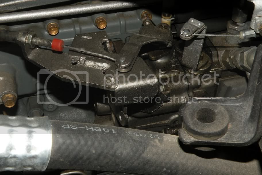

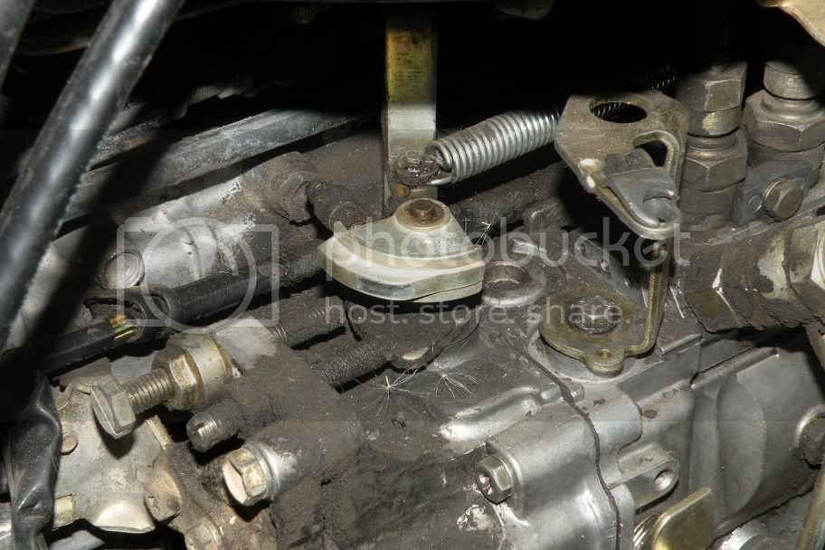

Good question on the kickdown cable. On the top of the injection pump there is a cam that is actuated by the throttle and presses an electric switch. I think it is a component of the cold start enrichment system, which I didn't use. I removed the switch and welded my kickdown arm to the top of the cam and then built a bracket to hold the cable end and welded that to the existing switch bracket on top of the injection pump.
The first pic shows the cam that I am talking about on the other engine I have, the second one shows my assembly as it sits on the truck. I built the arm and bracket to extend the cable from its starting point to fully extended which was 1.4" of length. This ended up being way too much and I had to loosen the cable all the way to the end of my adjustment as you can see in the picture. I think it really only needs about 1" of throw to properly operate the kickdown valve. As it sits right now if I even press much past 1/2 throttle it will kickdown to the next gear. From what I read it is much better to be too tight than to be too loose on this cable.
Hope this helps. I am still on my first tank of fuel, but I should have some mpg numbers by the end of the week. I don't expect that it lost too much as I can't see any difference in the the way the gauge needle is going down. I am expecting a 1 to 2 mpg loss to run the slushbox but I will post up the actual numbers here in a few days when I fill up.
