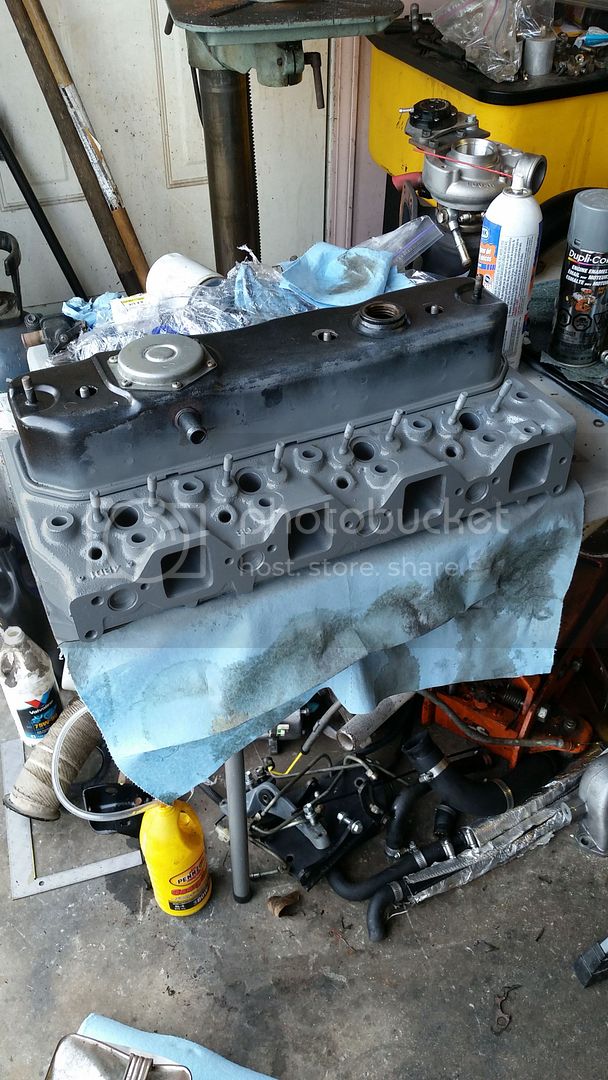

I also got my head back today its not got any cracks and is flat within .001 tho. The valves where redone as 3 where leaking and not done properly first round. They look great now he also checked the deck and said the finish should be fine for a metal head gasket. Compared it too a finnish of 90 on there scale? Said anything from 70-110 is good for a MLS head gasket.
I then repainted the head and got it ready to go on.

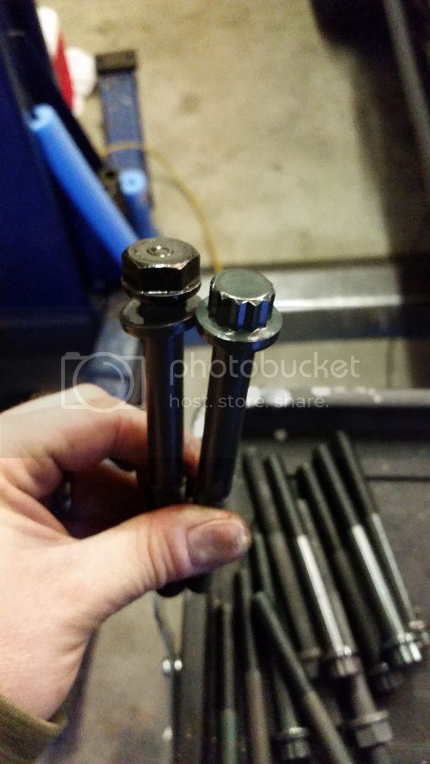

Old head bolts vs new.

ARE your new head bolts the stretch type (TTY) and if so did you torque accordingly.
In a Toyota engine, the difference between " Normal" and TTY bolts look exactly the same as your picture.

Nope they are just a part supersession as far as I know. There is nothing in the manual about using TTY bolts. I have not actually seen any bolts in this engine that are TTY bolts. I checked a few other Isuzu engines and none of them are TTY bolts for the head.
Isuzu does have a specific torque sequence of 50ft/lbs then 65ft/lbs followed by a final 90* turn.
Came across a "final 90 turn" when I did my valve springs on the Cummins. First time I had seen something like that. I had two sets of directions. One said 28,62,90, 90* turn and the other had a final for 120ft lbs. I did the 120 and it looked about the same as a 90 turn.

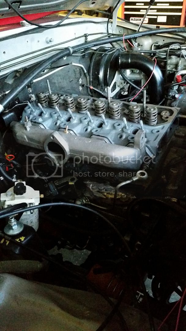

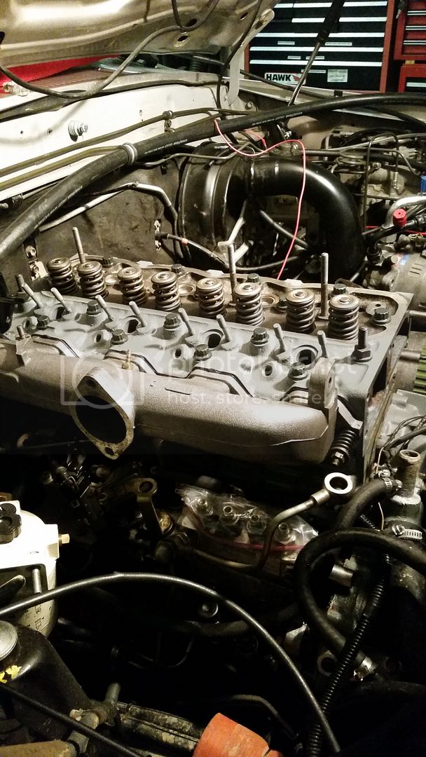

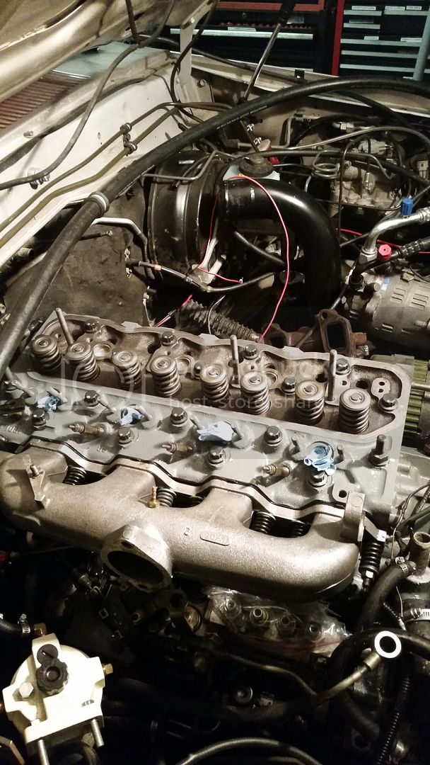

Got a bit more done today. Got the AC and alternator back on. Valve rocker assembly in and adjusted. Valve cover on and sealed. Exhaust manifold on and glow plug system setup and ready finally for power. Its slowly getting there, its my work week now so onlybhave a hour here and there to work on it.
Got it to the point I can start it tonight. Just need to get my new heater control valve and finish the plumbing.
