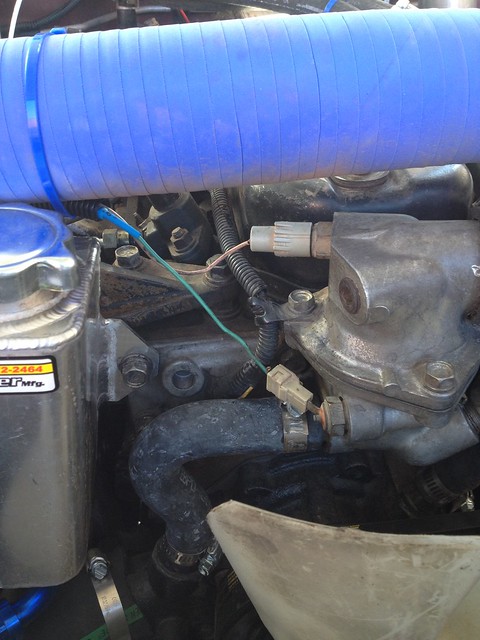

The senders from the 3fe thread right in to the isuzu t-stat housing, and are now hooked up and I have a functional temp gauge

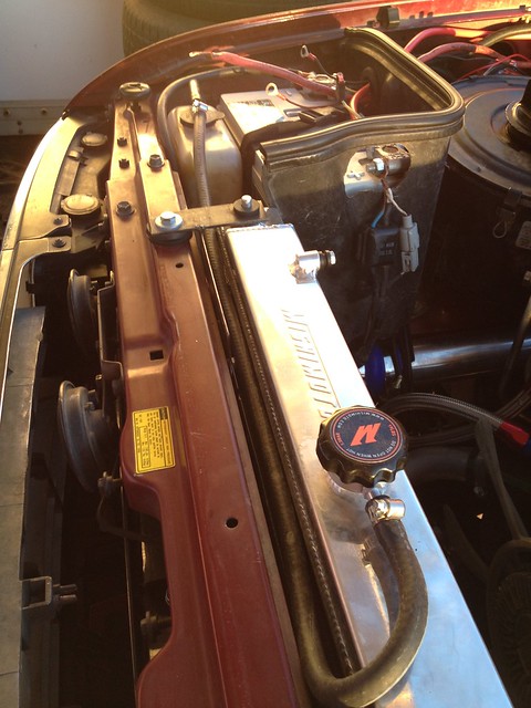

I also put a radiator overflow line to the coolant tank

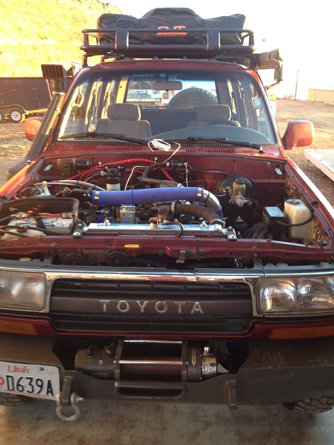

A new look, almost ready for the hood

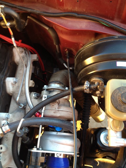

One word of warning on oil feed line, it looks a bit too close to the manifold. Even though they are bradded steel the rubber inside cant handle the heat from that.

Yeah insulating sleve will help but you need to get it off the manifold to prevent contact hotspots.

The oil line for the turbo sits about 2.5" off the manifold, I adjusted the position a little.
