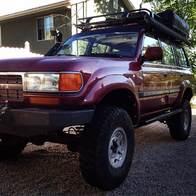

I have been putting some miles on this rig around town, and I got the 4" slee lift on, just waiting for a few parts from them to complete it. I ordered the heavy progressive springs for the rear and I am running the one inch spacer on the front. It sits pretty level, and with a little extra weight it rides level. I think I have enough clearance on the pan now, but I am going to pull the springs and do a double check.
photostream
But I have been really liking this set-up more and more. I am going to swap a few things around, namely upgrading to a full flow/bypass oil filter set-up, chainging all the aluminum AN fittings to steel, and probably use different lines all together. Those have been a big waste of money so far, I am tired of dealing with small little leaks from the fittings. I will also at some point run continuous hard piping on the intercooler as much as possible, which will help eliminate some of the little rub areas on the piping and boots. I have not built a fan shroud, and so far I have not even been close to getting even on the high side of normal. I will build one eventually, more than likely. And A/C is getting higher on the priority list as the temp goes up in these parts.
Looks good! What size tires? How is hwy RPM cruising at say 65mph?

I just got back from a 400+ mile jaunt into the great basin area. I flogged her pretty good. The truck performed very well, and I had zero problems, hence why I can update this right now!
I am running 33x10.50, I haven't swapped to 35's yet. It cruises at 65 very nicely, in fact, between 60 and 70 feels very good, although the closer to 70 the more it seems like you are pushing the motor a little much. Power on the hills is pretty good, although on the long steeper grades it will slow down a little. Still better than the 3fe. I don't have a working tach yet, the one that came with the adapter was damaged from me threading it in too far, and the flywheel took it out. Oops.
