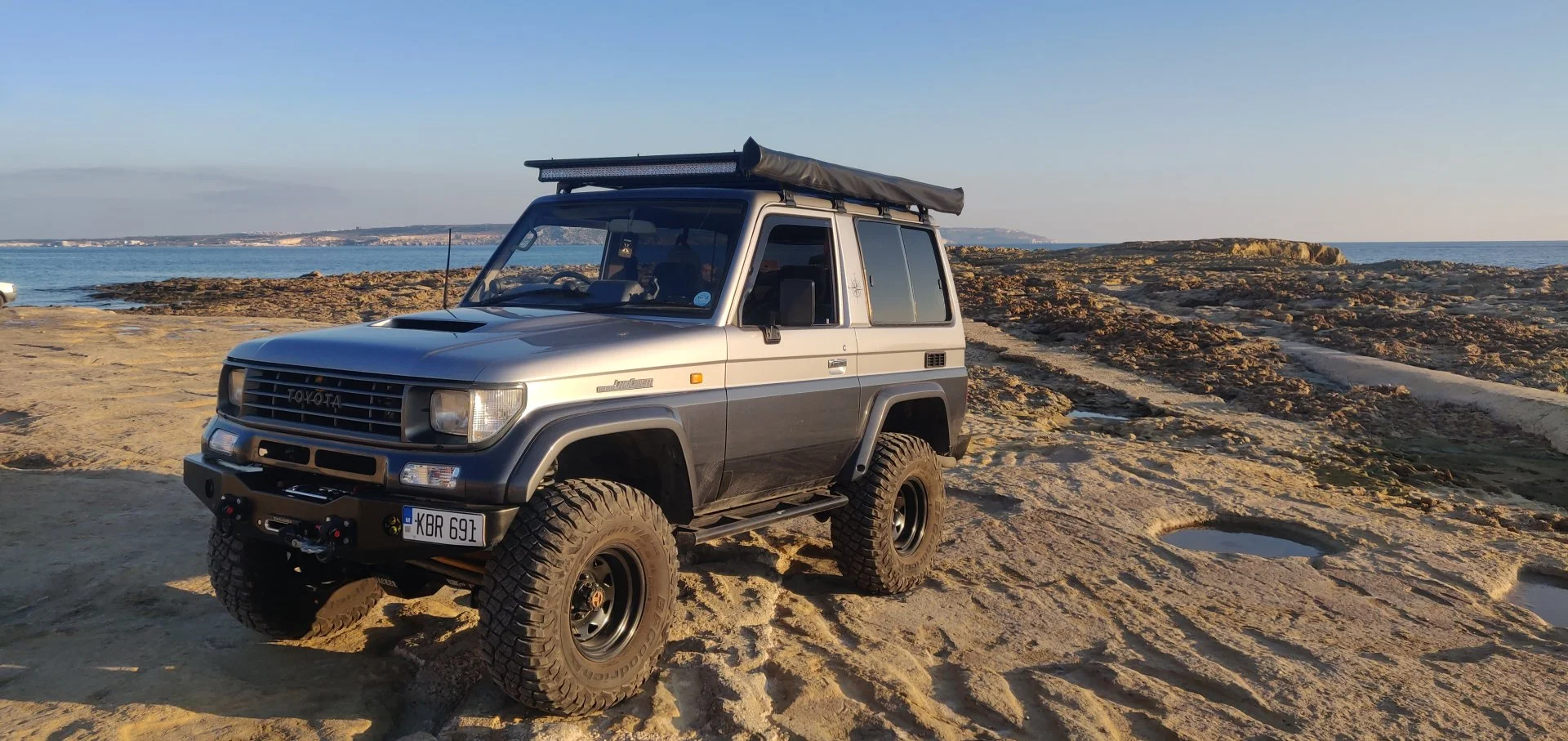

Issues with 35's on a KZJ70
Sep 27, 2021
2
9
Malta
I've seen plenty of kzj70 / kzj78's with 35's+, but have either had axle swaps (Patrol) or other modifications. I believe that the 1kz-t engine isn't the issue as there's plenty of torque, but I've heard of other possible failure points which include diffs, front knuckles, and mainly axles.
So my question is, is there anyone with a kzj70 that runs 35's, and uses it for heavy offroad and on-road applications, and hasn't experienced any issues? If there were issues, what were the culprits?
Thanks!
