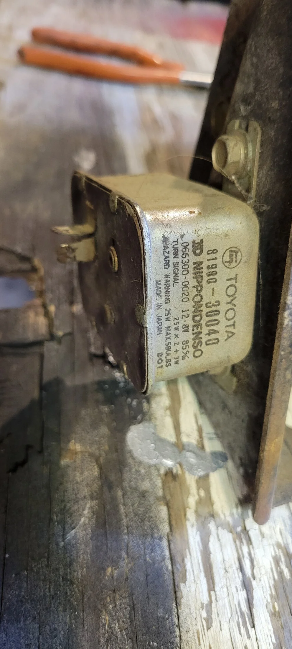

The flasher in a 40 doesn't look like the normal round flasher units. It is a rectangular box mounted on the left side of the pedal assembly. You can also make a pig tail to plug into the 40's harness and plug into a electronic flasher which activates with less amperage. They're available with a report or silent.

Older flasher units require resistance to work properly. When you use the turn signal it is only triggering the lights on one side. Apparently there is not enough resistance to trigger the flasher properly. When you use the emergency flasher it triggers both sides and now the resistance is enough for the flasher to work properly.
