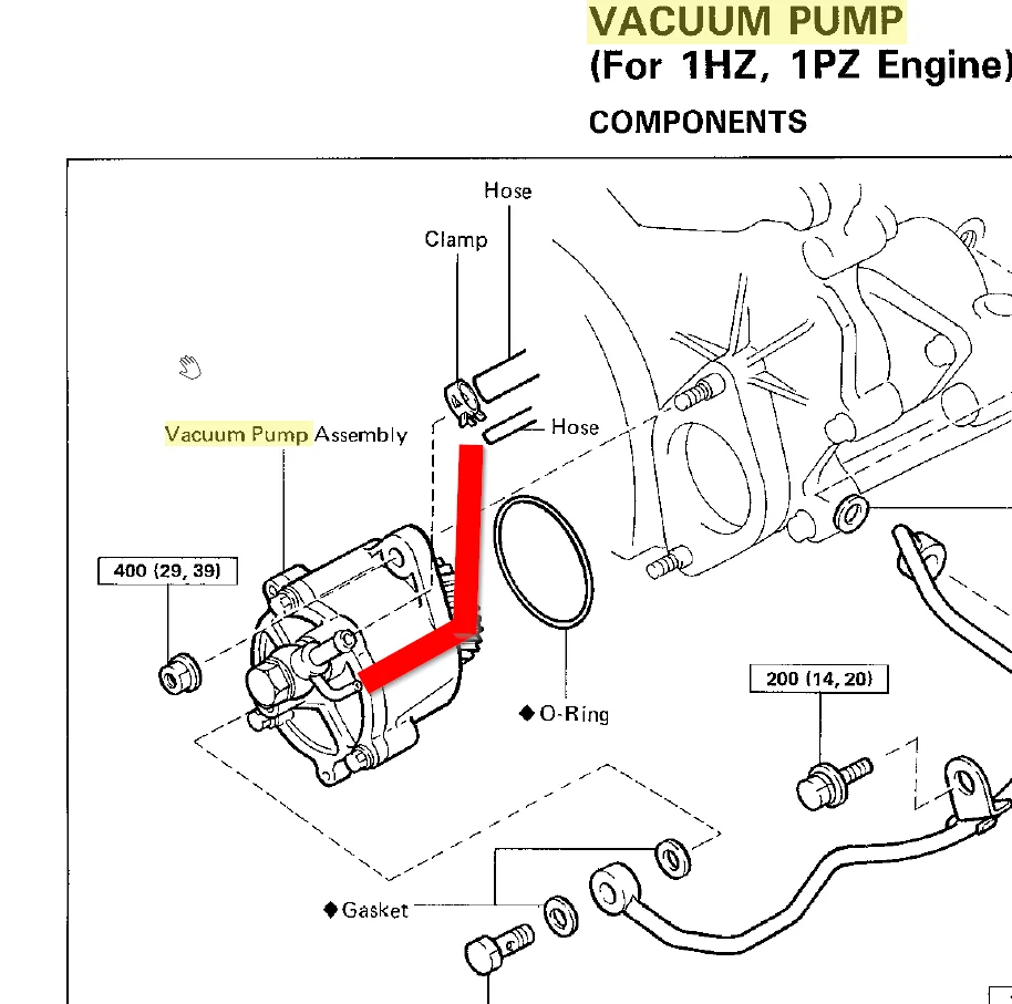

As I was tracking those cable down the engine bay, a pipe close by got my attention. It goes from the vacuum pump (front of engine) to the back of the engine (touching the batery cable at the rusty point, hence my curiosity) but is not connected to anything on the other side. So I am wondering if it is expected. Here it is, in red, from RM183E (BR-49):
Any help in confirming where it should connect to on the other end? I could not figure that out from the documentation....
Or is it just connecting to nowhere, but then why is it going so far :)?
Thank you!
