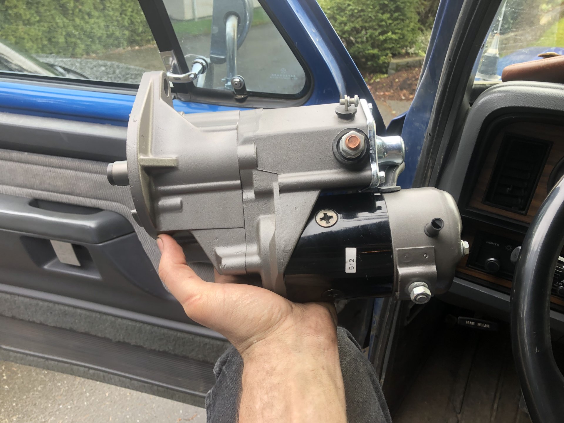

Any idea what the part number is for the 12v 3B starter?
I'm using my spare at the moment unfortunately...
I've read that the 2lt starter is the same , you just have to swap the nose cones, might widen your search area?
Assuming 12v?
Ya 12v. I don’t mind swapping nose cones. Mine is still in good shape (it’s even painted to match the engine)
The other thing is that there's a couple different versions of them. Aluminum vs steel bellhousing noses are different.

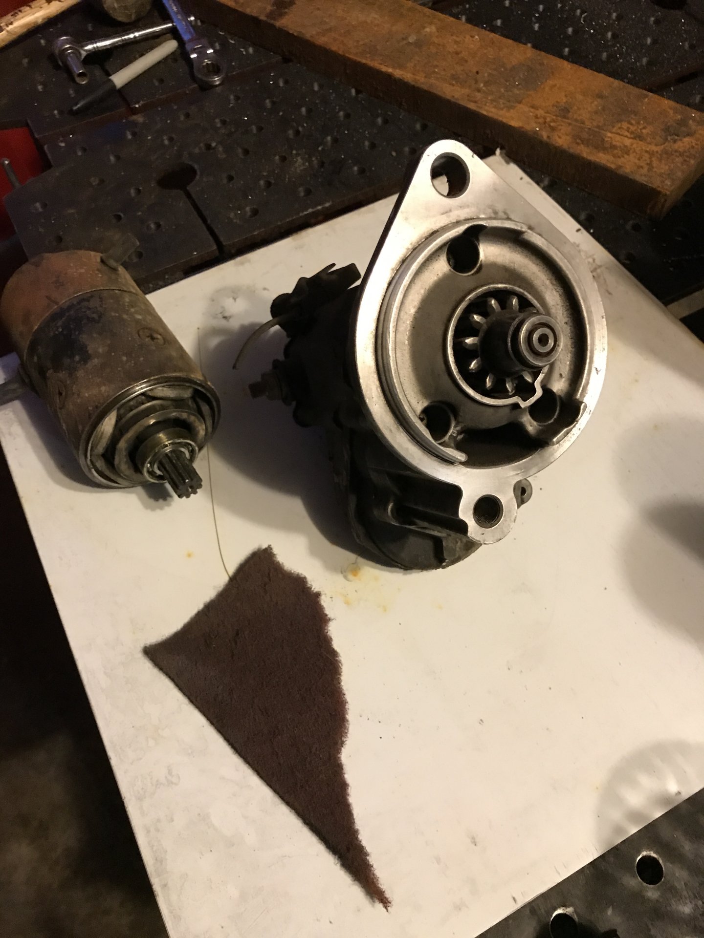

so I had to do a bunch of farting around to get my spare to work.
Says unavailable, but might be worth a call? Possible it's not the diesel one too.
Anyone have a starter he can borrow if he ordered one from around the globe?
I’d loan you one of my 2 spare starters if they’d do you any good. But mine are from the dark side. ;)

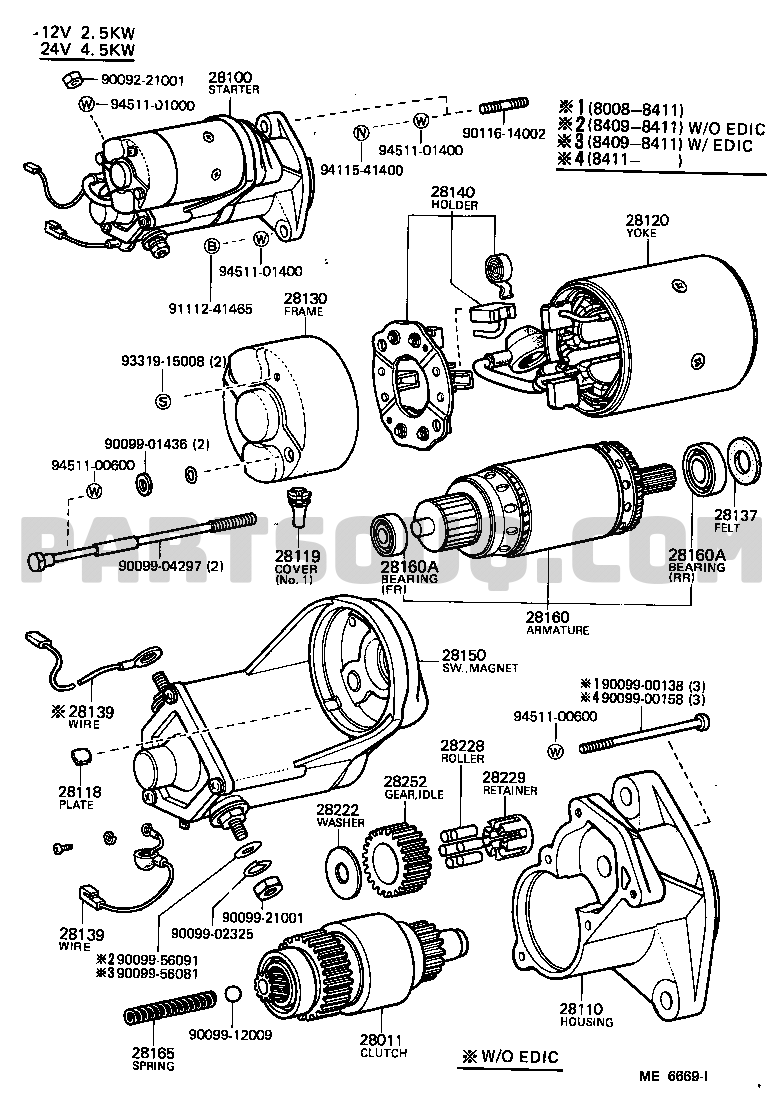

Working on electric motors for a career, one can change a armature easily also. You say the rest of your starter is in good shape, the gear reduction and solenoid are good, all you need is the motor then, don’t wast your money buying the whole kit and caboodle.
Toyota starter motors and armatures are common to most Toyota starter assemblies of the same 2.5 kilowatt and we’re used in almost everything 12v Toyota of the 80’s. Two small bolts and hook the wires back up and your back in business!
You shouldn’t have any problems finding just the motor at an auto electronics repair shop or if your feeling adventurous a junk yard.

Just talked with the guy and it looks like everything is toasted not just the armature. My mistake.

There's lots of part numbers, because of the changes in the noses. This page shows a bunch of toyota p/n's if that's what you're after?
I don't know which variation you need, changes with the year of the 3b/5speed. Pretty sure it just comes down to aluminum vs steel bellhousing.

Macks auto electric was able to build one out of spare parts and salvageable components from my old one. We are roaded.
He is getting to be my #1 problem solver for Auto Electric parts. His knowledge of starters is very extensive. When I walked in with a starter issue for my 40 engine conversion, he knew the solution off the top of his head, and had the needed nose cone in stock. :D 15 minutes later I had the custom built starter I needed.
