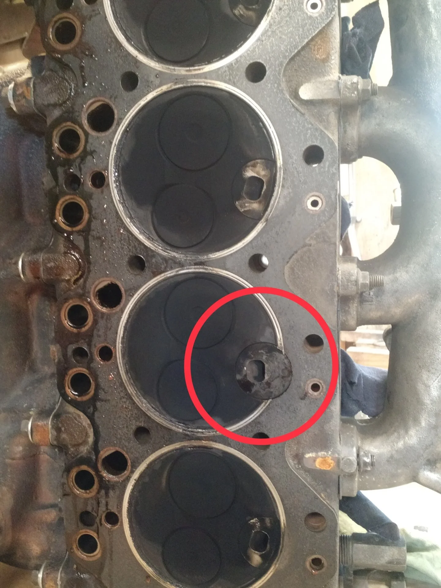

Did that ticking for a few weeks of minimal driving, took it on a camping trip and just as we were rolling up to the site she got really loud and lots of clacking, no power and insane engine shakes. Little cough of oil out the crank case breather and then stopped dead. Had lots of oil and good oil pressure the whole time
Yeah after 400,000k the pre cups start to crack and eventually when one of those cracks becomes structural the pre cup will lose a chunk into the cylinder.
That chunk will rattle around making loud ticks slowly scoring up the cylinder walls, then when you least expect it the rest of the pre cup might fall into the cylinder locking the 3B up into a tire screeching halt.
This is a fresh 3b pre cup loose in the head causing cylinder damage. Imagine a little nasty hardened chunk of steel in there.
