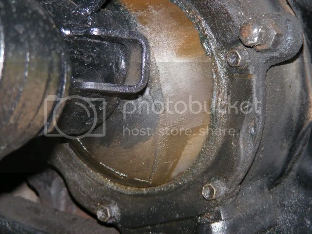

So I went under the 80 a few days ago, and noticed this. Its only on the passenger side, the Grease seems runny, but still smells like bearing grease. Is there anyway that an internal shaft seal is leaking Gear oil into the Knuckle?
Passenger Side
Driver Side is dry.
Thanks for any help you guys can offer,
-Tom :)
Passenger side looks like the soup (gear oil and knuckle grease combining) mixed with dirt or rust.
A great step by step in the FAQ section at the top of the 80 section.
Hard to tell from the pix, also the grease, etc, on the outside is contaminated with road debris, etc. I would look/sample what is inside, through the fill hole. It looks like it needs a seal job, but: The level looks low, would bring the level up with fresh moly grease and see what does, for sure if you plan to drive it before doing the work. The birfs are $$$ and are quickly worn when run without proper lubrication. Even with some leakage, they can be run without damage, as long as the have moly grease at the proper level.
If you haven't done it, would check, change the axle gear oil. It gets contaminated/thickened with moly grease and needs to be changed relatively often.
I have had good results with Kurt's kit: Cruiser Outfitters

Everything is covered in the FAQ front axle service thread: the knuckle/trunnion bearings come right out, the races need to be knocked out using something like a small brass punch or drift. After cleaning out any grime or rust from where the races seat you can tap the new races in carefully. Also be sure to power wash the axles and knuckles very well front and back the day before you start, maybe twice. Either way as others have said most of your time is spent cleaning the parts. If the knuckle/axle balls are rusted badly IMHO it may help the new knuckle wipers/seals to seal better and last longer if you sand the balls smooth while everything is apart.

The Loyale: my trucks knuckle balls had more rust than yours when I did my first front axle service so I sanded then painted them with an epoxy paint 1 1/2 years ago, this is how they look now. If the knuckles are kept at the proper level of grease the balls are less likely to rust, but being up north you're probably more likely to get some rust either way?? Is your truck an FJ-80 with the 3FE?
Idk what other repairs you have had to do on it.....but the axle needs to be done every so often.... I think 60k is the recommended interval, but don't quote me on that. My point is...at some point it needs to be done as normal maintenance and isn't a reason to ditch it. But if you feel that strongly about it, drive it west Virginia and I'll take it off your hands.:)
If the knuckles are kept at the proper level of grease the balls are less likely to rust. Mine had more rust than yours so I sanded then painted the balls with an epoxy paint 1 1/2 years ago, this is how they look now. Being up north you're more likely to get rust. Is your truck an FJ-80 with the 3FE?

Axle housing end semi-spheres look good painted. Seriously, I used a spray epoxy paint, no primer, let it cure for two weeks while waiting on parts and doing some other repairs. The paint held up fairly well considering.
