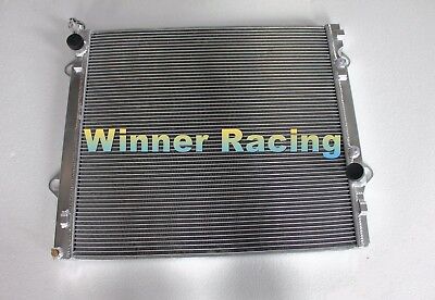

I hate plastic radiator tanks. So naturally after searching the internets i only found a Chinese all aluminum radiator. Over a decade later from the last GX470 year model and still not really any all aluminum radiators out there—much less no Chinese ones?
Is THIS my only option?
The 4th gen FJC and 4runner V6 model radiators don’t fit. Tried a URD aluminum radiator, it was a no go.
I was checking all 4.7 equipped trucks, no luck. I gots to have me all aluminum radiator, preferably non-Chinese.

I just installed this radiator this last weekend. The biggest issues I ran into:
1. This radiator is a bit thicker than stock and the end tanks are square, not round.
2. The 4 mounting tabs for the radiator on the stock radiator are flush with the leading (bumper side) edge of the radiator. The aluminum one has these mounting tabs set back about 1/2".
2a. #1 and #2 make it so you need some washers and longer bolts to push the radiator back so it isn't hitting the mounting frame.
3. The radiator cap neck is totally different than stock so your factory or TRD radiator cap won't fit.
Only been on a couple drives but it seems like a solid radiator. Need to do a full write up as it's own thread at some point.

Did you ever do the write up? I’m thinking about getting both of our GX’s (470 & 460) these radiators. I know my 460 needs a radiator soon.
I cannot find a local north Texas shop to make me one so it’s China or nothing. I suppose I could just use a Denso replacement until the next 90-100k miles rolls by and revisit this topic.
What about a group buy with Griffin Radiator? Is there any variants of the design or just one design that covers from 2003 to 2009? We might be able to get a good American made product at a decent price.

Just got off phone with Griffin Radiator. Ballpark figure for custom build is $850 (starter price). Build time is about 6-8 weeks. And they would need a physical copy of one to get actual dimensions.
They can do a "lot build" of several radiators but they would only deal with one person.
