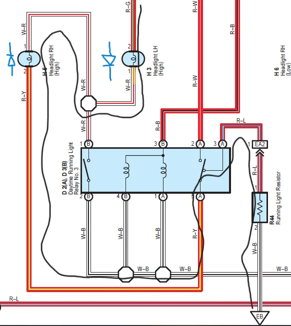

in order to make the DRL work for LED you will need
1) LED is non-polarity type, which means it can be power on both direction.
2) LED has wide input voltage range, say 3V - 12V range
3) LED light output should be controllable by input voltage
It could be very hard to find this kind of LED bulb, a PWM and polarity change circuit can be designed for this one (I think that is the "decoder" but it is not simple and I don't think there is an existing "decoder" for this).
I suggest just disable the DRL completely and remove the DRL resistor. If you do need one just by 3rd party headlights with additional LED decoration which you can use as DRL.

So I installed the LEDs for both the high beams and the low beams. Hikari low and Kreiges high. Not easy getting the driver side high beam bulb out and in! With the resistor still connected with both LEDs installed the DRL's do not come on at all. That's okay, but do I still need to disconnect the resistor?
Actually no need to do that. Test your high beam. If both are working in high beam which means in DRL mode, the cathode of LH LED connected to cathode of RH LED, the diodes will block the circuit and no current will go to the resistor in DRL mode.
The benefit for removing the resistor? Reducing the weight and give you the space for other applications (air pump, second battery, etc.)
Thank you Sunfic. Both high beams are working when they should be. I'll just leave the resistor connected unless I need space. Right now it's not an issue.
