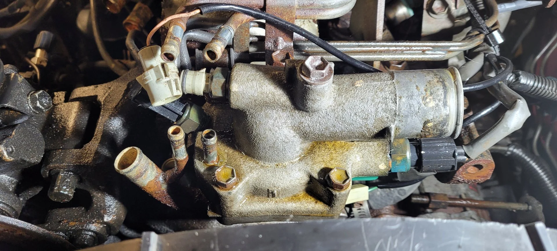

It seems almost every thread regarding thermostat replacement on the 3FE is accompanied by a lengthy saga of extracting broken bolts. I've got a handful of bolt extractions under my belt now, and I would like to avoid it here if at all possible.
I've got a thermostat in hand and have been soaking the bolts in PB blaster for a few days. Does anyone have any tips specific to this task to get these 4 bolts out intact? The vehicle in question is a 1991 FJ80. Picture attached for the fun of it.
Thanks
I think the problem is galvanic corrosion; the steel bolts and aluminum holes just love to be together. Heat's about your only friend, maybe impact to break to bond. I doubt the PB Blaster is doing much.
I didn't have any problems with any bolts on the housing in my 91.
The brass sensors are a whole different story.........
I would recommend not even trying to unscrew any of the sensors unless they don't work anymore.
Interesting...i broke one bolt on the housing when i replaced my broken Ron Davis radiator, and while i am in there, i replaced all my brass sensors, thermostat, belts, fan shroud, fan and hoses. get new factory bolts nonetheless....the brass sensors didnt' give me any trouble at all.
Yeah, mine were practically cemented inside the thermostat housing. It was way bad

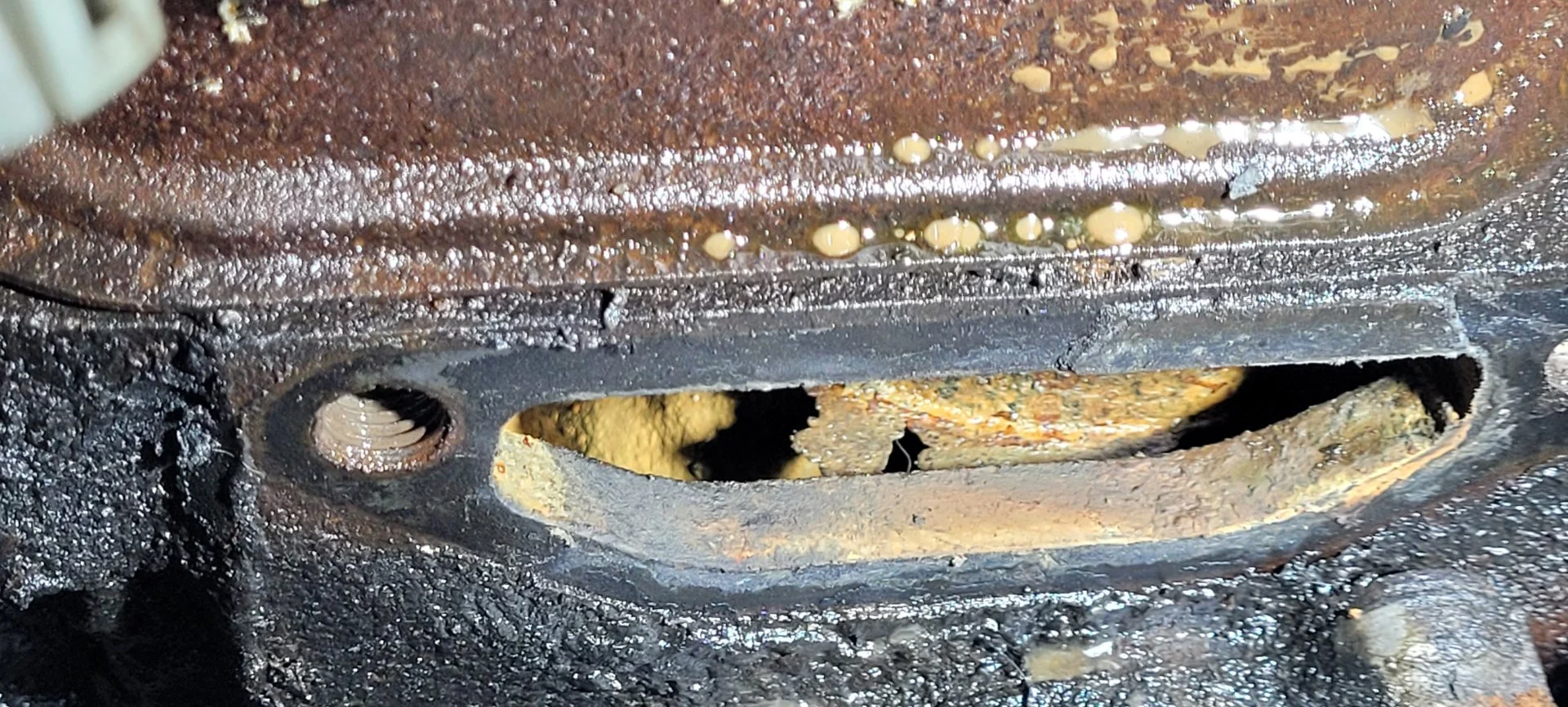

Update: I broke 2 of the 4 bolts. Guess I'll be ordering the lower housing as I don't want to mess with extracting the bolts. In removing the lower housing I caught a glimpse inside the head. Looking a little gnarly in there. Seems like some of it is corroded away. How bad is it?
(For some back story, the truck has 157,000 miles on it and spent some years sitting outdoors after an accident. I brought it back to life and the engine still seems to run well. It hasn't been back on the road yet)
Looks lie a good coolant flush is in the future...
I'm not too familiar with what it is supposed to look like in there. Is that big flake some sort of mineral build up or a surface that's corroded away?
the former
That big flake is casting flash inside the block from the original sand casting. Nothing to worry about.
