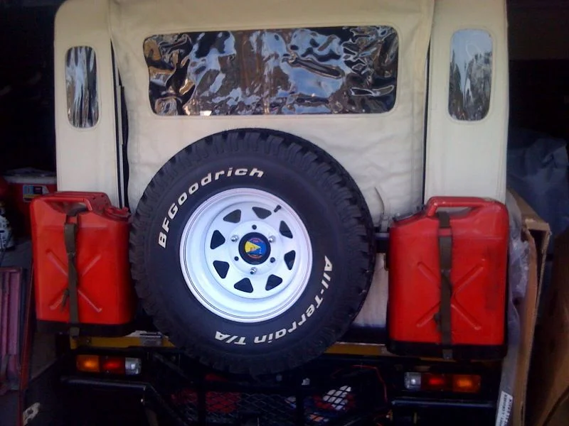

Have you considered mounting a second, plate type tire carrier on the other side of the truck to match the stock 72 on the pass side? I've seen that used as well, and it's a lot sturdier than the barn door for that weight.

if you get another tire carrier then it can be like this :)

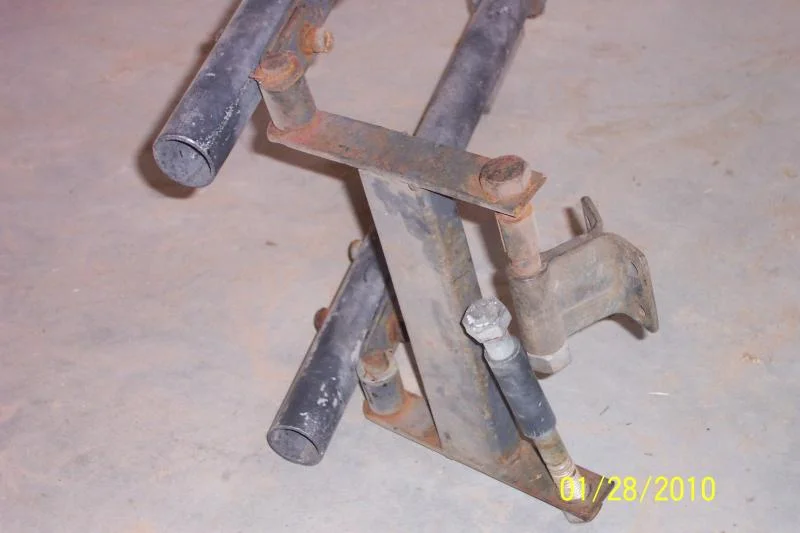

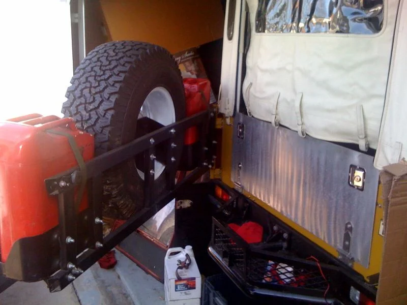

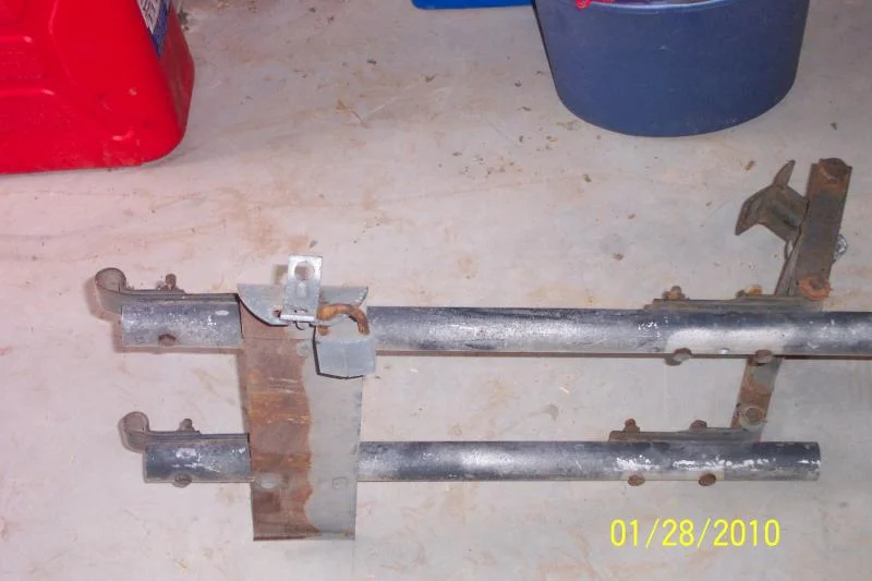

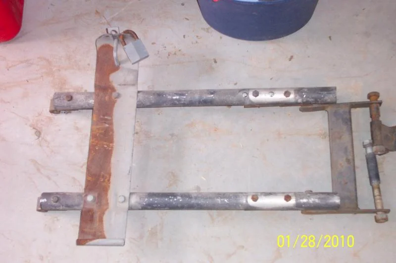

I used the OEM hinges off my spare tire carrier, they were in pretty good shape, so no refurb was needed.
With re-enforcing the tub, I have an aluminum tub, so it was plenty thick to support that, and the weight is split pretty evenly between the hinges and the latch hook when it is closed.
Outside of that, it was a frame make out of some square tubing, with theOEM hinges and latch, the OEM tire carrier and 2 ConFerr can carriers bolted to it.
If I was to make a new one, I'd use thicker tubing for the frame. The tubing is a little warped in a few spots as the years have gone by, but not so bad that is effects the structural integrity:meh:

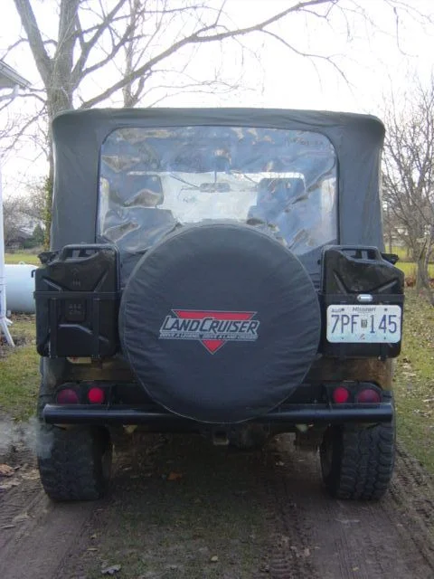

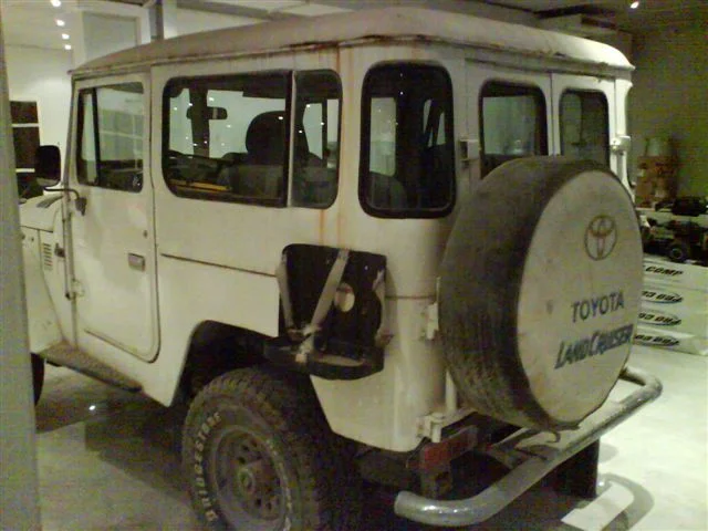

I've got a double jerrycan carrier bolted to my rear door.
The rear door is a single-piece swing out type.
The carrier is bolted to a couple of plates on either side of the door and I've yet to encounter any sag.
Here are some pics of mine:
I have done some wheeling with no damage or sagging, but I'm planning on modifying a stock spare tyre carrier and adding a third jerrycan.

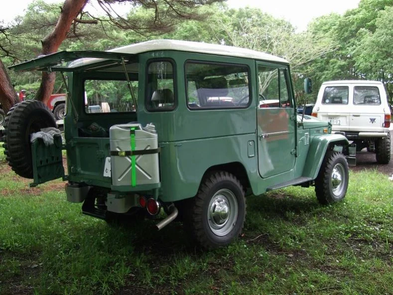

This was a proto type carrier I was working on 30 yrs ago. My daughter kissed a tree with the hardtop/amby doors, so I went to drop downtailgate and softop. I used stock mounts for the tire carrier, one still attached, and gate hinges welded to a plate that I attached to the door. Used two confer can holders, one still attached. The carrier is double hinged to allow the amby door to be opened. Worked excellent for the time I had it on. Would have built a cleaner carrier if a tree hadn't got in the way. Built it with the hinges so you can still open the amby door from the inside. Opps, just reread the post and realized you were talking barn doors. However this type carrier would work with barndoors also.
