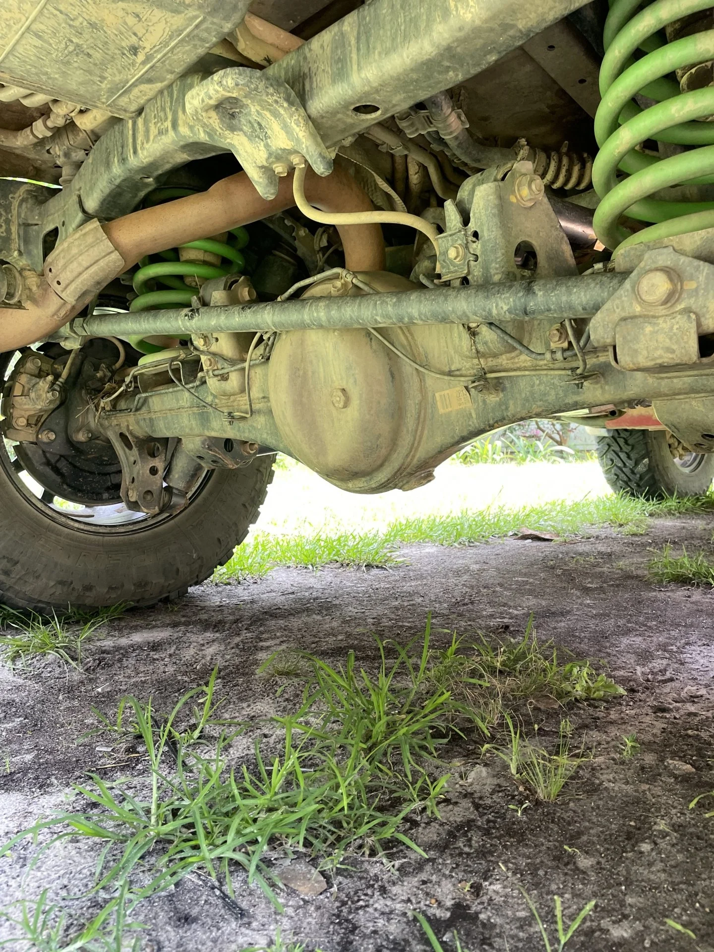

I did a "longish" term review on the @Ironman 4x4 USA UCAs a months ago after I put them through the wringer and now Its time for my Rear Lower and Upper Control Arm and Panhard review.
If you follow me you know ive had constant issues with bending rear control arms and panhard bars. The rocks in Moab and Windrock are very unforgiving. Every single time I would wheel Windrock I would bend a rear control arm, usually both. About every other trip I was bending panhards on the rocks too. I replaced the oem with SPC and still bent them. Them I reinforced SPCs and STILL bent them. Finally I decided to try the beefier Ironman arms.
Ive had them on since the spring but really wanted to put them through the paces before doing a review. I gave them heck at Cruise Moab but really wanted to ride them hard at Windrock. I figured that would be the final test.

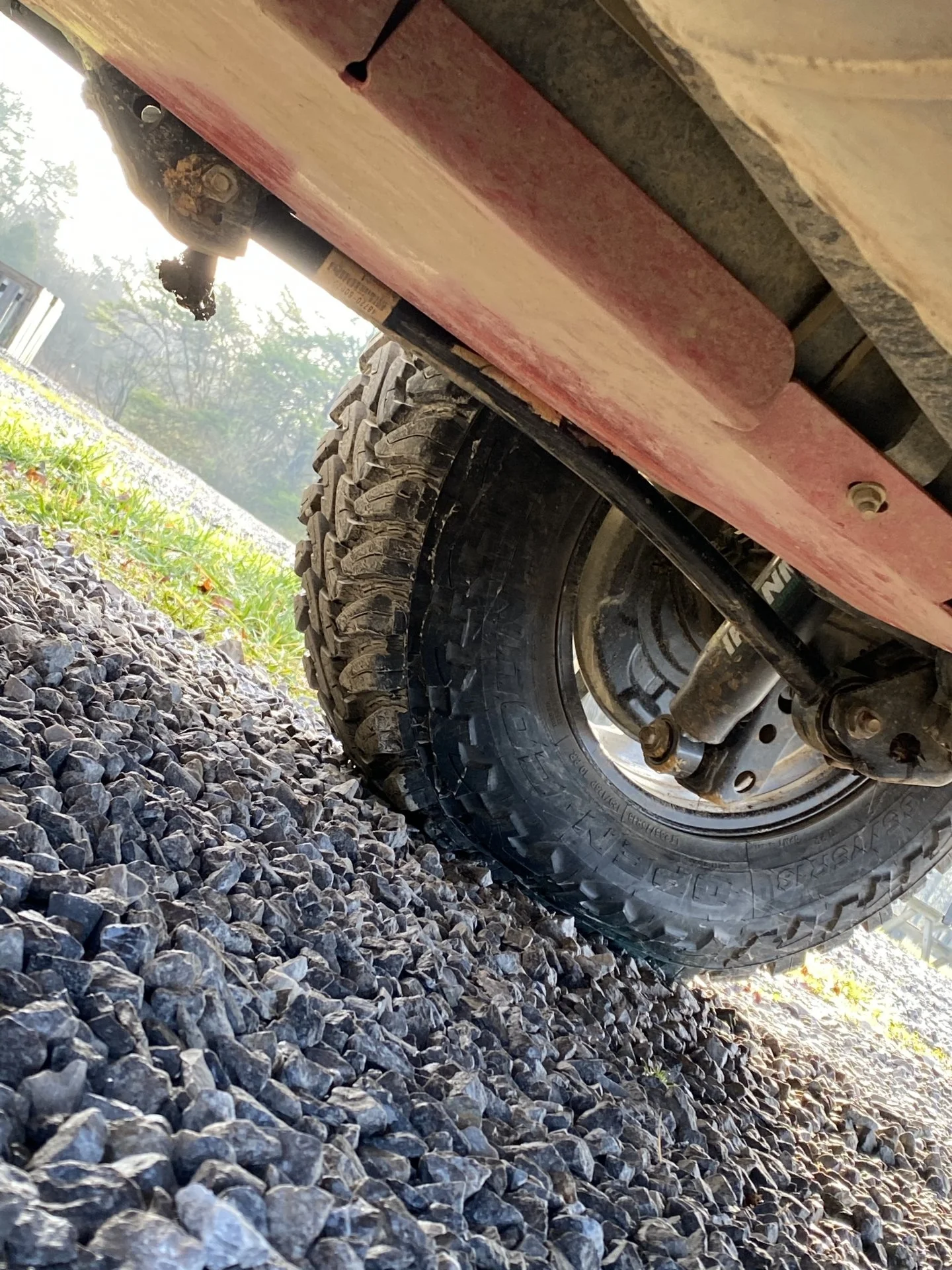

Last week I spent 7 days at Windrock for GSMTR. I wheeled the truck probably harder than I ever have. I cracked an oem CV tulip, bent my steel Budbuilt skids to heck and back, plus sheared the bolts off and nearly ripped loose my control arm mount armor. It was a fun trip!
I'm amazed to say I didnt bend a control arm or panhard. My very first time wheeling at Windrock without a bend, even though it was probably my toughest ride. I can finally say these bars are the real deal.

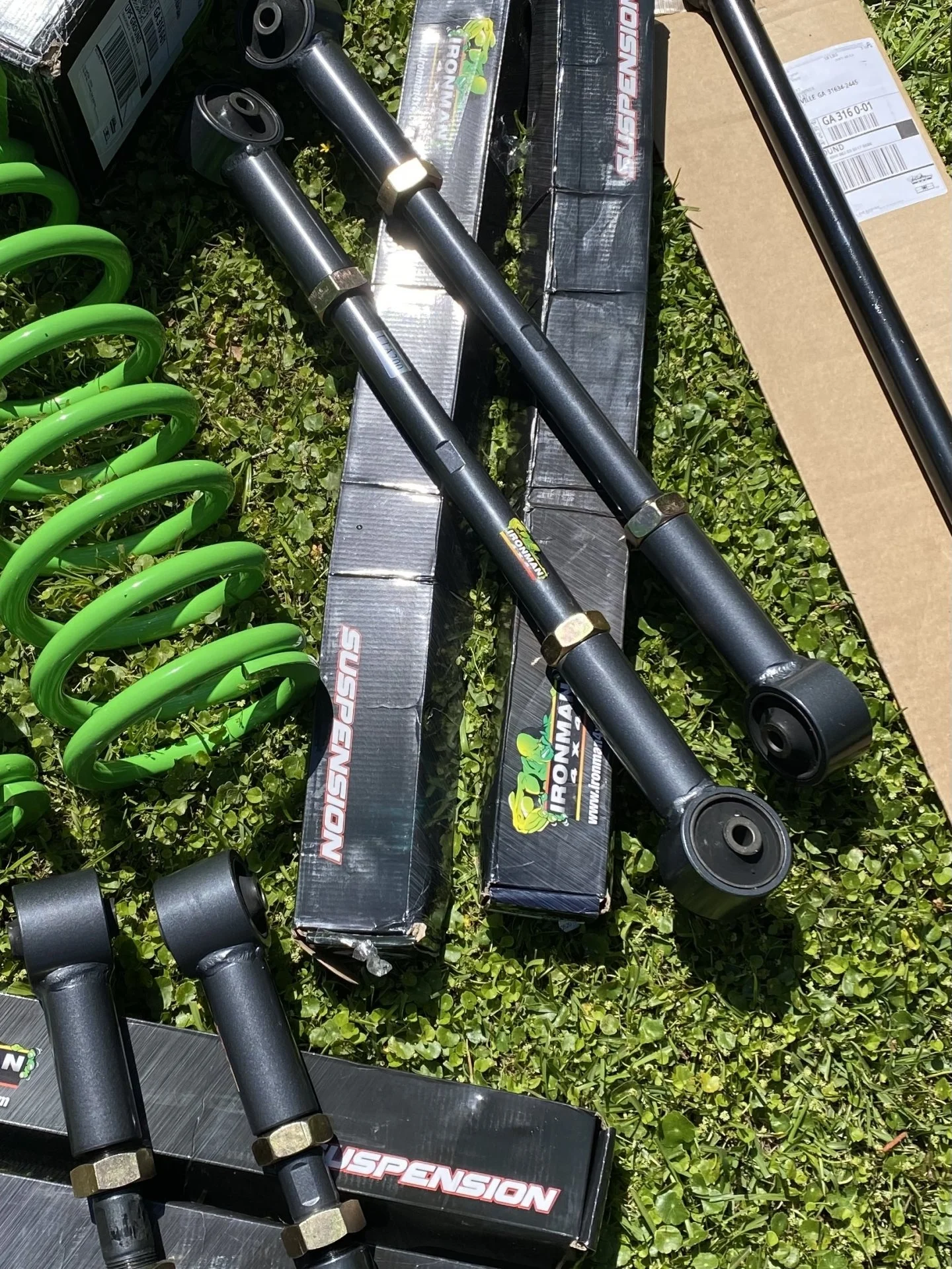

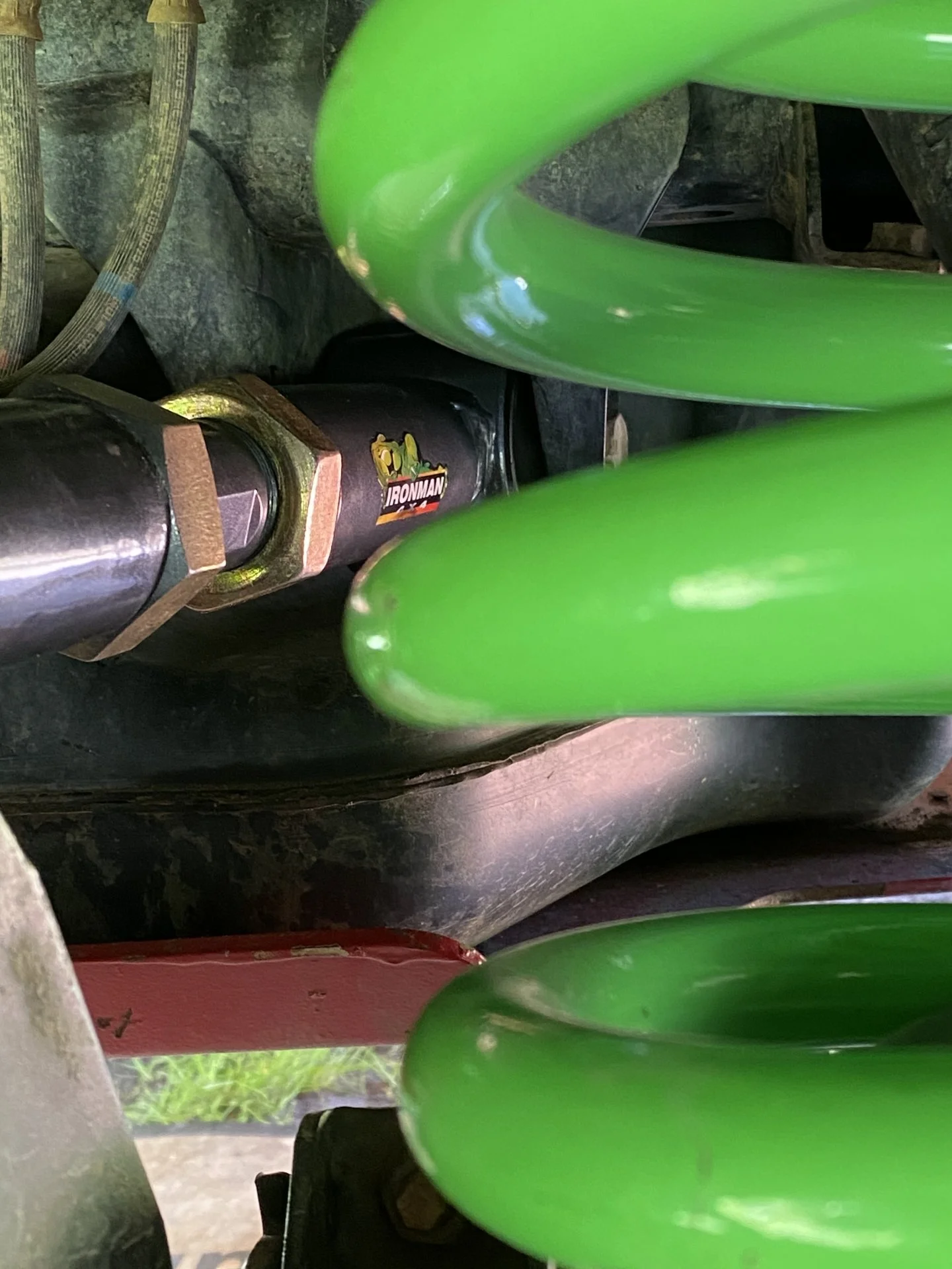

Not only are the arms strong but they have oem style rubber bushings and can be adjusted on the truck. Thats a big win in my book.
If you are constantly bending arms or are building to play hard give these a look. My 200 is at 8100lbs and they took everything I could throw at them. They solved what was always a headache for me. Good stuff.

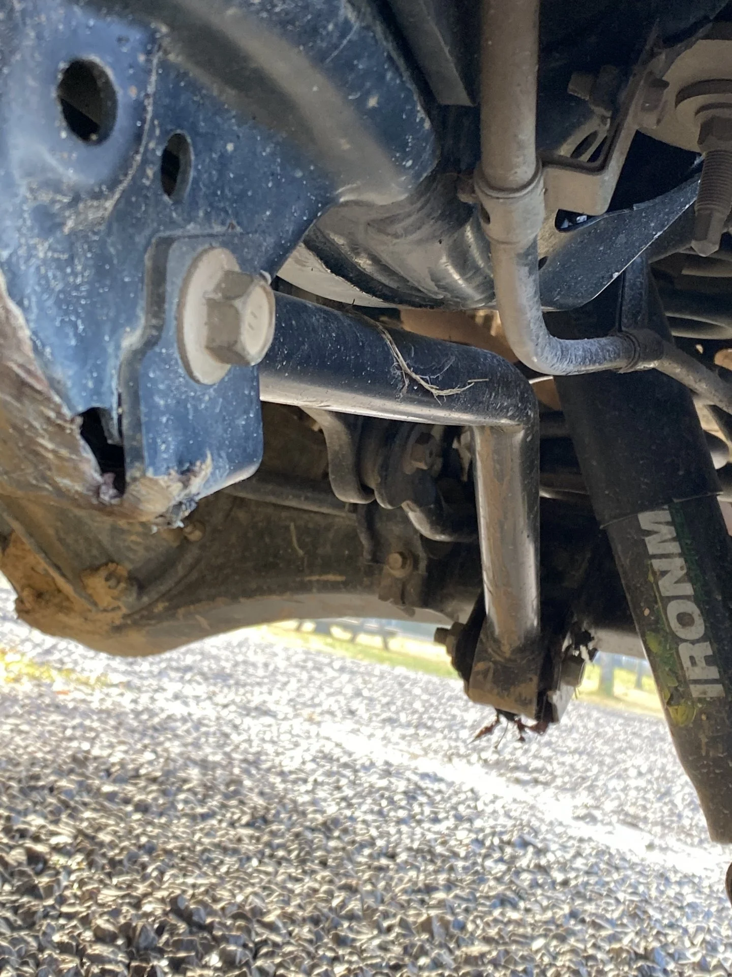

A bent arm at Windrock
Another Windrock Casualty
Bent OEM Arm
New Ironman Arms

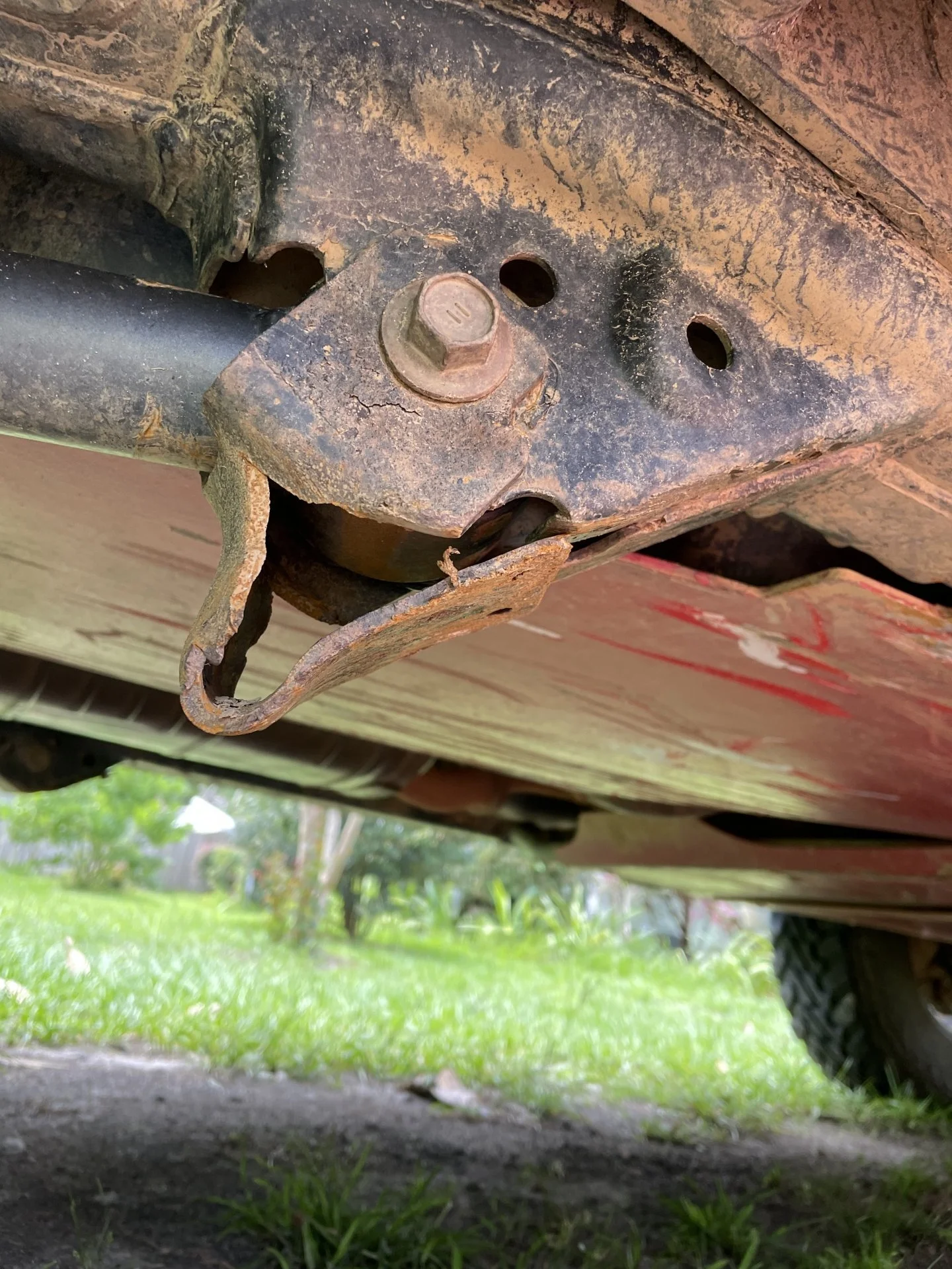

I sheared off the bolt heads and nearly ripped my control arm mount armor off at GSMTR
And bent my Budbuilt Steel Skids (they did their job)

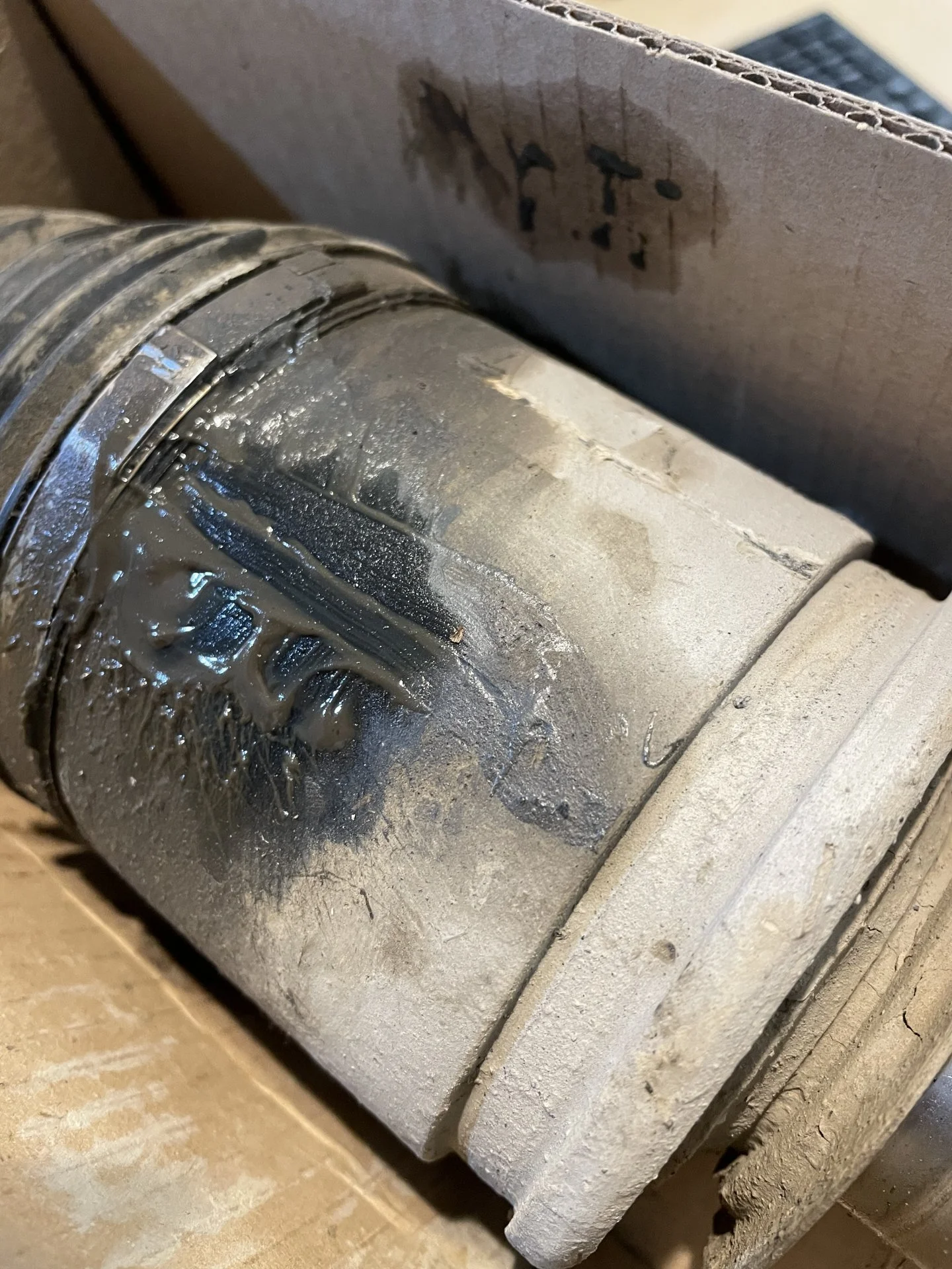

Cracked the inboard tulip on a Toyota OEM axle

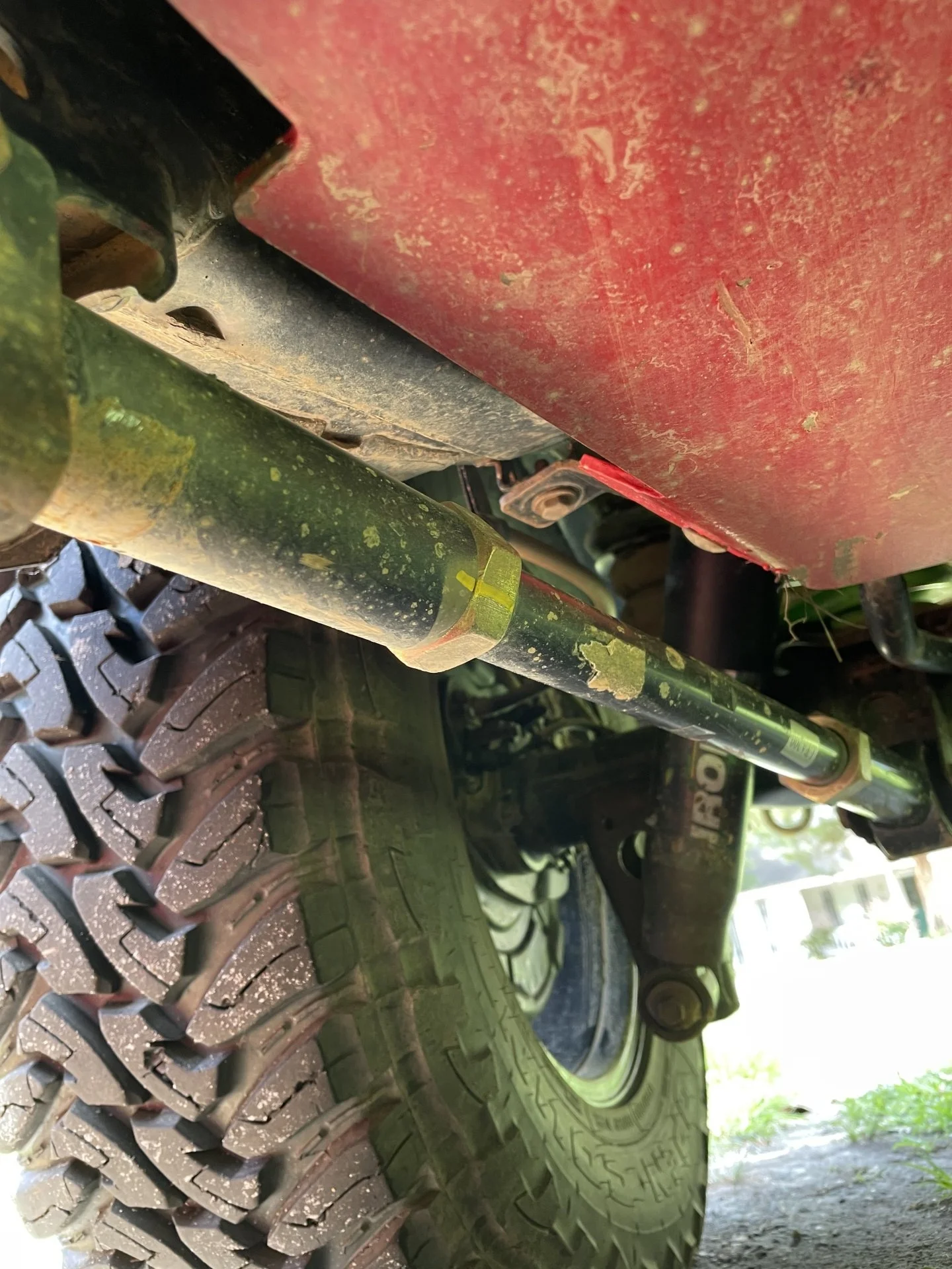

But the Ironman Arms came out smelling like a rose!
Ironman Panhard too😎
