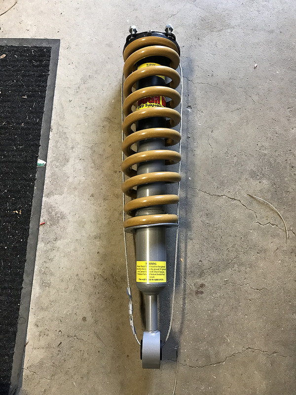

I've always had OME and went with Tough Dog this time around, I highly recommend them. I got them from @reevesci on the forum, lots of different options for shock and spring combinations. One nice thing is the front struts come completely assembled with new top hats, so they just bolt on no messing around with spring compressors. The ride is great both on and off road, firmer than OEM but not harsh and still great for daily driving. I have 41mm shocks, heavy front and light rear springs.

I have the adjustable 45mm Tough Dog and love it. Just remember that the taller rear spring goes on the side with the gas tank, regardless of what TD says.
Had a similar situation on my 13 Tacoma you had the taller springs on the DS I actually had to go back and add a spacer to the drivers rear leaf to adjust for the gas tank. I just ordered the TD setup from Jason he's great to deal with very responsive and talks with you through your needs and build to make sure your getting what you want. Really appreciate that. Now tired of looking a tires and tire sizes the last few days but from the info I've gathered the 275/70/18 at a 33.2. on the stock 18inch wheels is about the best option don't mind shedding mudflaps and shaving some inner liner but not ready to chop body mounts and hammer pinch welds just yet I went through all that mess on my 13 Tacoma as well.

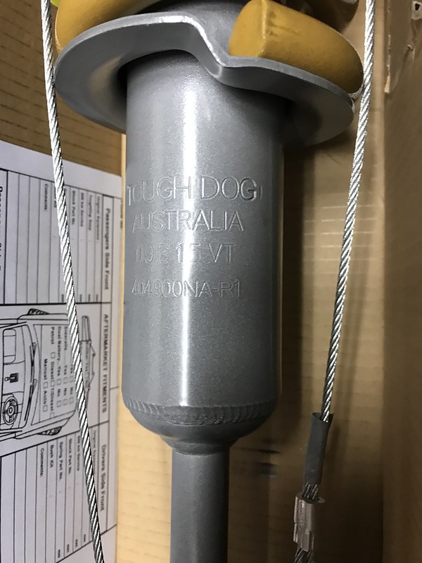

Drivers side/passenger side: I got my struts preassembled, and the boxes were labelled for DS and PS. I installed them as labelled. I did notice that on the spring markings themselves, it was the opposite, the N/S (which apparently means near side, near side to what?!) spring was on the strut they labelled for the driver side, and the D/S spring was on the strut they labelled for the passenger side. One day after the lift, with stock weight, I am within a quarter inch of lean. On the rear, I used the springs as marked: D/S on the driver side, N/S on the passenger side. Currently the rear is equal side to side.
