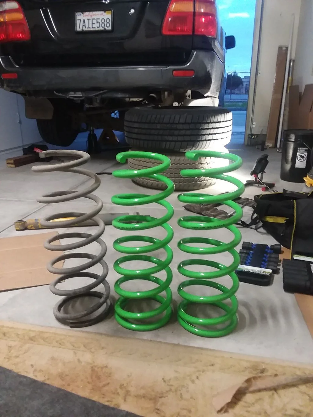

i put them on the side they were labeled. driver side goes on the heavier side according to their site. the driver side is the heavier side regardless if LHD or RHD.
this is true for rear springs and Torsion bars. TBs are labeled left and right. they shouldn't be switched either. they are pre marked for the proper index.
basically just do it as marked.
mine were uneven at first and i thought maybe i should switch them but they eventually settled evenly.
fwiw i can't perceive a difference in the springs themselves in terms if height or thickness

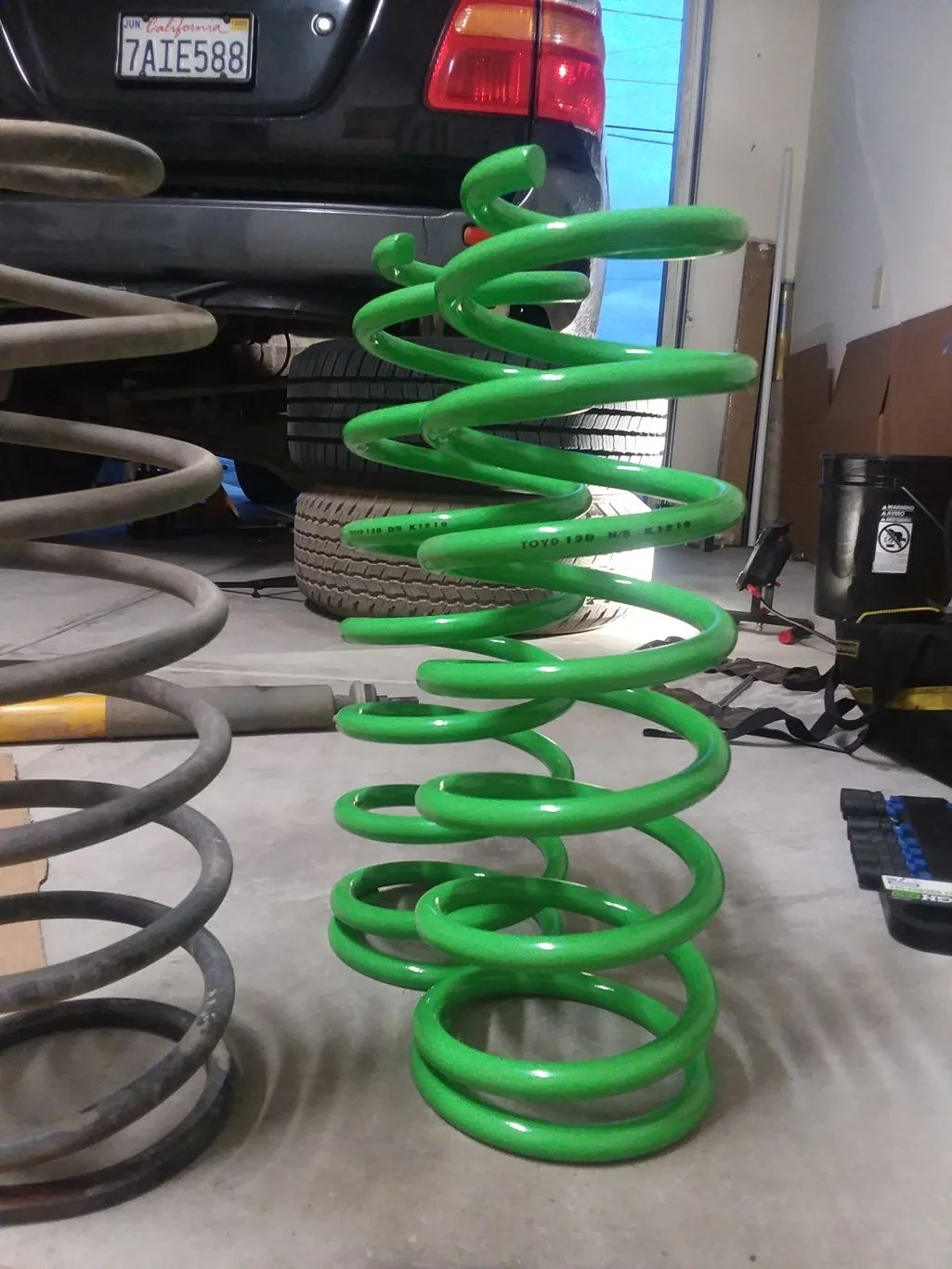

13B I believe. you can read it in one of the pictures above. i think they rate it 0-440 lbs. at the time i ordered i didn't know they had a higher rated one on sale. i also still have the stock rear bumper for now. i could use a little more weight in the rear imo. the springs gave me almost 3" of lift. more than i bargained for. maybe my old ones were sagging. idk.
