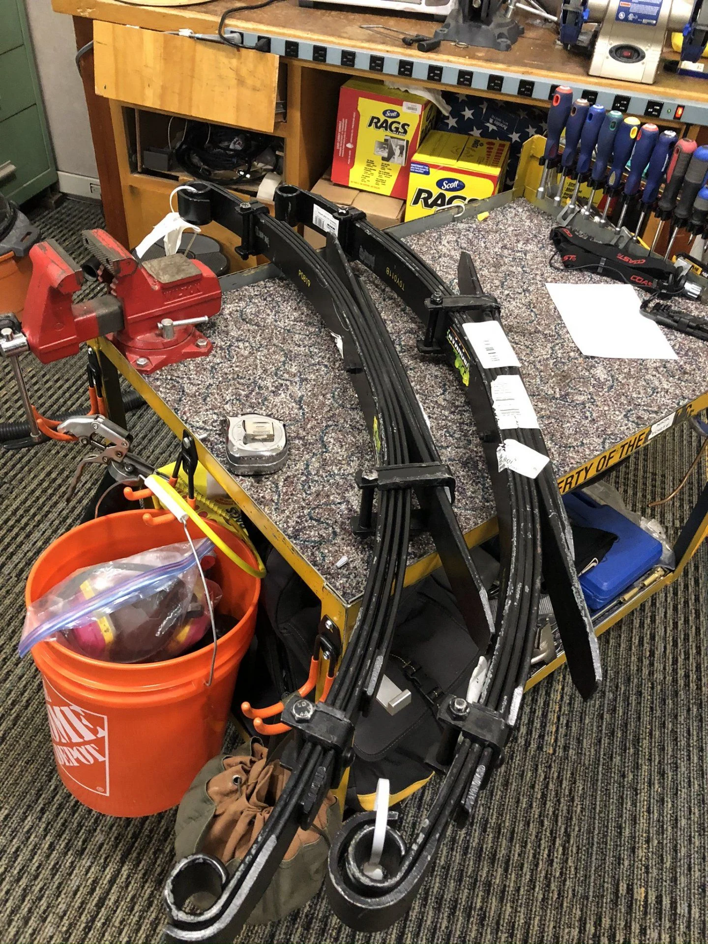

They came super fast. They look tall.... I pulled the big overload off but thinking I need to pull off that baby one. Thoughts? What’s desired for front springs in correlation to wheeling vs hwy driving? My current springs will pull out of the mill wrap which I have to fix each time. These have a bolt so that won’t happen but do I want them to separate for more flex? Hoping these flatten out a lot with weight on then though. Results this weekend.

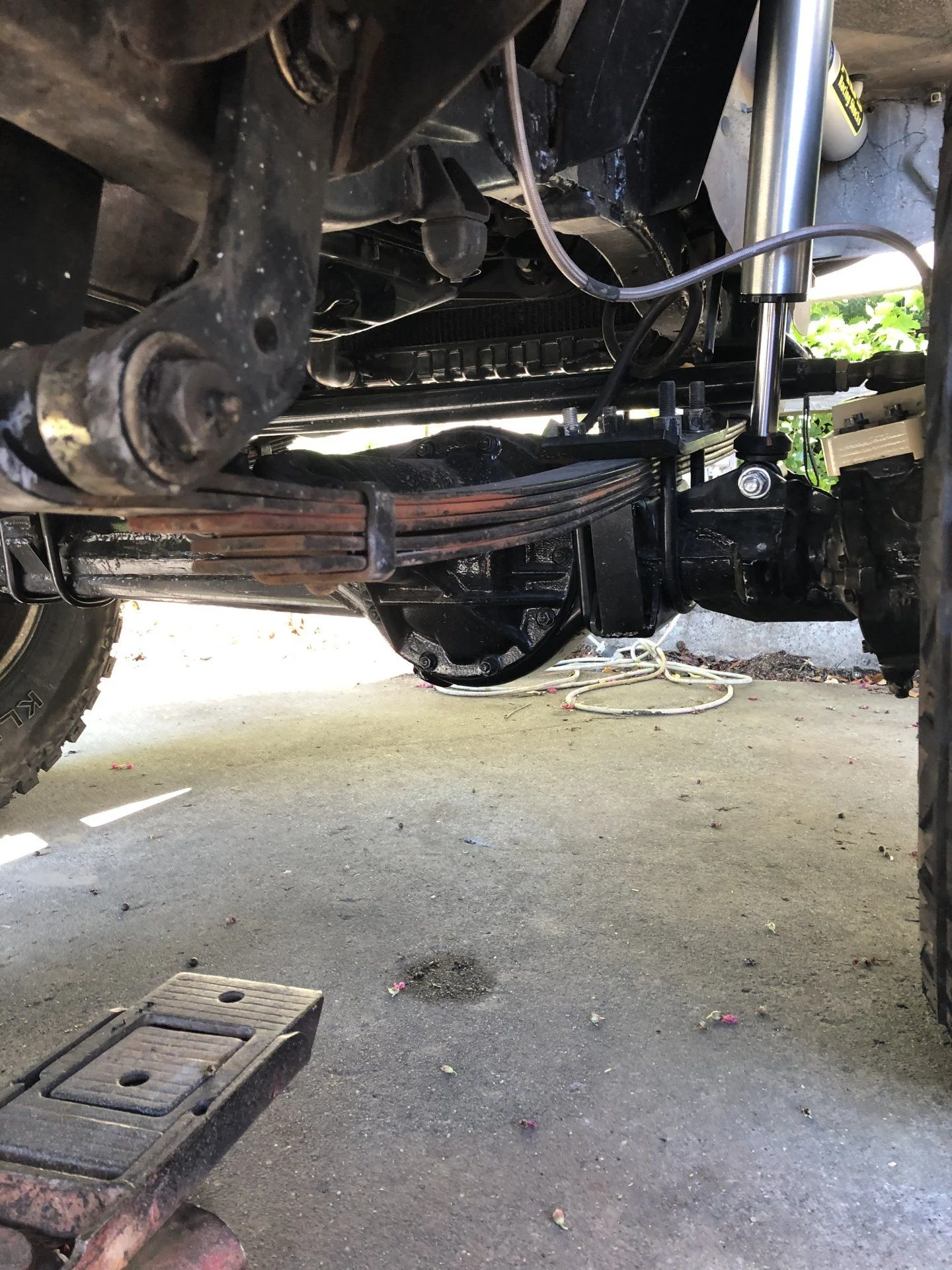

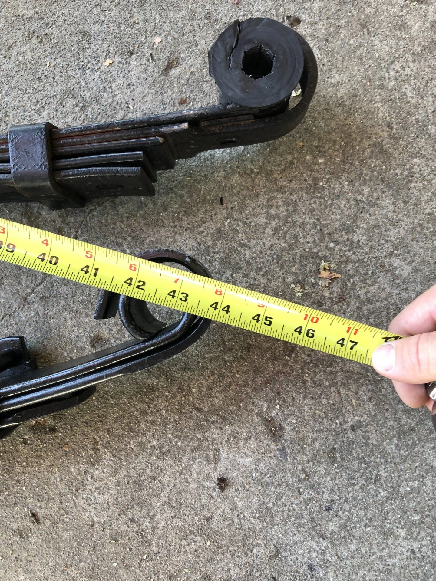

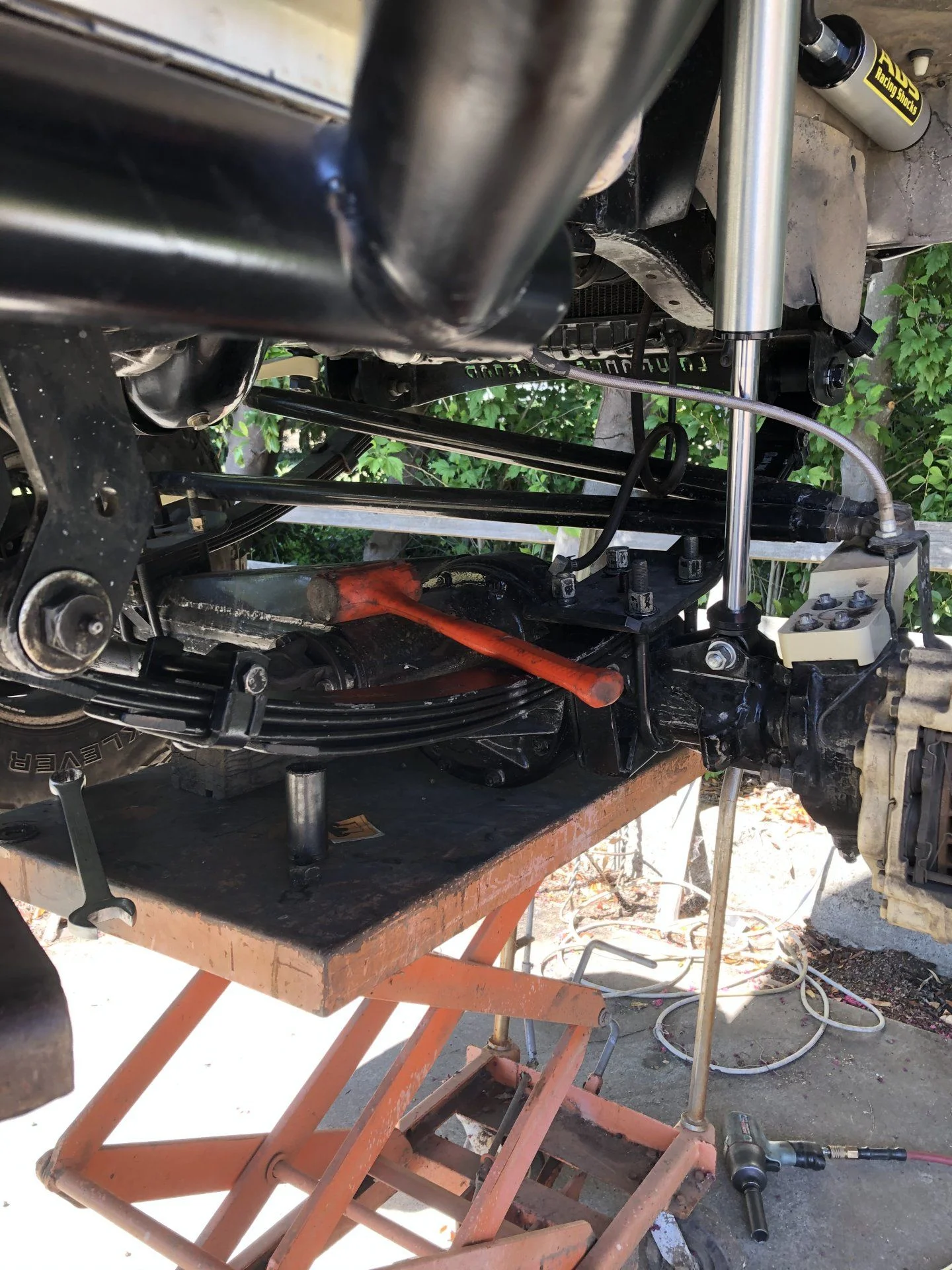

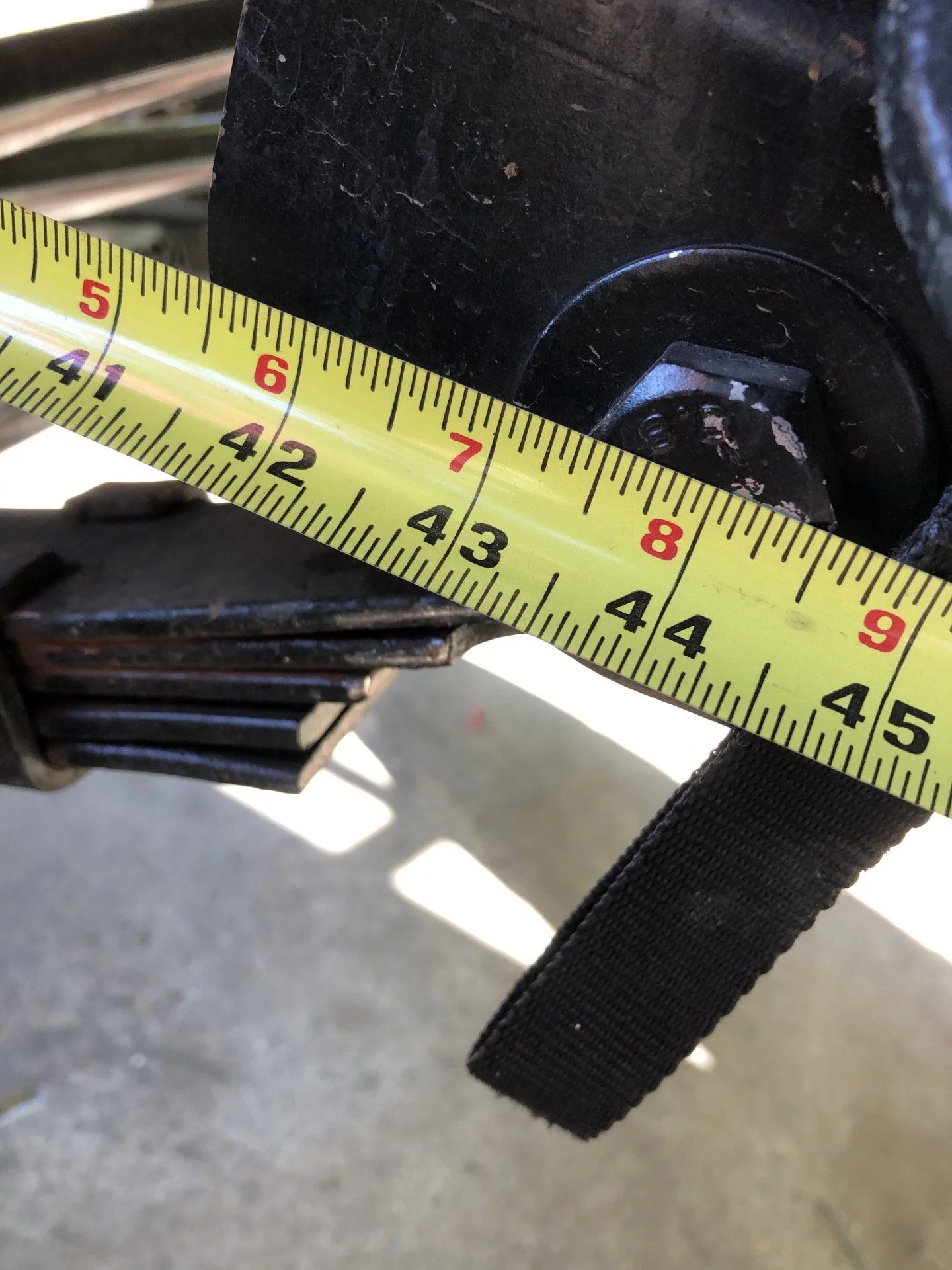

Ok, here we go.... pics are kinda scattered all over the place. I suck at taking pics during install. The one pic I missed was the truck ride height prior to spring install. Overall I’m pretty happy with the results. Figured I’d get jacked up at least an inch but didn’t want more than 2.5-3. End result is an immediate 2.5 inch lift but will settle to >1.5. First pics are my old springs on the truck under its own weight. Measured about 47” eye to eye. As you can see they are flat and slightly dropped. Next two are old springs “fully” dropped (pretty sure my shocks are maxed out) measures 44” eye to eye.

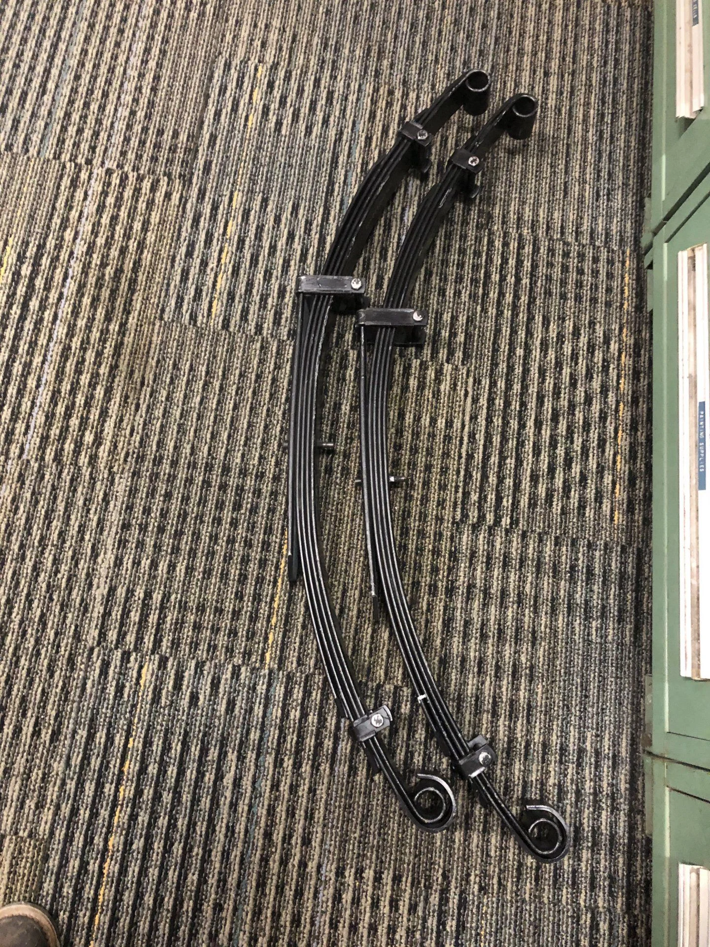

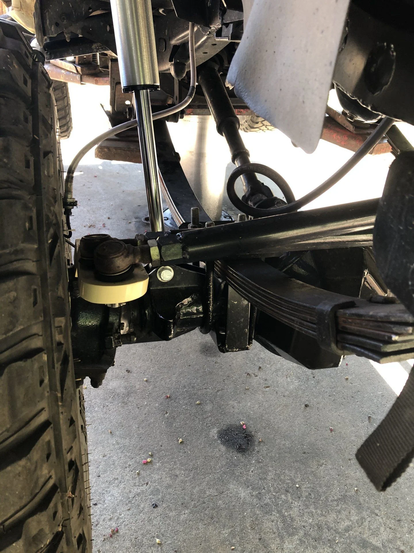

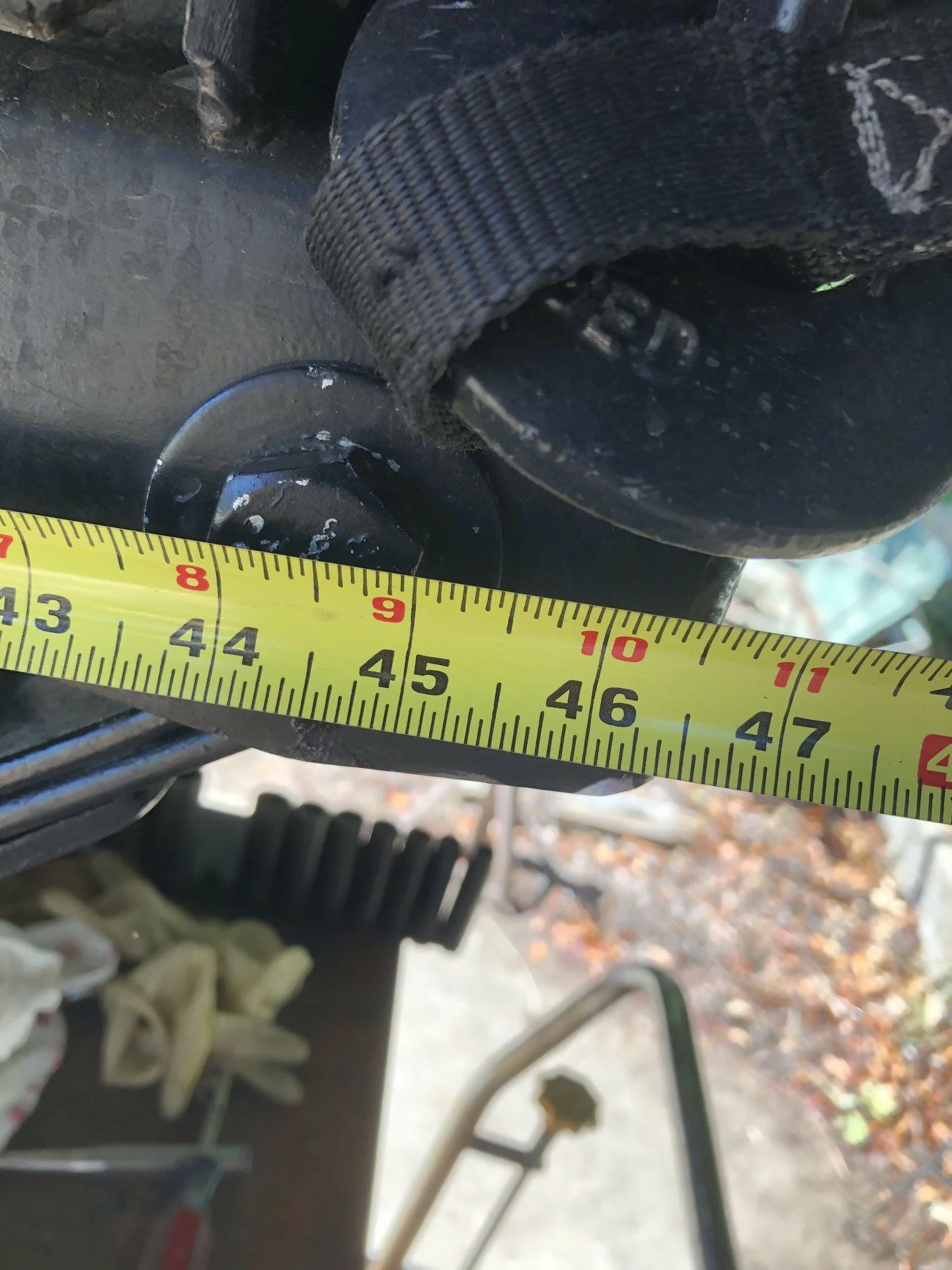

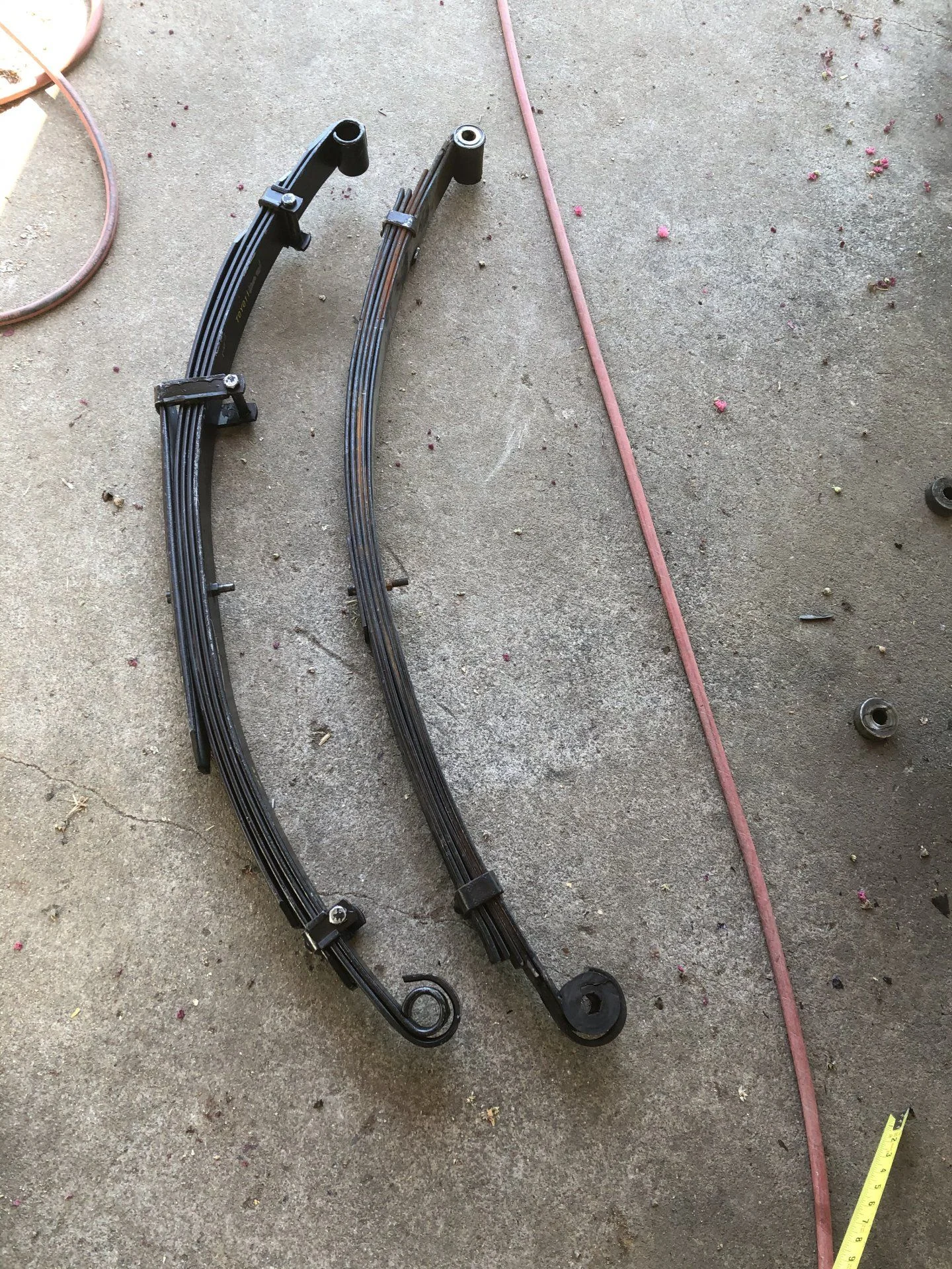

Next pics are of the new springs on the bench. They measure 42.5” eye to eye. Following 2 are old springs on bench. They measure 44.5” eye to eye. Next pics are side by sides of the two springs and new springs installed under weight eye to eye measurement of 44.5”
10” stroke which is a tad too short now lol but those will eventually go on the rear and I’ll order new shocks for the front. Shackle angle kind of sucks... I have 6” boomerang shackles and they are vertical. I can take pics of that tomorrow. When you say frame to frame you mean rear frame hanger to front frame hanger?

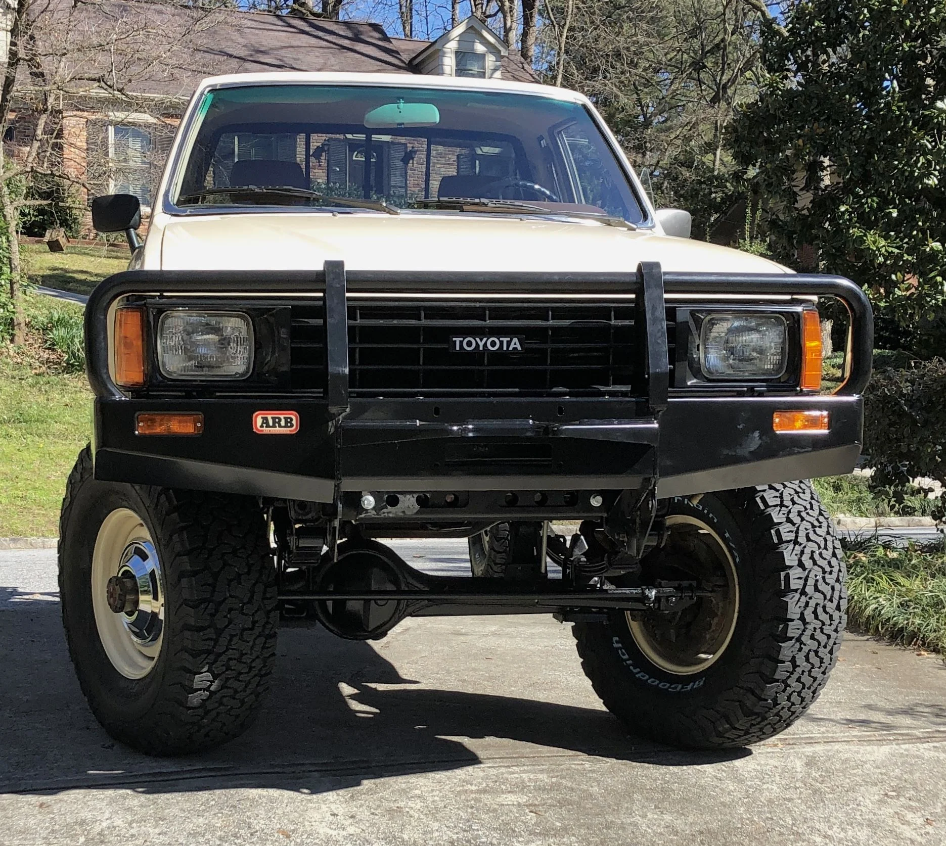

Patty is too tall and too stiff. As the trayback (your favorite ;-) ) is growing in weight, the stance and ride are getting better, but I don't think the finished bed - which will weigh about the same as a factory bed - will be enough. The front end has an ARB and will get a winch. But I don't think that'll make enough of a difference. I foresee new springs at all four corners. Definitely looking forward to your review of the IronMan springs - and how/if they settle down.
That's a lotta air under there...
