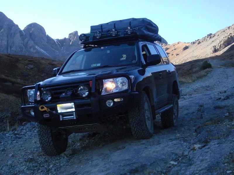

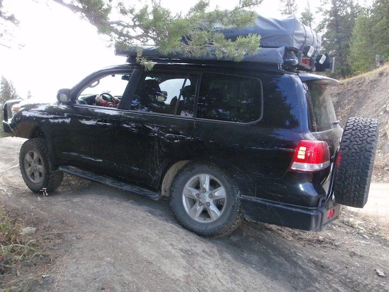

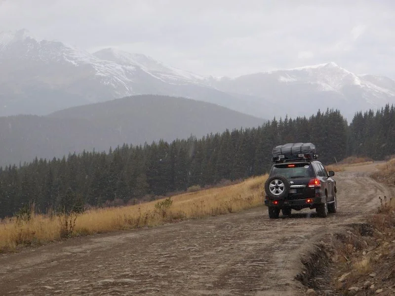

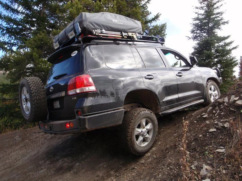

The first 1 is some of mother nature's pin striping.
The last 2 are of the old lady working with the ICON/Total Chaos suspension.

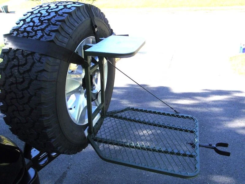

camp stove
who makes the camp stove platform that seems to connect via straps to the rear tire carrier? Do you like it?
str8nm,
The stove platform is nothing more then a modified deer stand. We used it during our Colorado trip multiple times with no problems.

can you explain or give me a pic of the modifications necessary. I am sure I can figure it out, but if I had a picture it may help (as well as having your experience) on picking something out that will work. I appreciate it. By the way, my white 80 was there during your build, we ended up with a lot of the same stuff/ equipment.

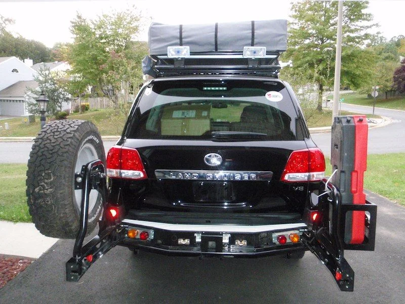

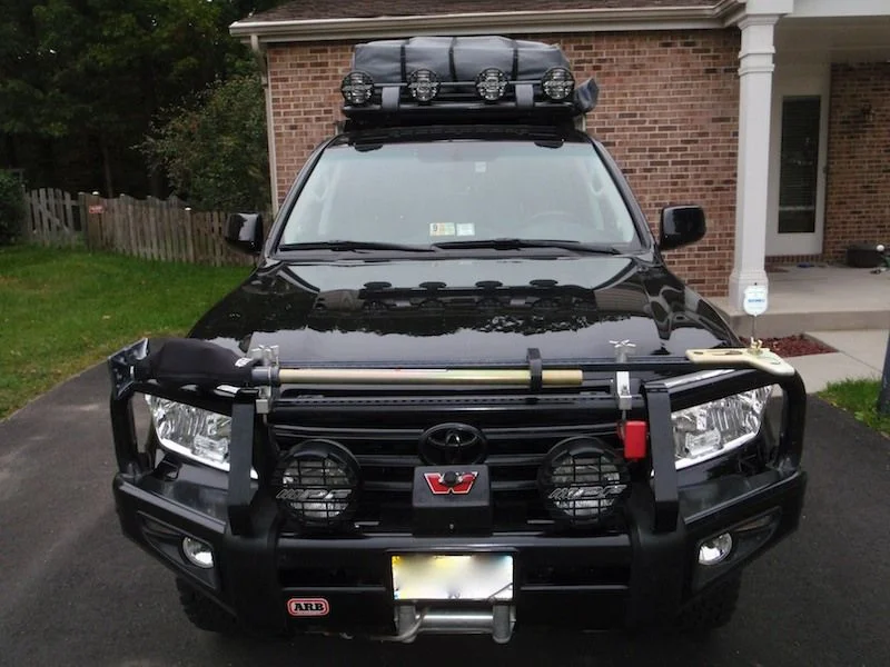

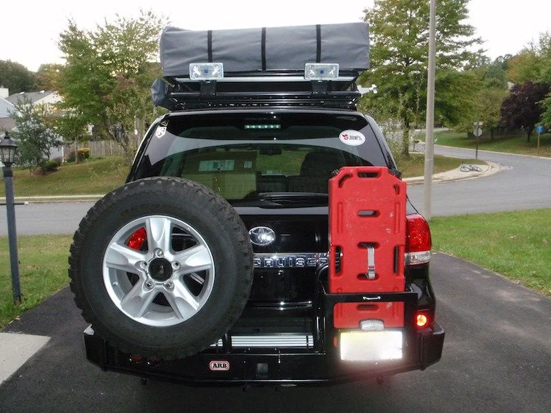

Update #7
We got the jerry can holder mounted and moved the Hi-lift jack to the bumper. The Expedition One Geri cans are a little loose, but with the addition of a spacer I think I can tighten them up.
str8nm - I will get you some pic's of the tire table (deer stand) tomorrow. Was the white 80 with the ARB tent yours?

This is what I did for the tire table (AKA a deer stand):
Only installed one support wire - this allows side access to the table.
Didn't installed the seat material that came with the stand, instead I installed a white piece of plastic to the seat as a smaller table for cooking items.
Zip tied a piece of foam as a buffer between the base of the stand and the tire.
Installed a Bow holder to hold the propane bottle when it is attached to the stove.
Use a second strap to secure the top of the stand to the tire.
I hope this helps, if you need anything else just let me know.

You can get specific mounts for those ATV gas cans. They fit in the slots and you can clamp or weld to your exisiting mount there.

I am now looking at how I can attach the table directly to the spare tire mount rather then the spare tire. If you have any ideas I am all ears.
Where can I find the gas can mounts?

this is what I did on mine, except I use a metal basket instead of your flip table.
I think I will add the table though, it's a neat idea.
the ATV gas/water tank mounts are kolpin (or several others have some). That's what all those pill-shaped slots are for in the tanks.
