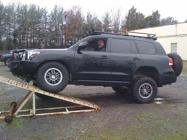

I just had the 17" TRD rims and the Nitto Terra-Grappler 285/70/R17 tires installed and from what I was told no problems. Here are the pics the wife sent.

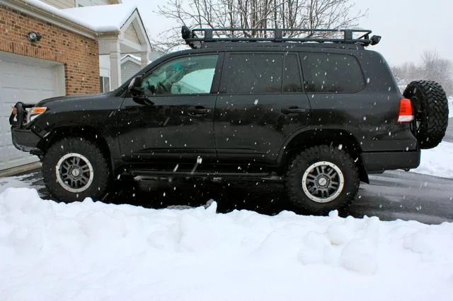

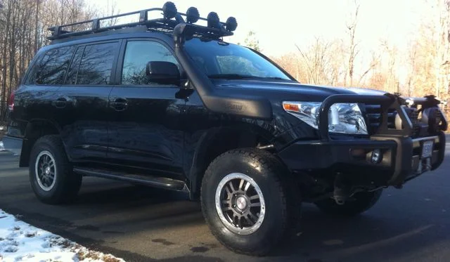

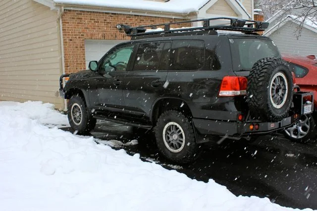

The wife just got the 200 back from IPOR after having the Toyo Open Country M/T 285/75/R17's (34.1"x11.6") installed.
She said the only issue is a slight rub when the wheel is at full turn, but that's something I will have adjusted once I get back.
sbly

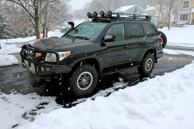

Some observations after finally getting to drive my truck with the new 285/75/17 Toyo MT tires.
1. Their is an small increase in road noise but that was expected.
2. We had to cut the front mud flaps to eliminate rubbing with both front tires.
3. After cutting the mud flaps the only rubbing happens with the wheels at full turn to the left, the tire slightly rubs on the KDSS bar.
4. When the rear tires are at full articulation, they rub on the rear mud flaps.
5. When the front tires are at full articulation, there is no rubbing and you can still get a hand between the tire and wheel well.
6. Overall I am happy with the new rims and tires.
