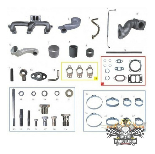

Those are the Kits. But those are not really Plug-n-Play, there is a lot of adjustments to be done. But basecally they work well. The Kits here come with a .42/.48 Turbo, sometimes a local manufacturer or garrett. But I think a K16-Charger would even be better.
The OM364 came as a OM364A or OM364LA Version (with turbo or turbo/intercooler), so there should be more parts avail. The original engines with turbo had a piston cooling. With a little bit of additional power, it should work without. But if you're looking for the 120-140hp-range, there are maybe more modifications necessary.
