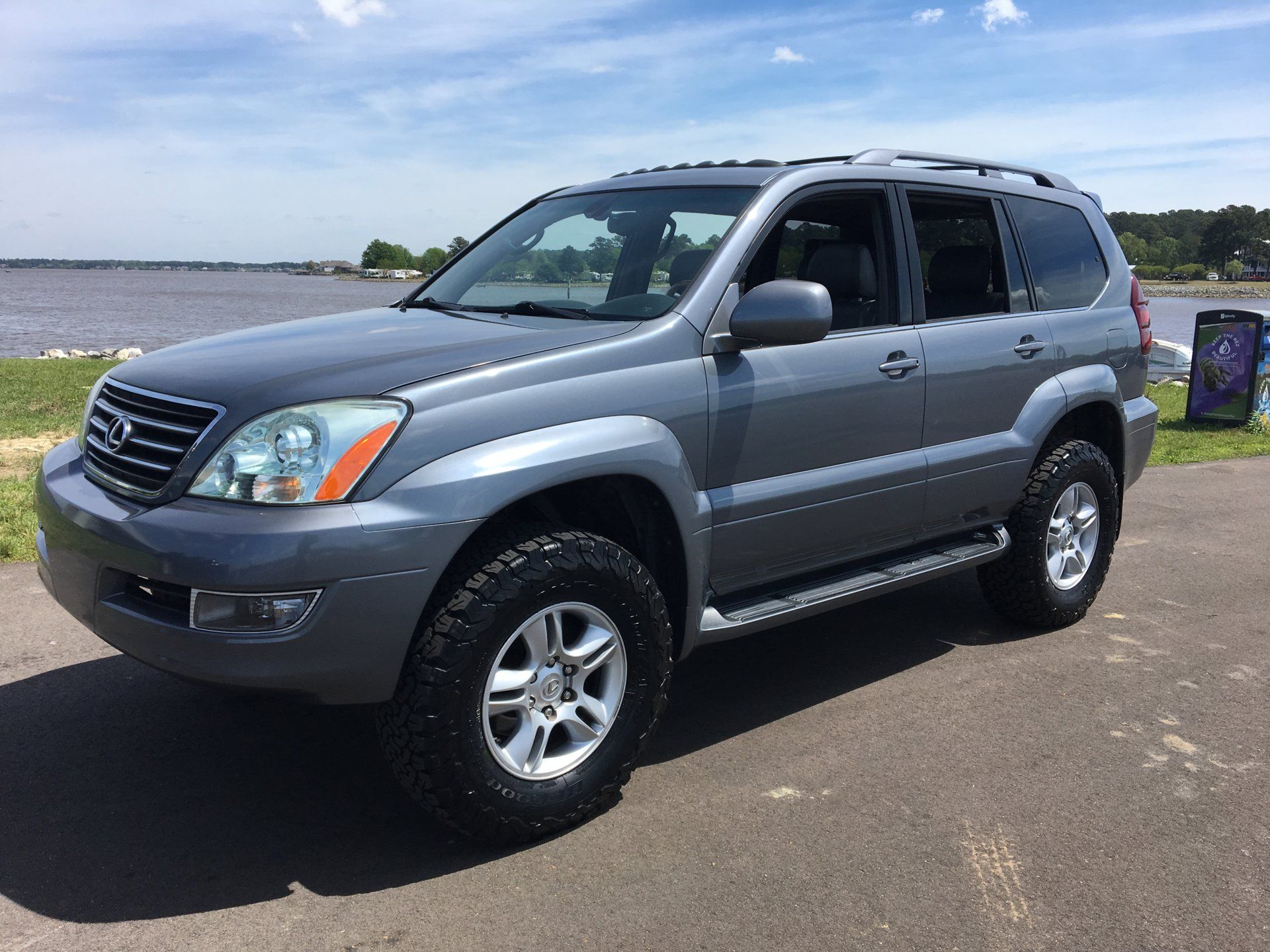

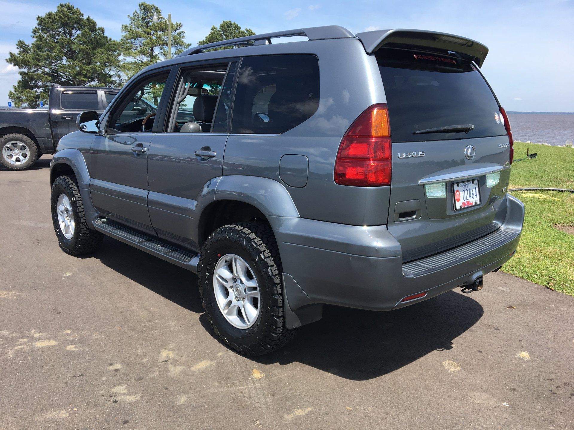

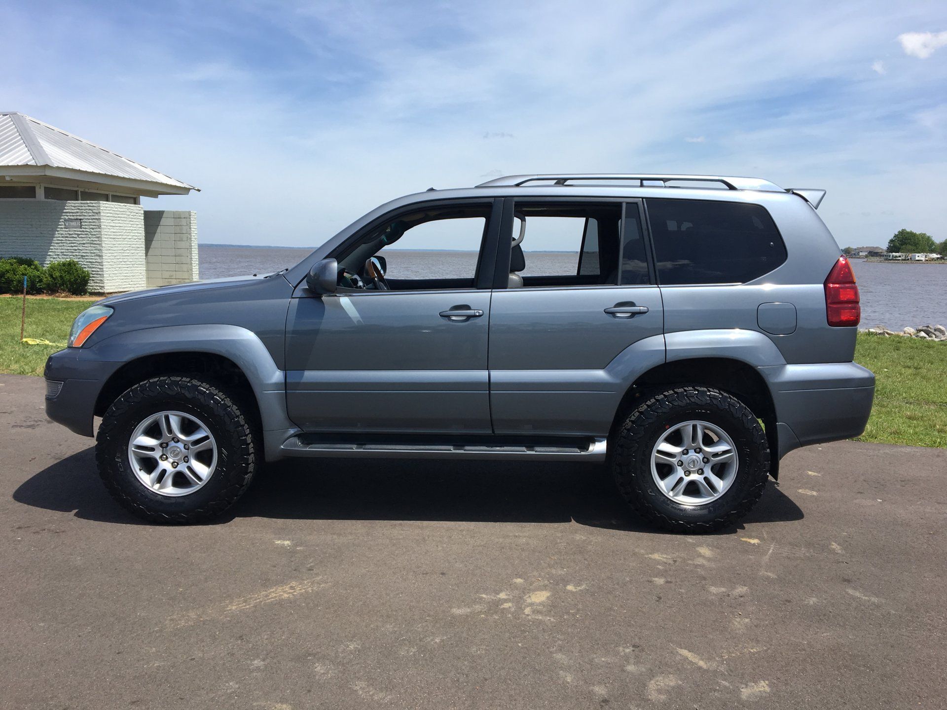

So after a month waiting on the OME lift it is finallly done. 1.25 spacers on stock rims and BFG KO'2 285/70/17.
Basic lift, bigger tires, and you are ready to hit the trails. It looks nice. Remove running boards and cut rear mud flaps to gain more ground clearance...if you need clearance that is.
@slowhogg I actually like the look of a lifted 470 with the stock running boards. It doesn't look too buchered. That may be due to not being a youngin' any more. although if you wheel a ton, removing them, as @HomersCanyonero suggested, will net you better reults.
I'm also partial to the color :cool:
Agreed, I'm 51 and I would/will remove running boards if needed but I live in the deep south, mostly mud around here...no rocks!
Like the color as well, very similar to the slate on my 2008 tundra............
