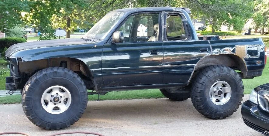

I've done a bit, so far front inner wheel wells are all but done, modified the filter housing to run a cone filter, reconnected all of the relocated harness and got it back running. Now I can't stop driving it to finish. Pic is me driving it home frome work.

Now it just needs an 80 hood hinged in back as a hard tonneau cover ;)
Ok maybe one of these between the turns too
Hell yea. I need to get mine inspected so I can experience te joy of driving a dieted 80. I've cruised it around the back roads and it is comparable to my stock 2010 fj cruiser. Although the (practically) straight pipe makes it seem faster than it is.
I also did the ABS/LSPV delete and on dry pavement the thing stops too quickly. It's going to take some getting used to. No more starting to brake a 1/2 mile before stop signs.

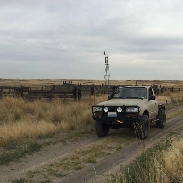

My single cab is 5100lbs, with a beefy flatbed and armor/winch/steel wheels.
That is heavier than I would have thought. Steel wheels and 35s are heavy. Any idea how much the bed weighs? and what it's made out of?
Not sure on the weight of the bed, but it's heavy duty. The bed has a steel frame with C channel cross members and a wood deck.
I've also got an IPOR skid, fwiw.

For context: front axle weight was about 820 lbs. more than the rear; while this isn't a perfect representation, even if I took the flatbed off the rig she'd still be pushing 1.5 tons up front. (again, this is with an ARB, M12000, IPOR skid, ARB steps, and 35's on steelies).
The 1FZ isn't light, nor are these fully boxed frames and the rest of the beef.
