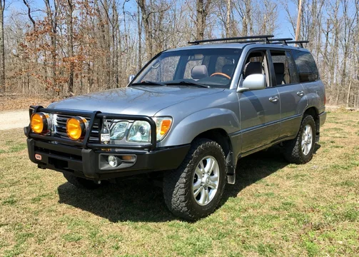

Same here, vapor blue metallic. Similar weird color. I haven't done bumpers yet, but if you get rid of the running boards, lift it, get some 33s or 35s, and get some better wheels that widen the stance a little, I think they can look great. Here's mine:
What wheels are these? And are you running 285 STT's? They look awesome.
1-inch spacers from Slee
Sliders to replace running boards from who-ever
275/70r18 BFG Radial AT K02 tires
