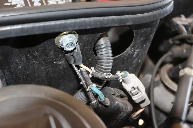

Fusible links; the cluster of 3 wires just aft of the positive terminal. They can look good but become brittle.

I would definitely change the fusible link. It is simple fix and can be the originator of much anguish. In the US, it is about £16--likely much higher where you are located. It is a 5 minute process to change it.
