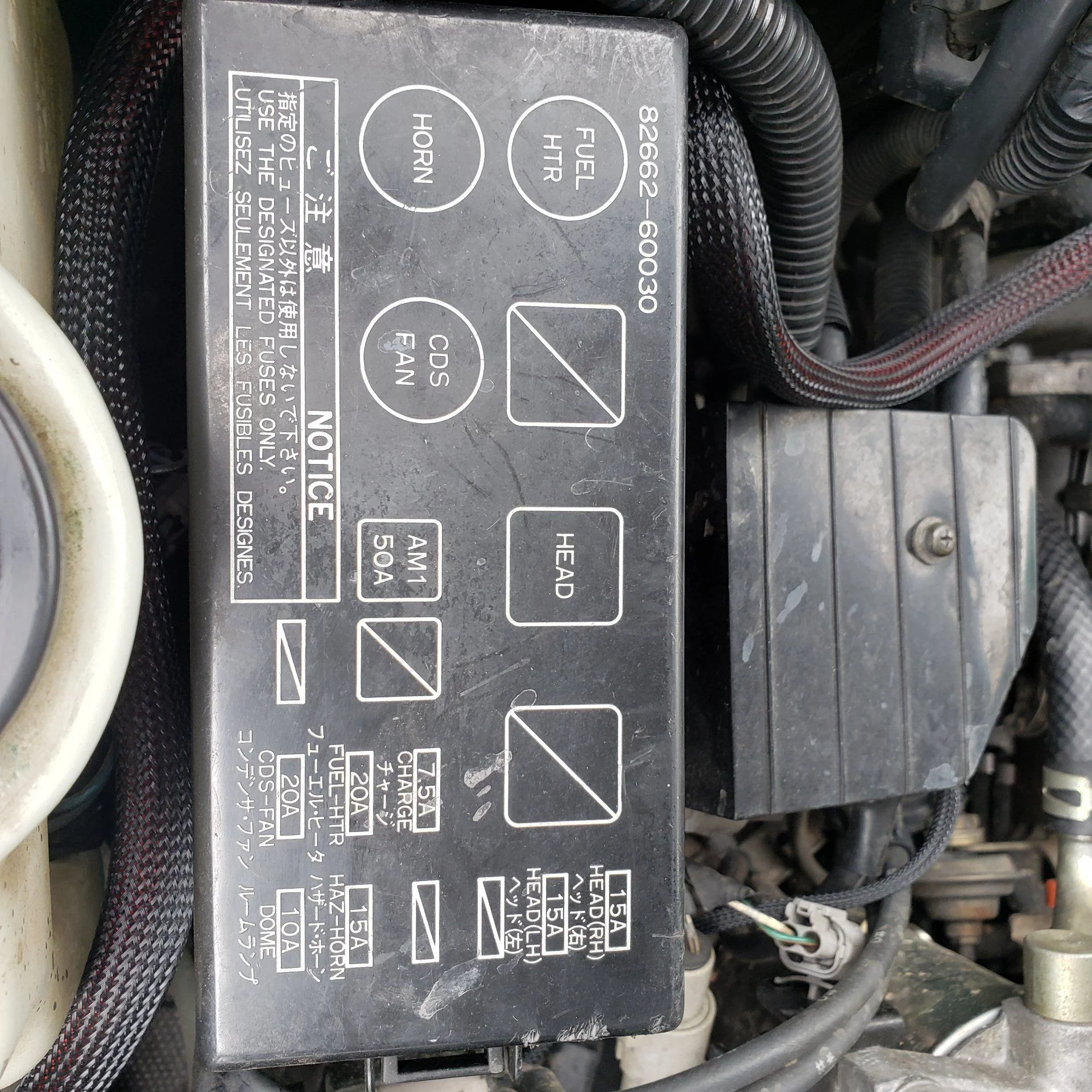

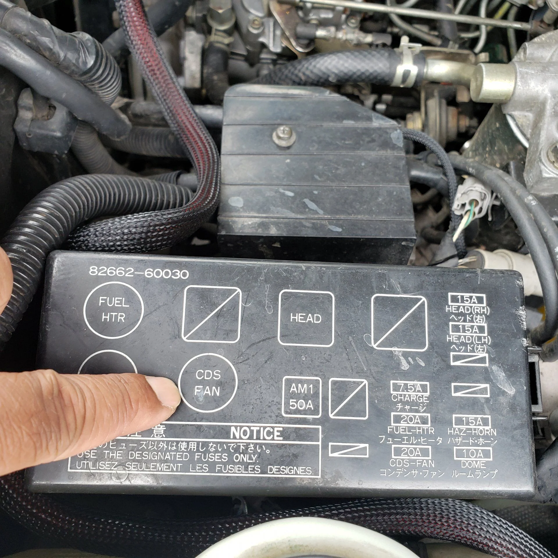

I was under the impression the "CDS Fan" was HVAC related.
CDS meaning condensor.
My HDJ81 does not have this feature.
The CDS fan and associated circuit was for certain markets. The US spec 80s never got these, with a host of other goodies that we missed out on.
It is an aux fan that is mounted on the US passenger side of the condenser and fires according to the AC pressure switch IIRC.
