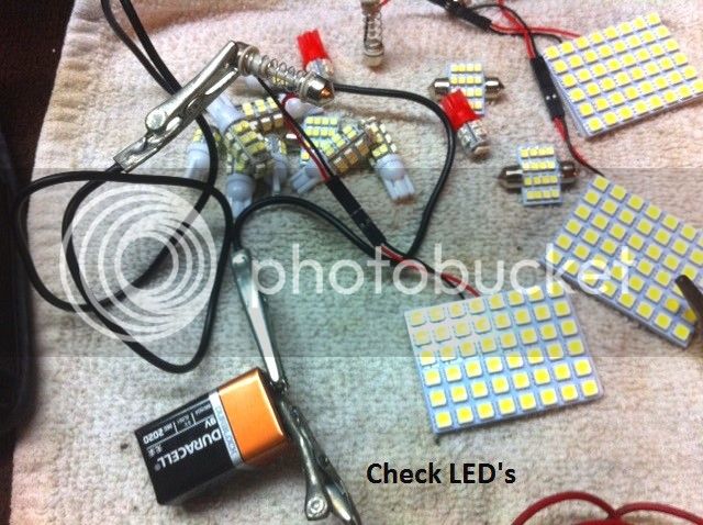

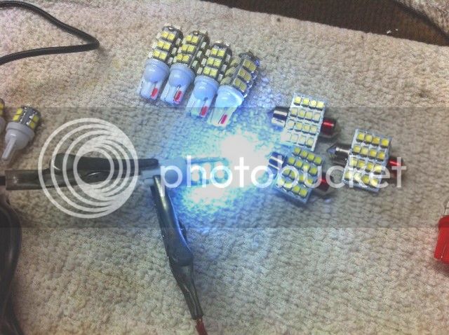

While awaiting my answer....I went ahead and tested each bulb (9 V battery and leads) and marked the polarity.
All of them work fine. Knowing the polarity isn't essential, if the bulb doesn't light up....just flip it around, but what the hell, I had a red magic marker sitting there, so I just marked the hot lead.
