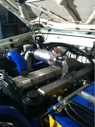

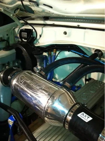

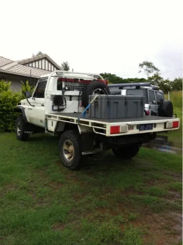

Hi everyone ! I'll reply to posts shortly ! Wow this is an awesome kit! Ended up fitting cooler behind the tray! The cooler remains extremely cold! The fan has some serious power behind it too! It's noisy! The fan is activated by a hobbs pressure switch so when under boost the fan starts running, not keen on that idea I joined the wires together so it runs as soon as you turn the ignition on!
As advertised on the website I can honestly say 15/20 % more power, down nearly 100 degrees on piro, less down shifting and a heap more black smoke so it's running cooler, the pump will be removed tomorrow and sent away for a new top and aneroid fitted, will find out what the link is and post it up for you to see!

First time I seen an intercooler mounted at the rear. Usually its the radiator........not unless was actually intercooler...lol.

Any pics of the water hoses running under the ute there

Yep no stuffing around..... Sooty needed to be finished before today as the pump has now been removed, and wanted to drive her for a while prior to the pump coming off, I had it dynoed again today. I originally planned on front mounting the cooler but I couldnt make it work with the limited bits and pieces I had to make brackets etc. it ended up on the back of tray and ive cut out the running board so it can suck more air. the fan is fantastic, it really does pull some serious air through it.
Im no expert when it comes to intercoolers but what many supposably experts have told me is that air to air will generate overheating issues. more plumbing so more lag etc. I decided on air to water because it made sense to go this way over air to air, AXT had a great kit that fitted up to my turbo very easily. the difference was very noticeable after the fit up, the tank and barrel are made by PWR, I believe PWR make a good product here in Australia , i have fitted there alloy radiator and havent had any problems, it also adds a fair bit of bling to your truck if you like that.
sorry I havent got dimensions for you. I will do it when i get it back. I fitted it up then remembered I hadnt measured it up
with removing the bars, cleaning and repainting the front behind the grill, fitting intercooler, going out to buy more heater hose and testing took me 22 hrs. I didnt it pretty much in one hit then died the following day LOL
I'm still tired now, it was a big job, the diesel mech ive been chatting with was pretty impressed as he said 90% of people who buy an intercooler through them bring it back in a box and ask them to fit it up. there was no way they fitting mine at $1000............

for anyone who is interested the fan is 12" Davis Craig and the pump is a 20lpm bosh pump. the fan has some serious balls behind it.

I see some issues there. There's no way to burp the air bubbles out of the top of the intercooler.
Do you have a coolant gauge for the intercooler? I'll bet up a long grade, especially if you were hauling a heavy load, you would get the coolant past boiling and blow out a line or coupling, hopefully before you blow out the radiator/cooler.
I think you need a sump with a cap that can blow off steam, ideally above the level of the intercooler under the hood so you can get rid of the air bubbles.
I have the same problems in my tow rig. I need to do some rework to mine.
I do like the little radiator/fan. I'm planning to get a bigger one than that from a small car in the junkyard.
The Northside 4x4 intercooler has the fill cap on the intercooler itself. Apparently it's far easier to bleed the system of air
