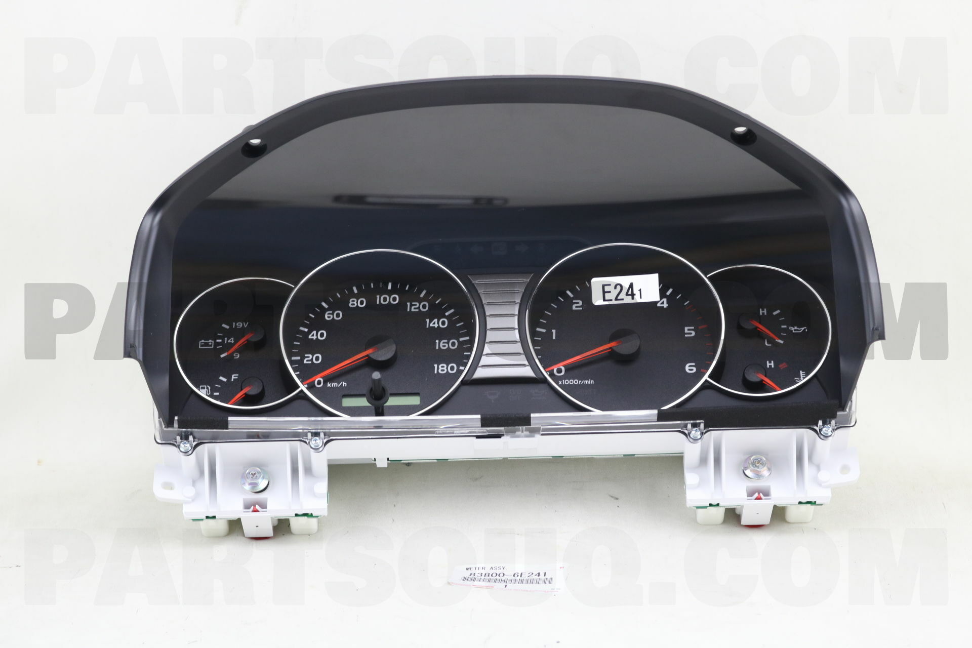

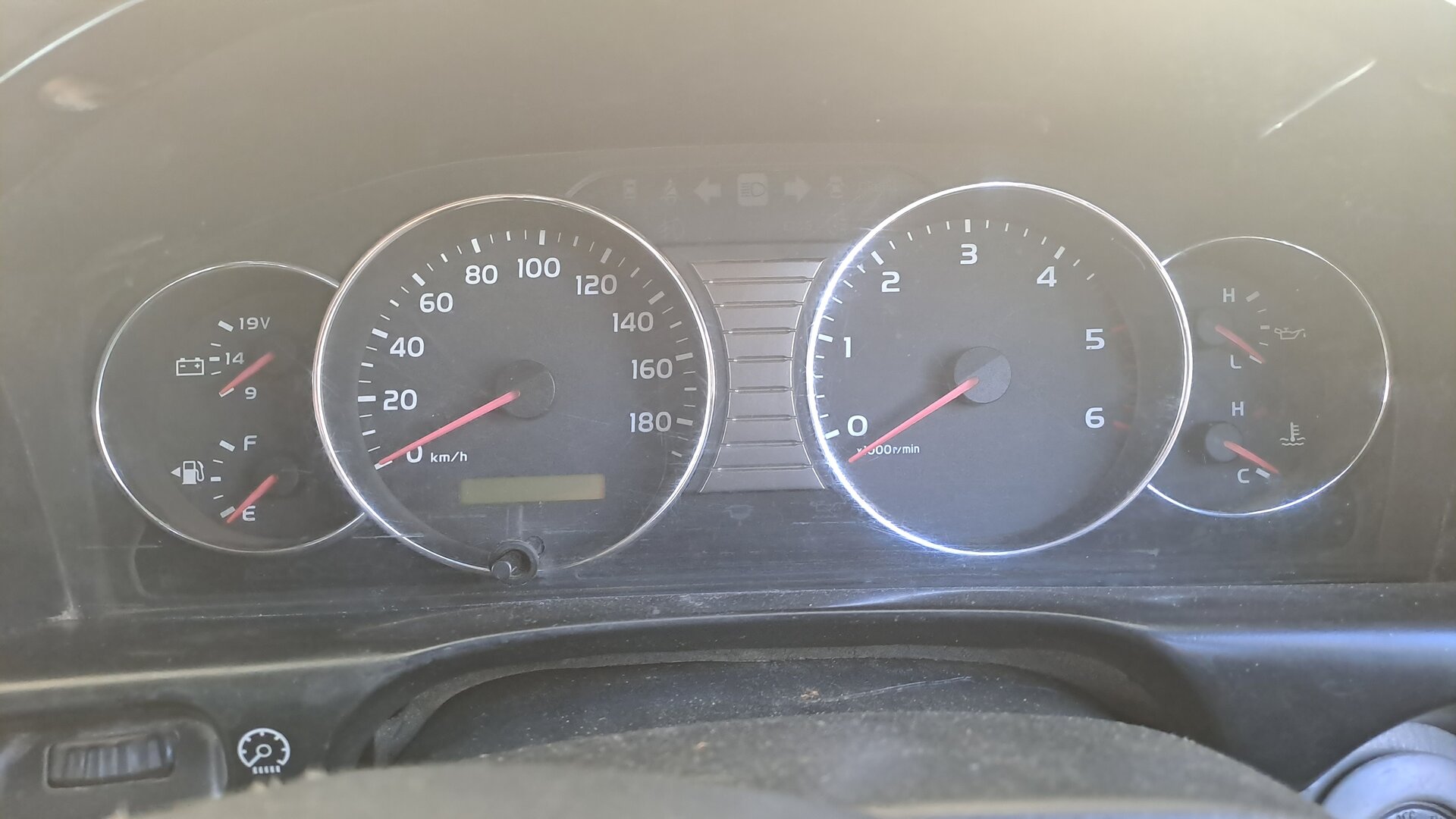

I am desperately searching for the cluster pictured. It's to suit a 2004 HZJ105R, manual, 4.2. Standard barn door model. Vin Jtecb01j501017199. Part number E1883800-6E181 or E1883800-6E182.
The part number you are typing is incorrect. The actual part number is
838006E241.​

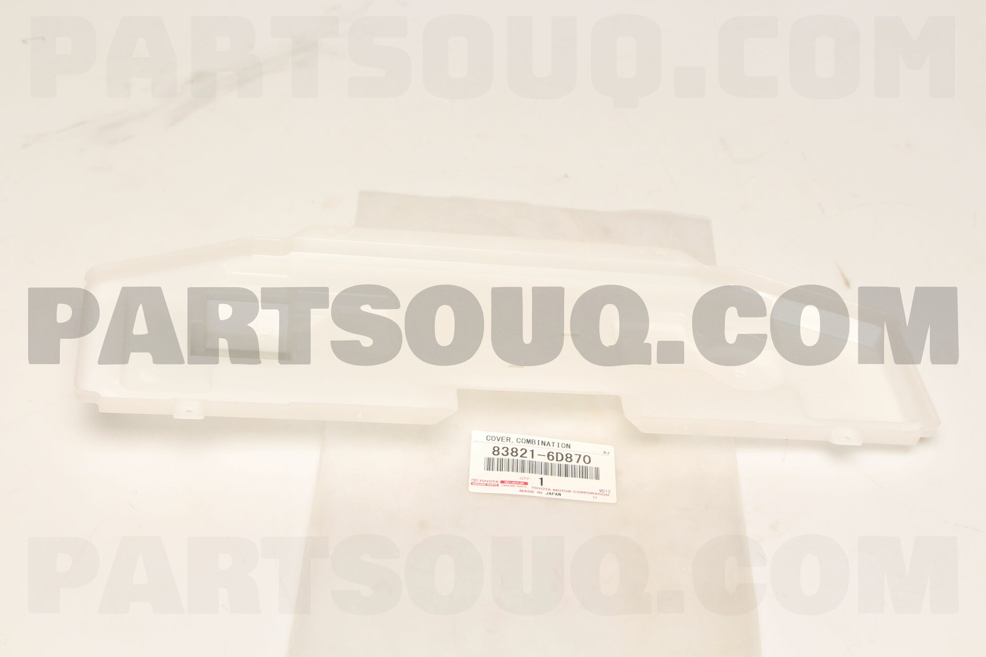

There are plenty of these in stock for sale. Partsouq has two in stock. Keep in mind. These combination meters come in two parts. You have to buy the clear lens separately.
Part number for plastic lens is
838216D870​
Link for purchasing Lens
Link for purchasing Combination Meter
Hope this helps!

Can you give me further information on the part number you provided. What series and models does it suit?
I ran the Chassis number of my car and the part number I gave you was from my 2005. Which is UNO Auctioned 2005 1HZ Diesel. Mine is 2005 and yours is 2004.
From the looks of combination meter 2005 and 2004 don't look different. But I don't know what type harness connect yours have on the back side of the meter.
Worst case scenario if the harness connector is different, you can still re route wires and make it work.

The auto sparky said it has fried the microprocessor, and not worth repairing. The previous owner, decided that he would do all his own accessory wiring, and it's caused major electrical problems. I have just spent $2300 on auto electrical work, to get the car running again

I found some further information earlier today, that lists the part numbers to the car's that they were fitted to. It shows that the part number you quoted, and the 2 part numbers I originally listed, are all suited and used in the same model car's. Those being 83800-6E181 83800-6E182 and 838006E241, all used in HDJ100,HZJ105,UZJ100, 1998-2007. I don't know how accurate the information is, but it broadens my search.
I ran the part number in toyota diy website and it shows that the part number available for sale supersedes part number 83800-6E182. Good news for you. The part available for sale will work in your cruiser.
Thank me later!

Ok here is an easy one. If your part number (2004 cruiser combination meter) that is not available and out of stock can work in my cruiser which is 2005 cruiser, then surely my cruiser's part will fit yours without any problem.
I typed in the part number that is out stock for your cruiser and it showed that the out-stock part will work for my 2005 cruiser as well.
That means my cruiser's part which is already available in stock must work on yours also.
I can't give you 1000% guarantee. But I am 99% it will fit your cruiser.
