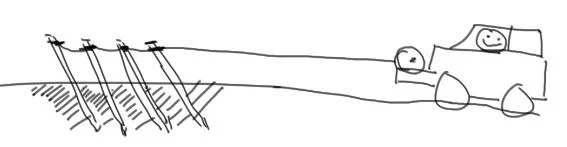

here's something i've seen that is similar where they tie several together in-line to add more grip.
That is the principle behind the "pair" of shorter ones I made for my neighbor.
Attachment point of the winch cable needs to be close to the ground however (and kept there).
In your rendering, you are losing the mechanical advantage, but..yes you can add as many as you like for increased anchoring ability.
