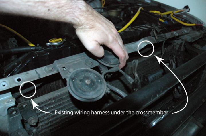

Step two: Completely remove the crossmember bracket that is in front of the radiator. While reading the instructions I had no idea what this part was and what bolts I needed to take off. Once I figured it out, then it became a little more obvious. This requires a 12 and 10MM socket to remove the necessary bolts. If you live in a rust prone area I would recommend spraying your favorite rust penetrator onto the bolt heads before hand or else you run the risk of breaking some bolts as another member just learned. There are a few little brackets attached to the crossmember that need to be disconnected as well. These are moveable (they swivel) once the bolt is removed so take note of these. While I was taking the two bolts from the latch mechanism I learned that you do NOT need to disconnect the cable and I learned that you do NOT need to try and remove the plastic that covers it because there is a third bolt hidden underneath. Once the latch is off then you will see the hidden bolt for another support. Once this is removed then the entire crossmember bracket will be able to be lifted.
Step Three: now the crossmember does NOT need to be completely removed but instead just lifted up. You will need to lightly force forward the plastic grill attachment so that you can get the lip of the crossmember out from under it. You COULD try and route without doing this but its just so much easier once its up and out of the way. Doing this will expose the existing wiring harness, it exposes the path by which you will run the new wiring harness and, for me, it exposed the pathway by which I am going to run the new battery cables needed for my dual battery install.
Step Four: Starting from the DS of the truck (93-97), start pulling the PS side of the new wiring harness through the same route as the existing wiring harness. Make sure it follows the same path and that the harness isn't in front of the hood latch cable or horns. Just follow the same path. Once you pull it all the way to the passenger side, you will see the opening to go into the PS of the fender. Pull it through so that its just long enough to reach the lights and then some for slack. Once you are sure of where the harness should be, go ahead and grab the hi and lo beam lights, tab some dielectric grease in the pigtail socket and install the headlight into the socket. Once those two lights are attached to the harness and then to the housing, you will see where the old wiring harness ground is. Its on the left side inner fender well. Its two wires connected by a bolt. You will be attaching the ground to this same spot. Take the old light connectors and use electrical tape to cover the sockets and then stuff them into the light housing.
Step Five: Now you can go ahead and start using some real zip ties, not the ones included in the kit, and start zip tying the new harness to the old wiring harness. I used two zip ties under the crossmember, one on the PS and one on the DS.

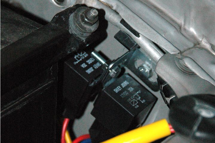

Step Seven: In the little baggy you get with the kit is three useless zip ties, a bolt, a nut and an "L" bracket. Now this was a real head scratcher. Mainly because the instructions failed to mention this and I had no idea what to do with it. After staring at it for a good 15 minutes I figured it must somehow all fit together. So I looked that the wiring harness for the relay connectors and they are really close together. Ok so the relays must be close together too. What if I..... BINGO! You can see in the picture how I "assume" they go together. Makes sense to me anyway. Now to add it the to the inner fender...but where? Well there are two spare holes in the inner near where the DS ground is connected. I chose the top one. BUT, there is no bolt to go in there. THIS should be part of the kit. I can't image all the FJ80s not all being the same bolt. Luckily I has a spare one from a project I worked on earlier. Now that you have decided where its going, ATTACH THE RELAYS INTO THE WIRING HARNESS BEFORE YOU ATTACH THE RELAYS TO THE FENDER!!!!
The relays attached to the inner fender well. Yes I know I need a washer in there. I didn't have one handy. :P

Nice. That's the same way I did my relays, but with washers. I bolted mine inside the battery tray, though.

Any how the first thing I am concerned is the location of the relays, they are too close to the battery and it doesn't matter if the relays are sealed but the plugs are not, so the female spade pins can corrode. I would protect them with the same OEM grease used by the vehicle manufacturers.
hey ROBMIR, its funny, I was concerned about the same thing actually but I wanted to keep the relays within the battery box. In the meantime I used dielectric grease on all connectors including the relay. I also thought about adding in a small flexible rubber flap that would cover the relays but wasn't sure if I really wanted to go THAT nuts with it. Hmm, maybe I AM that nuts.

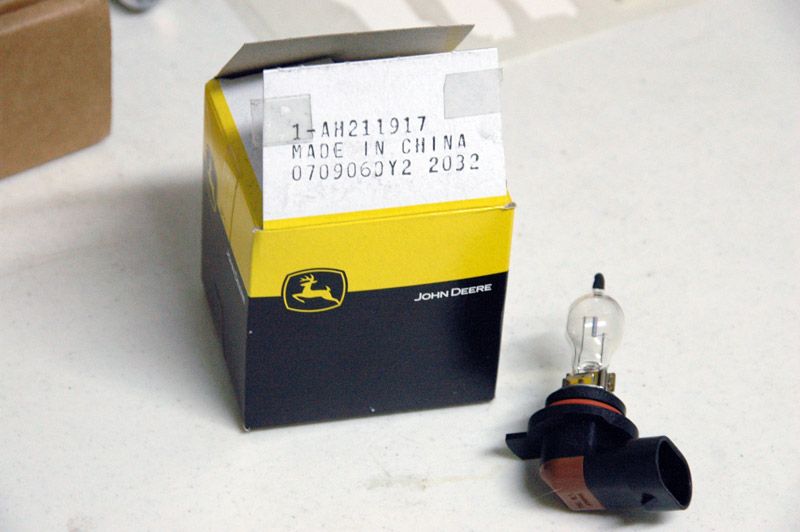

Hey folks, first off thanks for the kudos. Makes it worth spending the time on this stuff. Well here comes the findings so far. The replacement HI beam bulbs I got are the John Deere AH211917, made in ugh...China. They are actually Toshiba 12V55W bulbs. Here is the packaging for it and the bulb itself. Its been shown in a million places on this forum already but I figured I would include it here as well.

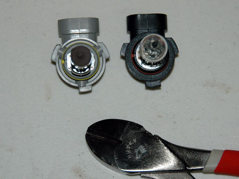

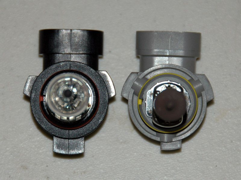

So as you can see, the bulbs are basically identical except for two things, the physical size of the bulb itself (which is what gives it the output) and the size of the rear tab. The JD bulb has a wider tab than the stock light. This is an easy fix with a pair of wire cutters. I trimmed down the overall size of the tab to get it close to the housing, then I nipped off a small piece to get it similar to the shape of the stock light. It does not have to be exact, the light housing on the truck is very forgiving.
You can see from the photos that the light output from the new bulbs is pretty significant. The hot spot is much higher and brighter. The horizontal cut-off remains about the same and there is a wider output out the sides as compared with stock. If I had a light meter I could get you actual luminescence numbers...but I don't so :flipoff2:
