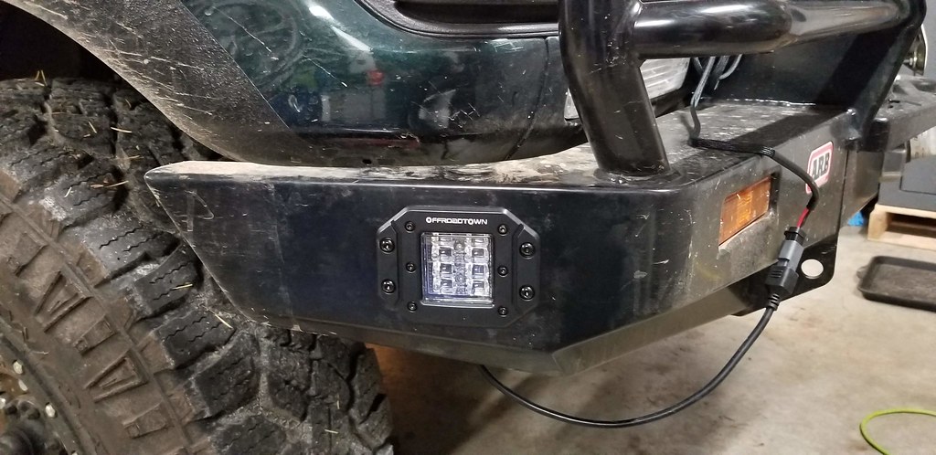

I picked up a cheapo set of LEDs on Amazon for whatever reason, and they were sitting around.
Last night I thought it would be a good idea to cut up my ARB bumper and install them on the wings.

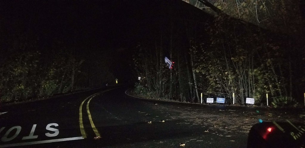

It actually turned out really awesome, and I tested it last night. Having the aux light on the front corners was actually really useful (in a trail scenario).

These are the "Off road Town" cubes. Harness was preassembled (even with relay) and was super easy to install.

Any chance you can grab a panoramic photo showing continuity between these lights and the headlights? Thanks again for sharing!
Sorry everyone. Been moving to TN and been nuts. Used the template that came with the lights, and used a cutoff wheel and sawzall.
