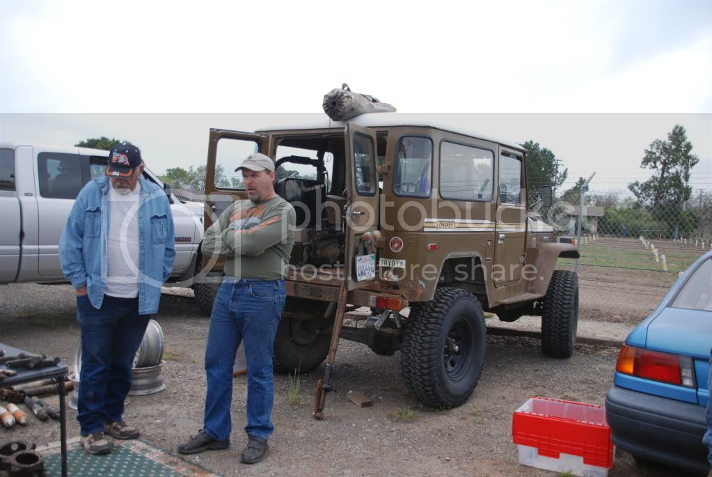

Let me know if you want to take a look at or measure mine. I have an fj60 front axle, outboarded springs and an fzj80 rear narrowed to match. I have steel wheels with 4" backspacing to bring the tires back under a little. I'm still undecided if I'll add some flare when I fix the rear quarters. There's not much tire sticking out. I'm currently running 315/75-16s.
This pic shows how my tires (and my gut) stick out about an inch.
