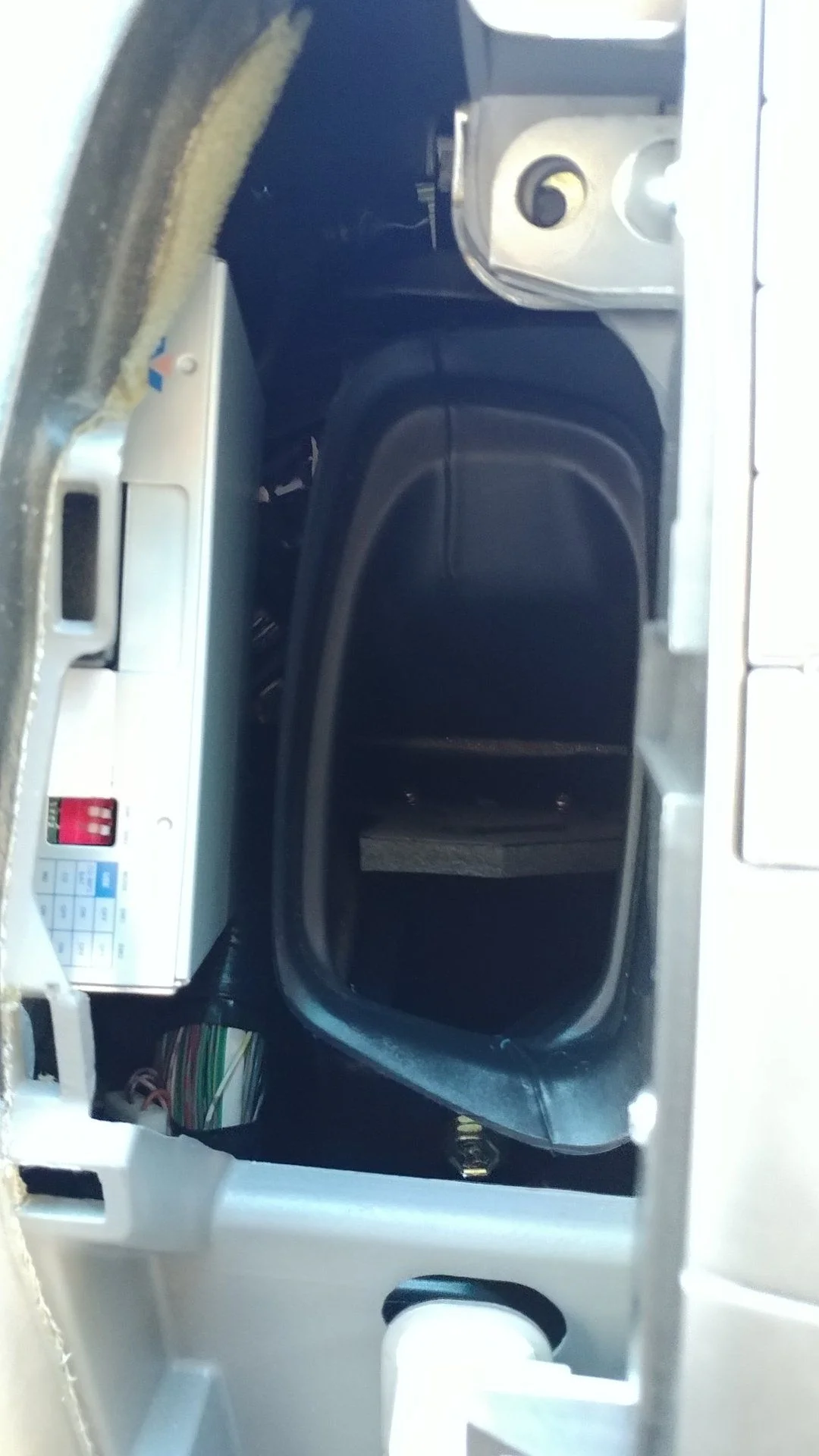

Also wanted to post where I installed mine as my glove box space is too precious to give up for this thing (I wont be using the usb port on it and wont need any regular access to it) and I'm super lazy and didnt want to go tearing anything else apart to hide it. So i velcroed it to a metal dash support just to the left side of air vent on the left side of the display unit. Fit like a champ with cable facing towards the front of the vehicle and routed up and over to the head unit.
