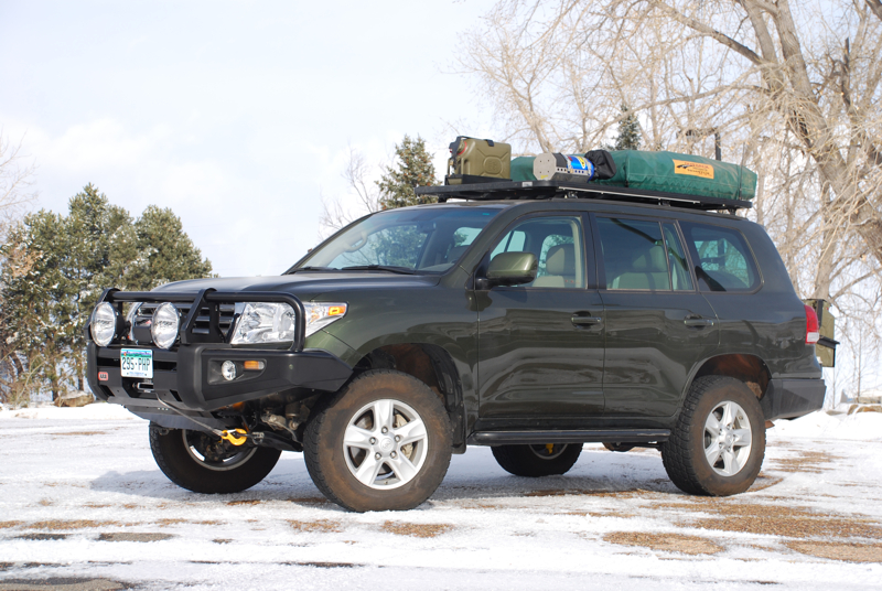

Here is the truck we built. Pretty close to done. We have OME in the front with OME shocks and our own heavy load 2" springs in the rear. Sitting on 33" tires.
Very nice..... Hows that rear bumper coming along? Mine almost done? :p
Christo, looks awesome! Are you going to post some build picts on your website under "project vehicles
"? If not could you post some shots from other angles here. TIA!!! Great work as usual :beer::beer:
I'm surprised no one has stuffed 35's under there yet...seems like there is plenty of room. May need a bit of offset for full cornering.
And yes, all of your rigs are looking mighty fine! I'm just waiting to get the final "best" combo setup before I begin. Thanks for being my guinea pigs! :cheers:
