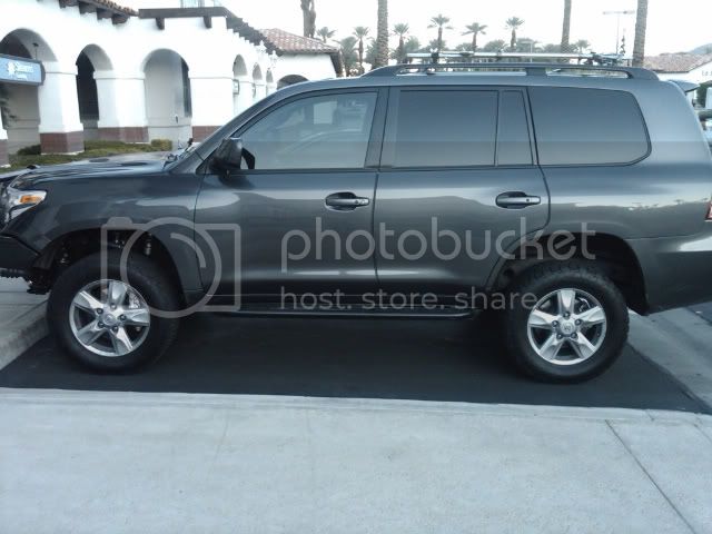

Installed OME rear springs and Radflo Rear Shocks..WHAT A LIFT!
Oct 30, 2007
148
2,022
Southern California
Well subject says it all....here are the specs that changed.
The rear increase 2 3/4 inch and then we raised the front coilovers for another 2 1/4 inch front lift....what a difference!
Here are some before and after pics:
BEFORE:
AFTER:
If I had this clearance in Anza-Borrego , I would not have any rear bumper damage!! Also would not have had the damage is Christo would make me my rear bumper!
The ride is a little bit stiffer then before. I am going to reserve the final verdict on if I am going to go with the OME rear shocks VS the Radflos for a little bit. Also MIGHT change the rear springs to the OME 2" NO LOAD springs....depends how these 'break in'.

Here's what I added:
Medium Front Springs with 2" lift - Pt#703
Front Shocks - Pt#N208S
Spring Trim packers (front only) - Pt#OME95PFS
Medium Rear Springs with .75" lift - Pt#OME722
Rear Shocks - Pt#N209

Slowly getting taller. I think that the next step with slightly bigger mud tires (not anytime soon) will add another 1/2" to 1" in height.
I had the OME 440 constant springs on for a while...great when the rig was loaded up, but harsh for daily driving. I re-evaluated the amount I would be towing and hauling and decided to go down to the medium OME springs. I'm sure dtt255 will end up going that way too...unless Slee gets around to making that rear bumper.
I don't know if I will be switching to the rear NO LOAD springs...because that would basically bring me back to stock height in the rear. There doesn't seem to be a 2" rear spring lift.
Did the no load OME springs give you over the documented .75 " lift?
We have to keep in mind that the OME 2" front spring would only bring me back to stock...because of the ARB bumper.
(When are they going to come out with that dang transparent aluminum form Star Trek??!)
I might change to the OME rear shock, if I find the Radflo's to tuff.
Also I am going to try airing the rear tires down about 5 psi to make the rear a bit more level. Easier, cheaper and should make the ride a bit softer in the rear.

I got more lift than OME documented...about 3" from stock on front, and about 1-1/2" on the rear...it may sag to the 2" and .75" they have listed, but so far so good.
Also, the springs I put in the front should work with the ARB bumper and not sag too much (there is reported almost 1/2" sag from the guys in Australia who have this same set-up). These were the heavier option...100 lb constant. Add a winch to that and then their may be a bigger change.
