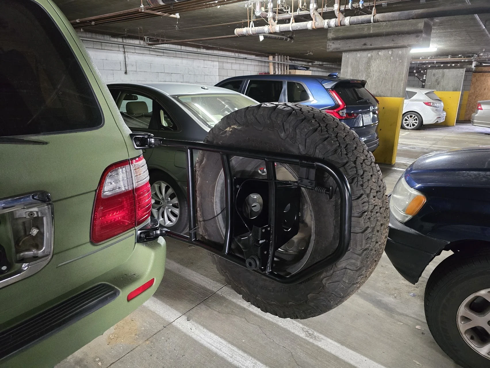

I finally got my OEM tire carrier installed so I thought I'd post some pictures and try to post as many details as possible. The first thing I did was download a diagram of all the parts needed for the tire carrier so I could put together a parts list. I can only attach 5 images so some of these are imgur links.

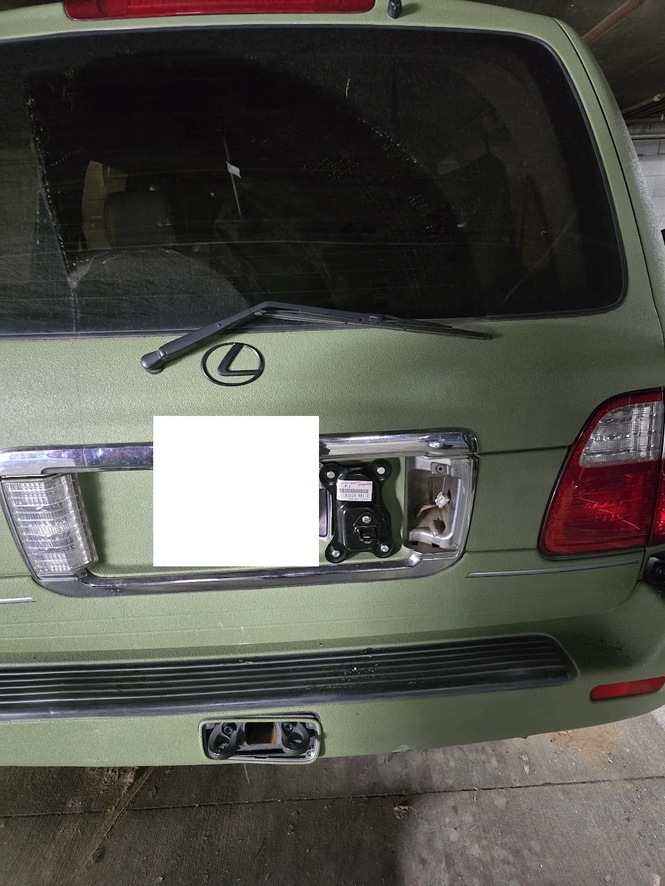

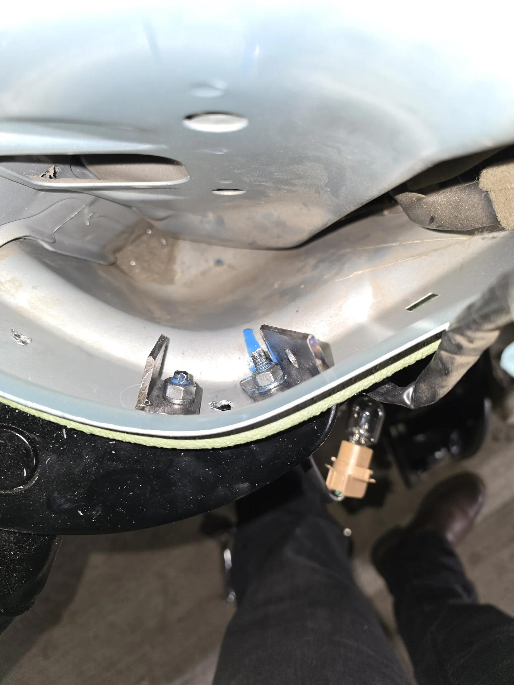

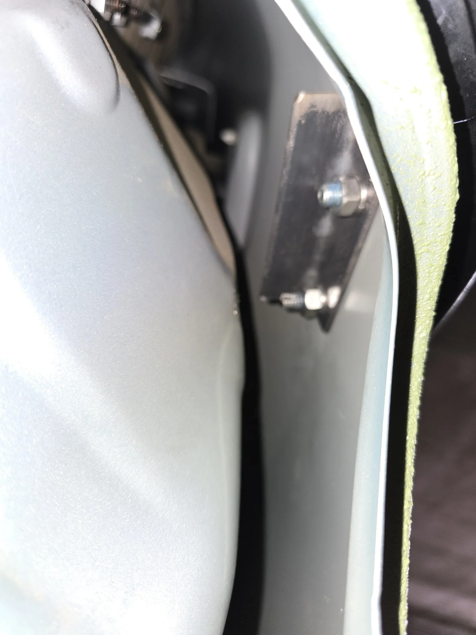

I'm no tradie but I I believe the angle iron will be sufficient across 6 bolts to keep the sheet metal from tearing and I cut them in a way to minimize the bends of the sheet metal. If the sheet metal tears, I will update this thread with egg on my face. The is no OEM solution for reinforcing the sheetmetal as I believe the D pillar reinforcement is only done at the factory. You can buy an oem reinforcement for the latch guard but it was pricey so I used angle iron there as well. You will have to remove the plastic trim for the bottom hinge to ensure a good fit. I intend to cut it right up to the hinge and reinstall it so it's less bald.
To get the latch to close correctly on my LX470, I had to angle the striker with two of those ABS spacers turning it towards the latch just a tiny amount. I believe I used 5mm all around plus 2.5 on the left side to get the angle right. I'm noodling how to get my light installed but it involves cutting into the tire carrier a bit. I might see if I can adjust the light fixture instead. I used the 60 mm bolts here to account for the spacers. Do your best to avoid hitting the key hole mechanism for the rear tailgate when aligning your striker/latch plate. I almost knicked mine. I covered up my keyhole but I never use it so I didn't mind.
I'm sure I missed some of the details but a lot of the work was coming up with the parts list so I hope that at least benefits someone here.

So I reinforced the pillar using angle iron. I have a structural engineer buddy who was confident that should be enough. It's very tight in there and that felt like the most strength I could get together aside from building a custom plate for the entire pillar that contours to all the curves. I bet you could build something nicer if you worked with a fabricator.

Been thinking of doing something similar since I've done the same 'oem rear tire carrier' type job to my Isuzu. Looks great, and probably the best one by far in my opinion. How did you setup your angle iron on the inside of the panels - any photos you happen to have from installation?
It's a really tight fit inside the paneling, but I forgot thread locker on a few bolts and I'm going to apply it this weekend. I'll try to snap a few pictures for you and update the post.

Yeah, if you check out one of my pictures you can see the angle iron that I used to support the inside. It seems very strong and I talked to an engineer buddy of mine and he thinks it's plenty as long as the bolts are tight, have loctite on them, and a lock washer so that there's no way it's bouncing around tearing into the sheet metal
