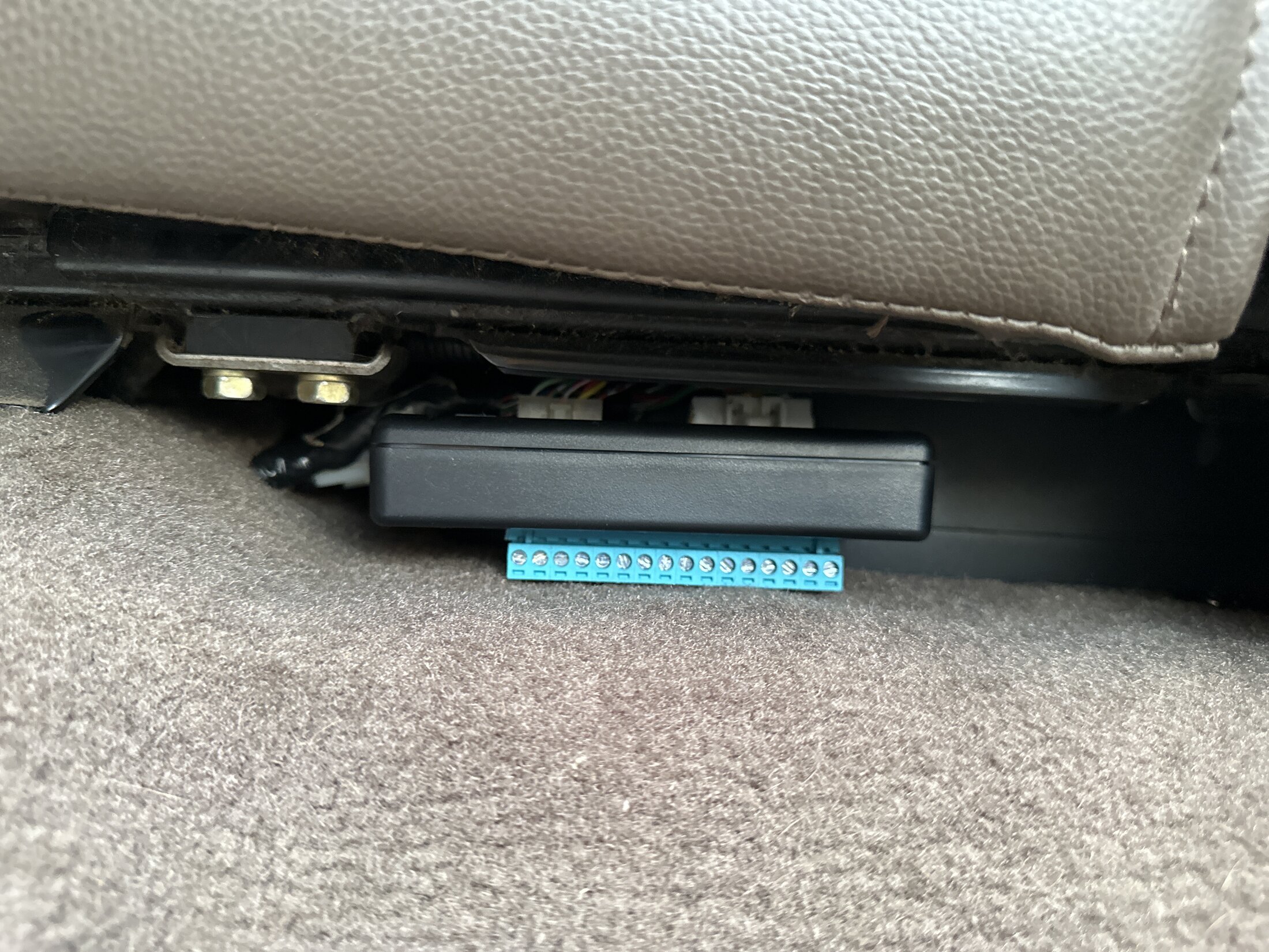

It's 2024. You guys should be using the Lutz Auto RS-3000 alarm converter that Bryan made.
I just used his converter to install a Viper 4806V for keyless entry and remote start. It only took like 15 minute and is working like a champ! I've wanted to ditch the RS 3000 for years but was reluctant to hack up my factory wiring to install an aftermarket alarm. I'm glad I waited because now I've got a nice half mile range on my key fob and all without cutting any factory wires.
I just used his converter to install a Viper 4806V for keyless entry and remote start. It only took like 15 minute and is working like a champ! I've wanted to ditch the RS 3000 for years but was reluctant to hack up my factory wiring to install an aftermarket alarm. I'm glad I waited because now I've got a nice half mile range on my key fob and all without cutting any factory wires.View attachment 3659758
'lutz Adapter specifically states it won't support remote start, was the extra wiring pretty straight forward? Or did you not connect remote start?
Correct. His converter only integrates aftermarket alarm commands into the factory RS3000 wiring (horn/piezo buzzer/door lock/unlock, etc.). Adding the remote start features will be a little more involved and so far I'm holding off on that part until I have more time/energy to tinker with it. I've pre-wired it as much as I can though as the Viper came with a Remote Start-specific harness. I've run those wires towards the steering column so when I'm ready, I think I just have to connect the ignition/starter power and the other wires like the brake pedal and e-brake will also need to be spliced in.
I wish I would've known about this! I already spliced into many of my RS-3000 wires along the harness, but I've subsequently uninstalled my Viper until I get time & answers for the remote start. I'm ordering the Lutz converter - that'll at least clean up the stuff I already painstakingly figured out on my own!
