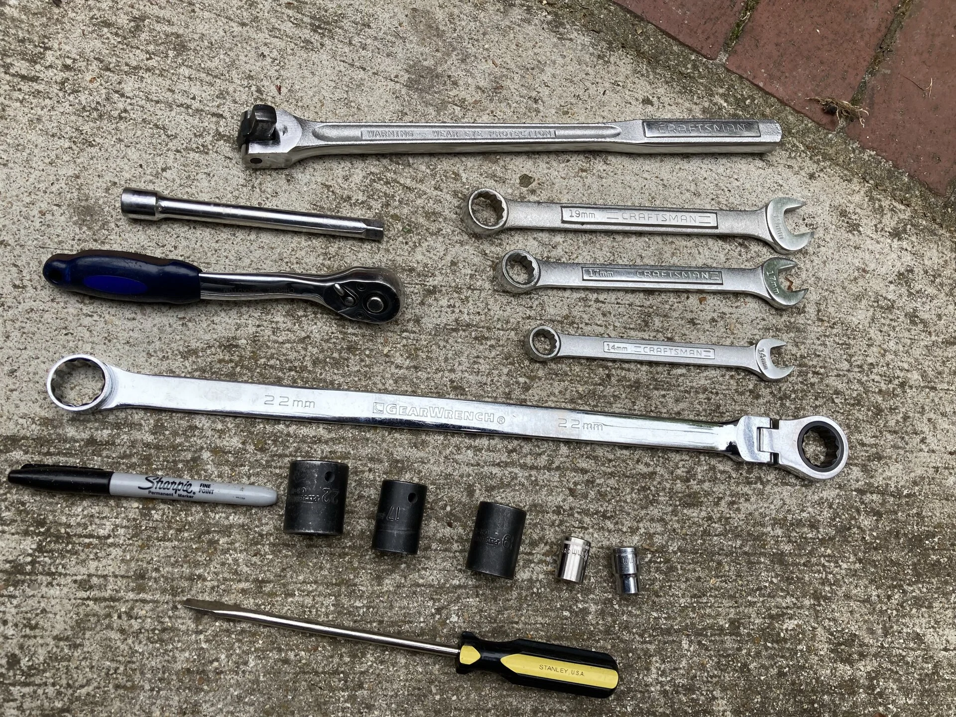

Tools Required:
- Sockets: 10MM, 12MM, 14MM, 17MM, 19MM, 22MM
- Wrenches: 14MM, 19MM, 22MM (or a high quality adjustable wrench)

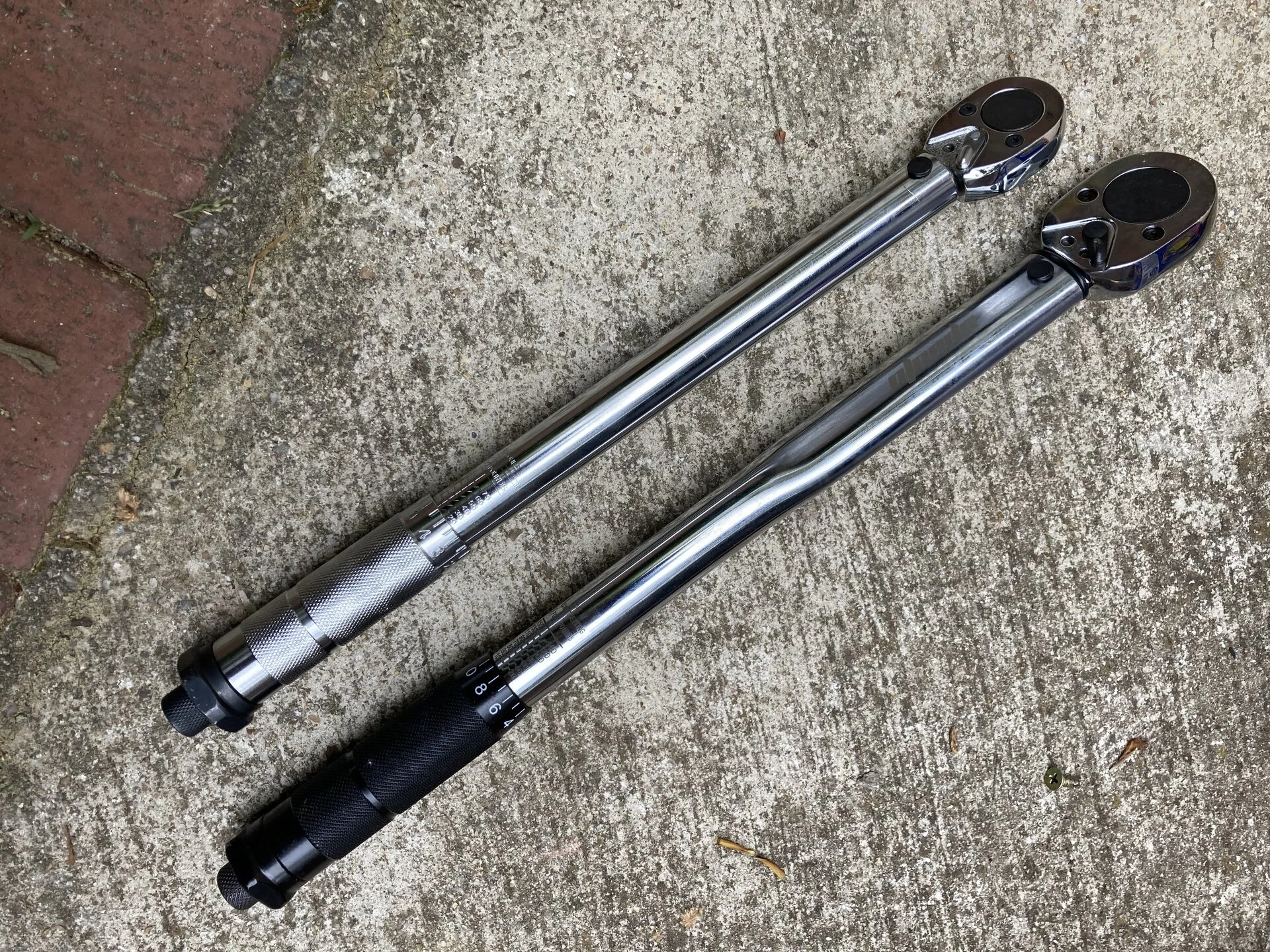

- Torque Wrench/es: 47 ft/lbs, 55 ft/lbs, 70 ft/lbs, 118 ft/lbs, 129 ft/lbs
- Breaker bar
- Philips screwdriver - the shorter the better (for aligning KDSS bracket holes)
- Sharpie (to mark alignment cam positions)
- Large zip ties or ratchet strap (to bring the KDSS bracket back to the LCA)
- Jack
- Jack stands
- Wheel chocks
- 21MM tire iron/socket

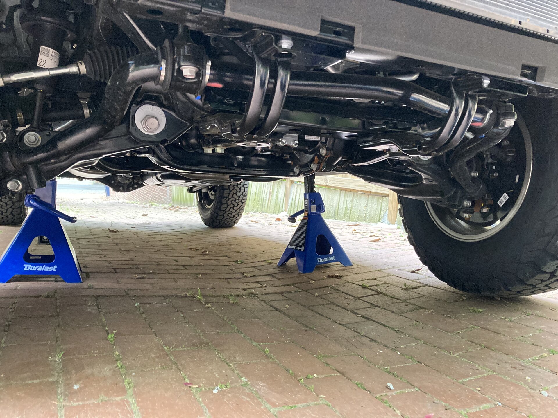

  1. Jack up the front end of the truck and securely fasten it with jack stands and chock the rear wheels. I recommend lifting the whole front end, both sides of the truck off the ground, otherwise the sway bar may make parts of the installation more difficult.
  2. Once safely on the jack stands, remove front wheels.

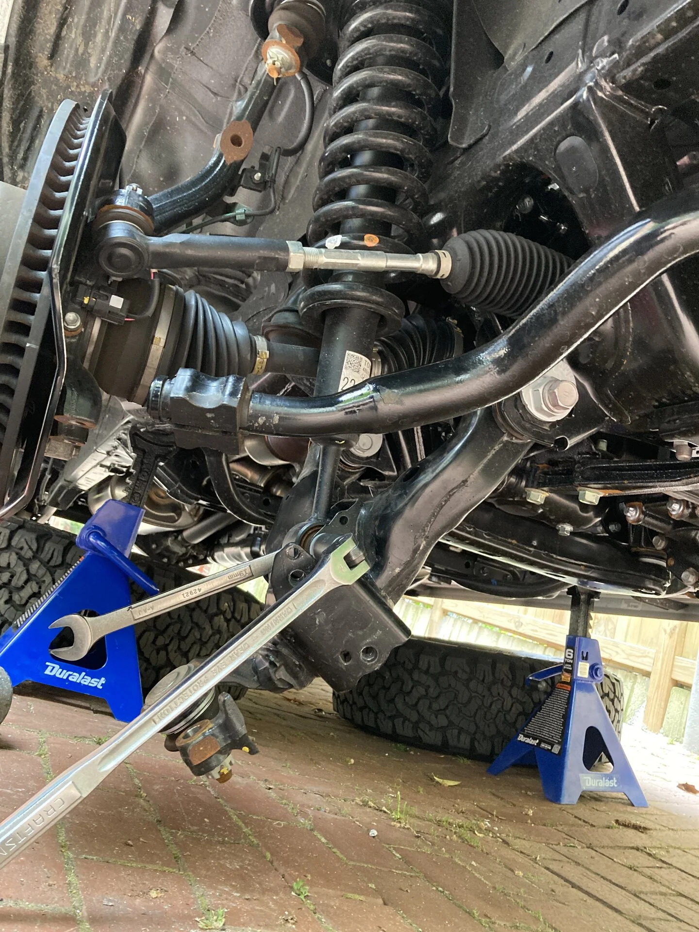

  3. Remove the front skid plate and mark the alignment cams factory location with a sharpie on both the frame and the alignment cam.
  4. Remove the two 19MM bolts holding the lower ball joint to the steering knuckle.

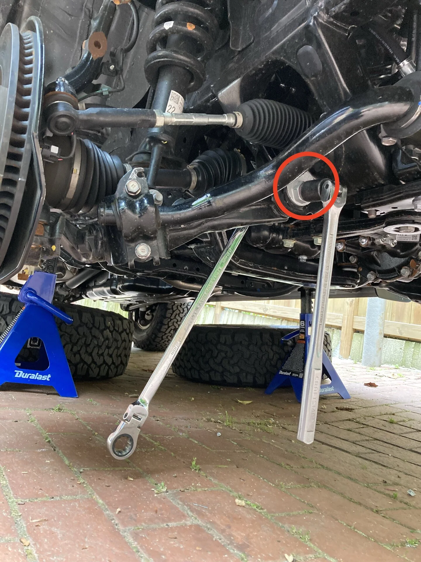

  5. Loosen the 22MM lower control arm alignment cam bolts, front and rear of LCA, to allow the lower control arm to drop down freely.

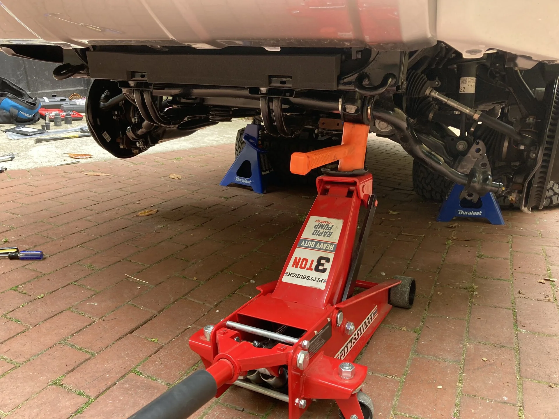

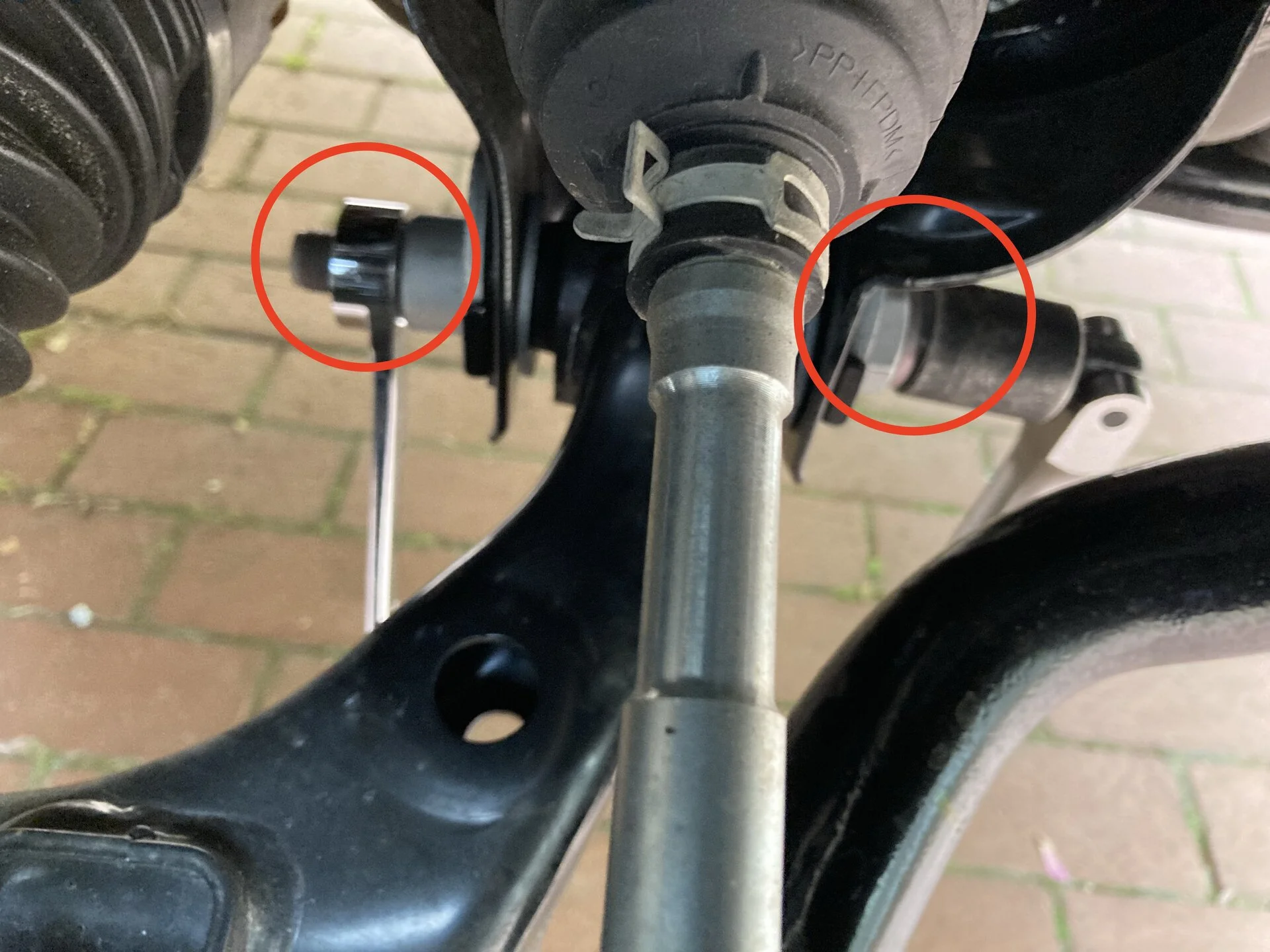

6. Now is a good time to remove the 17MM KDSS bracket bolts from the Lower Control Arms (LCAs). Start with the passenger side and then do the driver's side. You can use a jack to push the LCA up to allow the tabs on the bottom of the KDSS bracket to slide off of the LCAs.
7. Once the KDSS brackets are disconnected from the LCAs, place a jack under the outside end of the lower control arm and put a small amount of upward pressure on it.

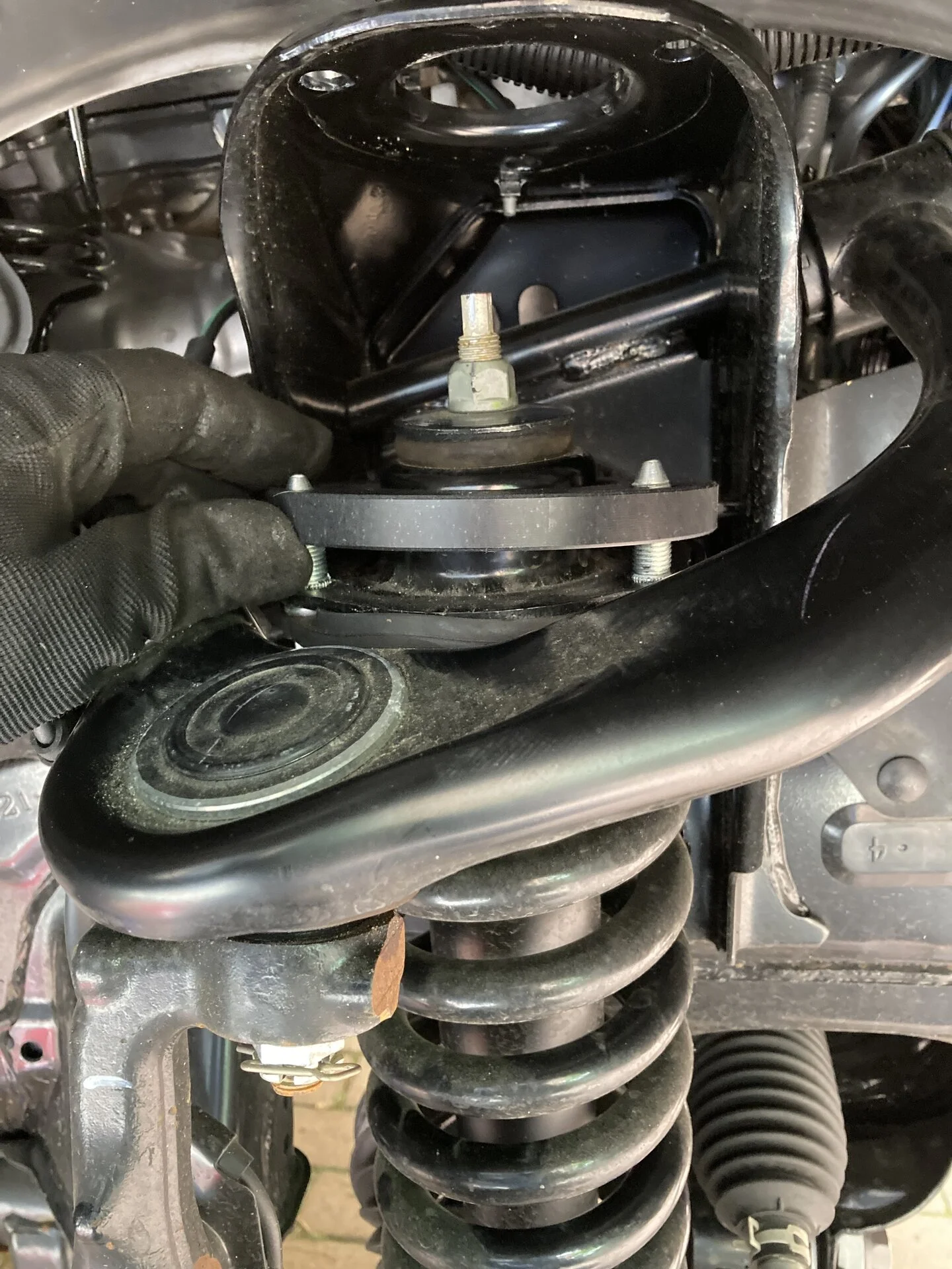

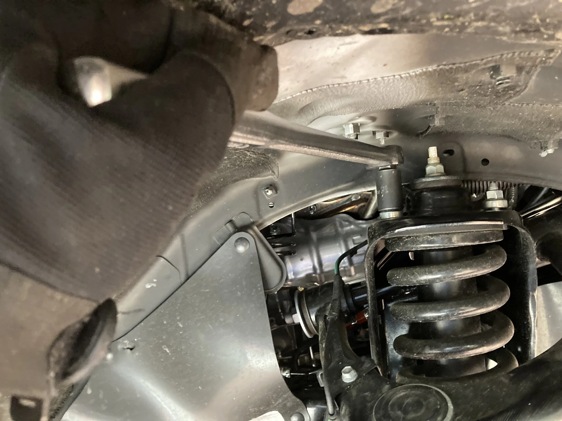

8. Remove the 3 14MM nuts on the upper strut mounting plate, these will be replaced by the low profile nuts that came with the Cornfed spacer.
9. Lower the jack slowly, allowing the strut to lower and slide out of the upper strut frame mount.
10. If necessary (it wasn't for me), remove the 19MM lower strut bolt and allow the strut to droop down between the control arm and the tie rod.
11. Install the spacer with the 3 holes over the strut top plate.
12. Push the strut and coil back up, and secure the upper strut mount to the frame using the 3 14MM low profile nuts included with your kit at 47 ft/lbs.
13. If you had removed or loosened the lower strut bolt, then lift the lower control arm and re-insert the 19MM lower strut bolt into the strut and the lower control arm mounting point and torque to 70 ft/lbs.
14. Re-install and torque the 19MM lower control arm bolts to the steering knuckle at 118 ft/lbs.
15. Adjust the 22MM alignment cams back to their pre-installation adjustment mark, and tighten to 129 ft/lbs. Front and rear cams on both LCAs = 4 Cams to adjust.

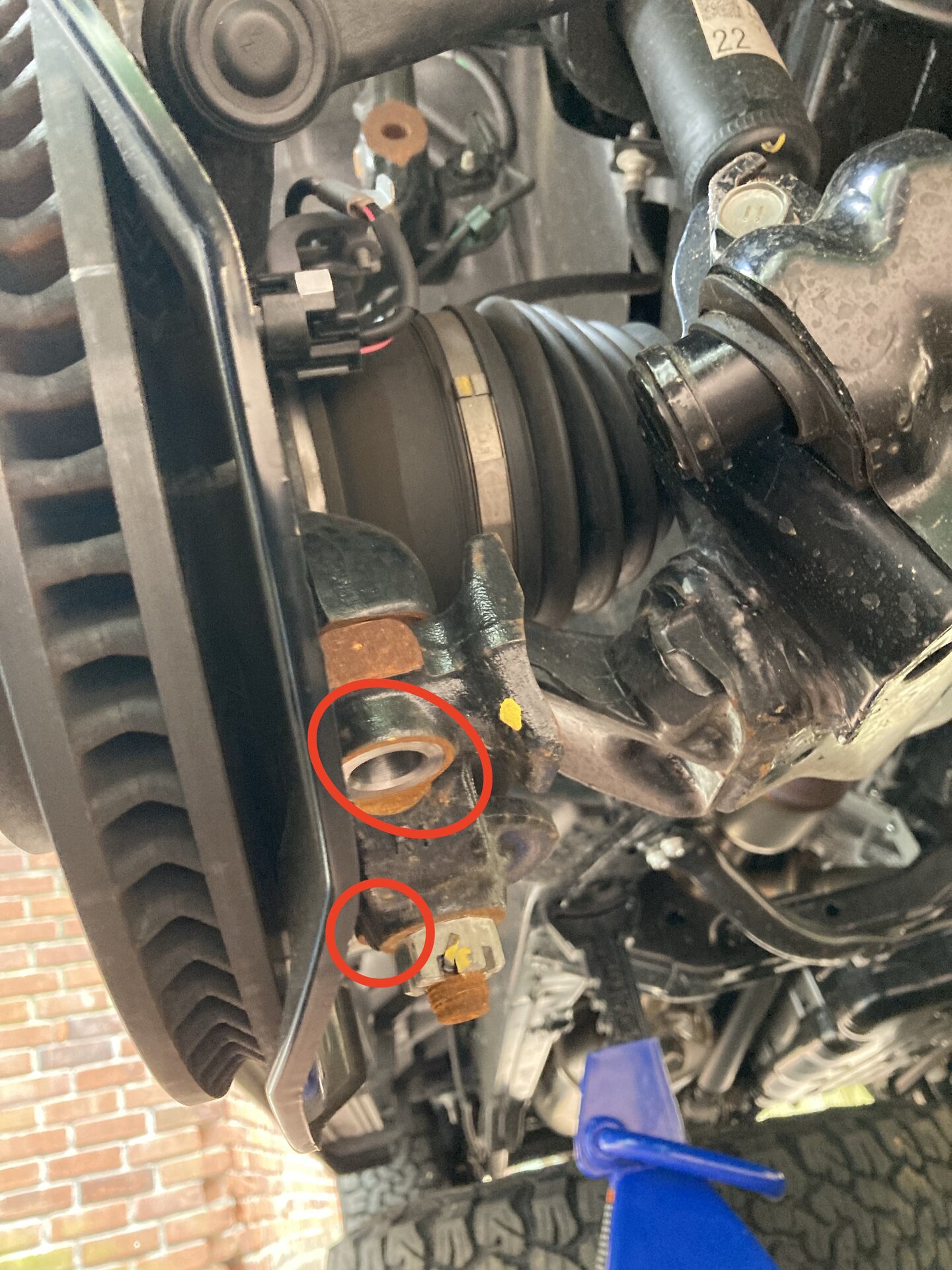

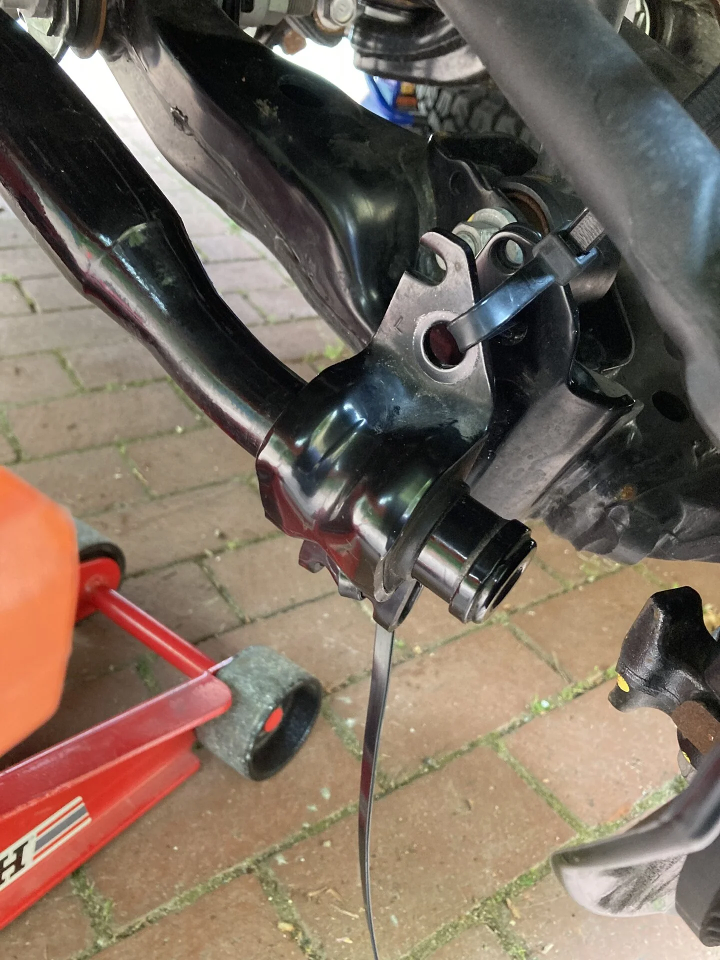

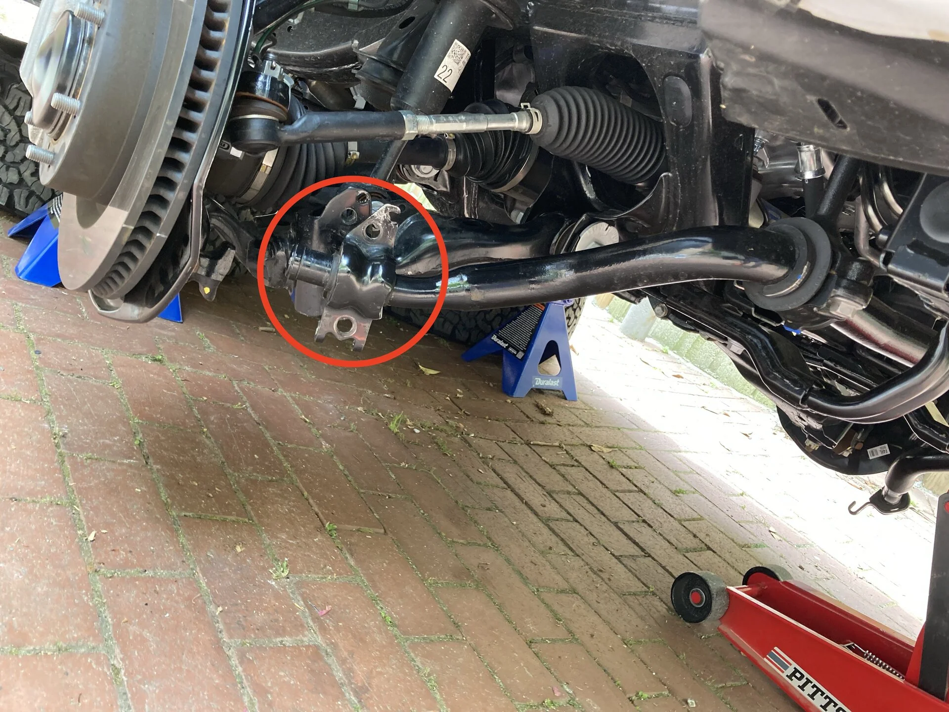

16. Now the fun part- reattaching the KDSS brackets:
  • Place a jack under the KDSS piston and slowly raise it up to align the passenger side bracket to the LCA- add a block of wood or something if needed to get extra height from the jack, I used a dead blow hammer. Once you get the bottom bolt hole to line up, loosely install the 17MM lower bolt first.
  • Now play around with the jack height to get the passenger side KDSS bracket upper tab to line up as close as possible, then shove a punch or screwdriver into the guide hole and pry the bracket into position and loosely install the 17MM upper bolt.
  • (Warning: make very sure you do not cross thread these bolts- it's easy to do- if you do, you'll need M12 x 1.25 helicoil, time sert, or tap and die set, the KDSS bracket bolts are Toyota Part No. 90119-12386)
  • Once both bolts are in, tighten them down only enough to leave about a 1/8" gap between the LCA and the bracket.
  • Now onto the driver side bracket, you basically repeat the same process by playing around with the jack height and position to align the bracket.
  • At this point, the KDSS piston has a natural tendency to tilt outwards to the front of the vehicle making the gap between the bracket and the LCA huge. You can use large zip ties or a ratchet strap to pull the bracket close to the LCA. Use a screwdriver in the guide holes on top of the bracket to further align the bolt holes.
  • Once the first bolt is in and loosely threaded on, move onto the second one.
  • After you get both bolts in, tighten them down only enough to leave a small gap like the passenger side.
  • *Important: Only after the truck has wheels back on the ground, will you torque down the 4 KDSS bracket bolts to 55 ft/lbs.
