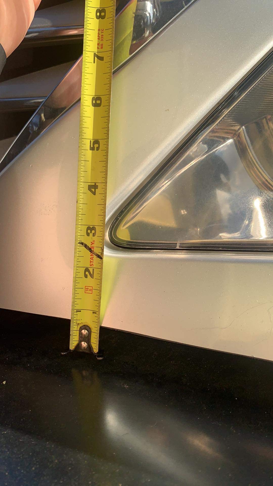

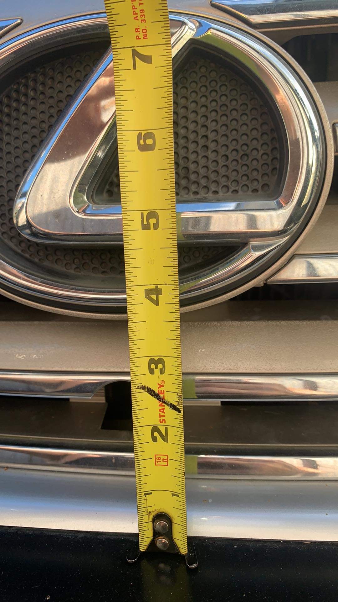

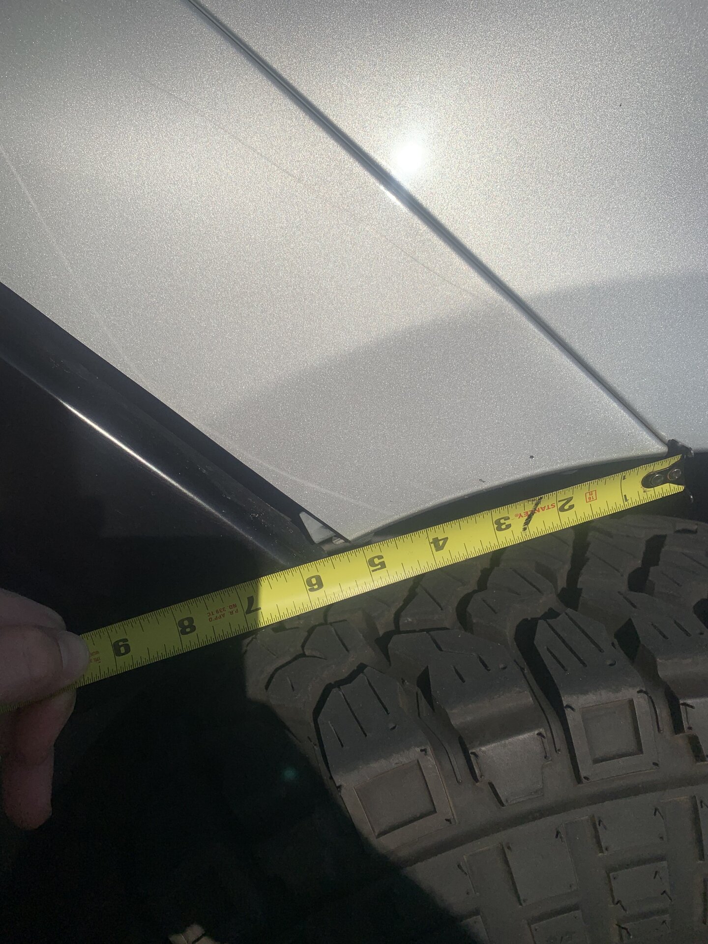

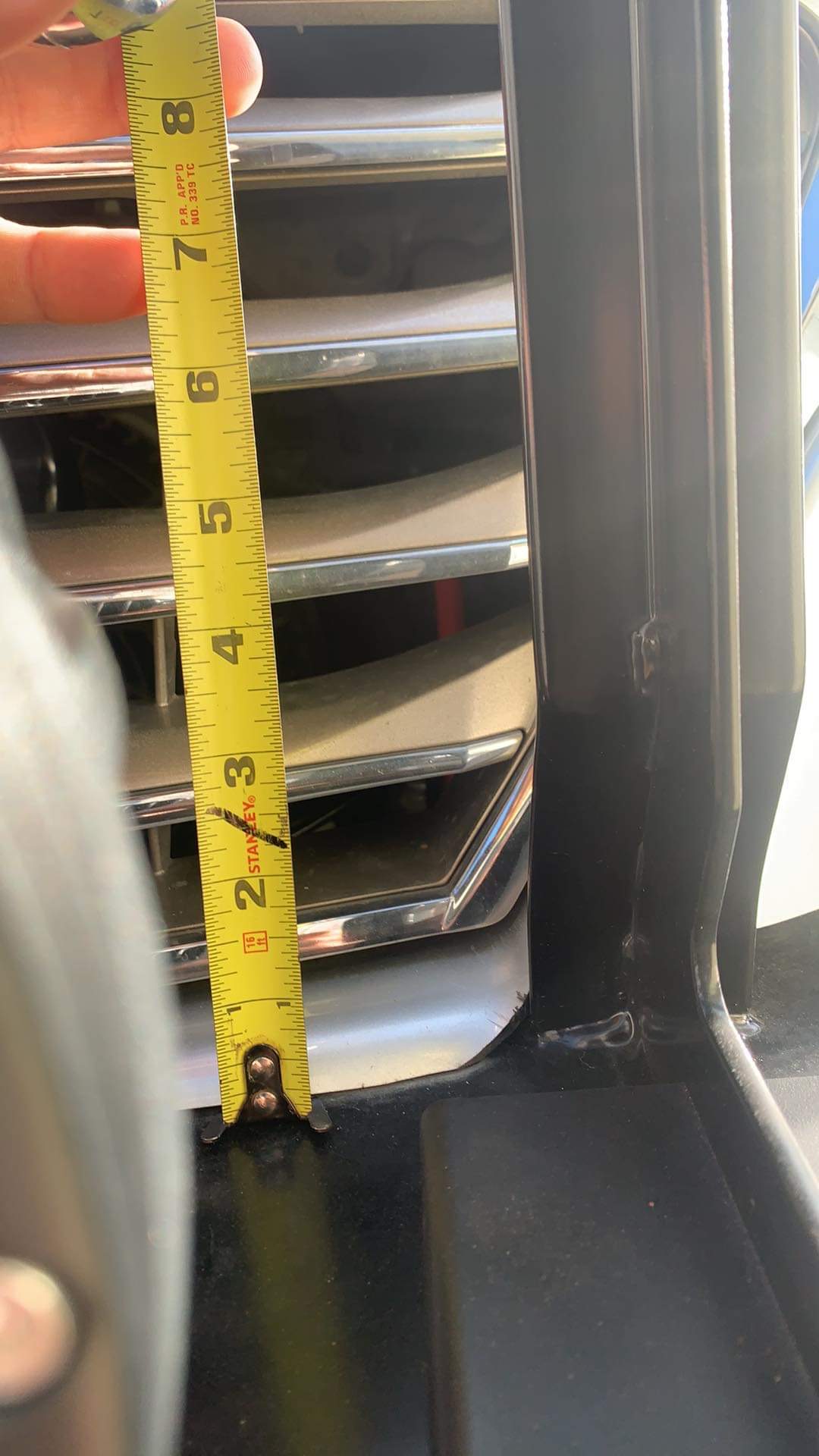

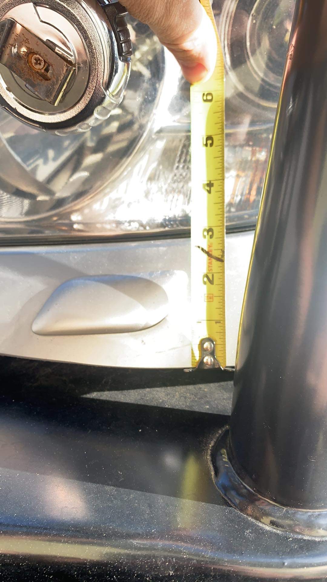

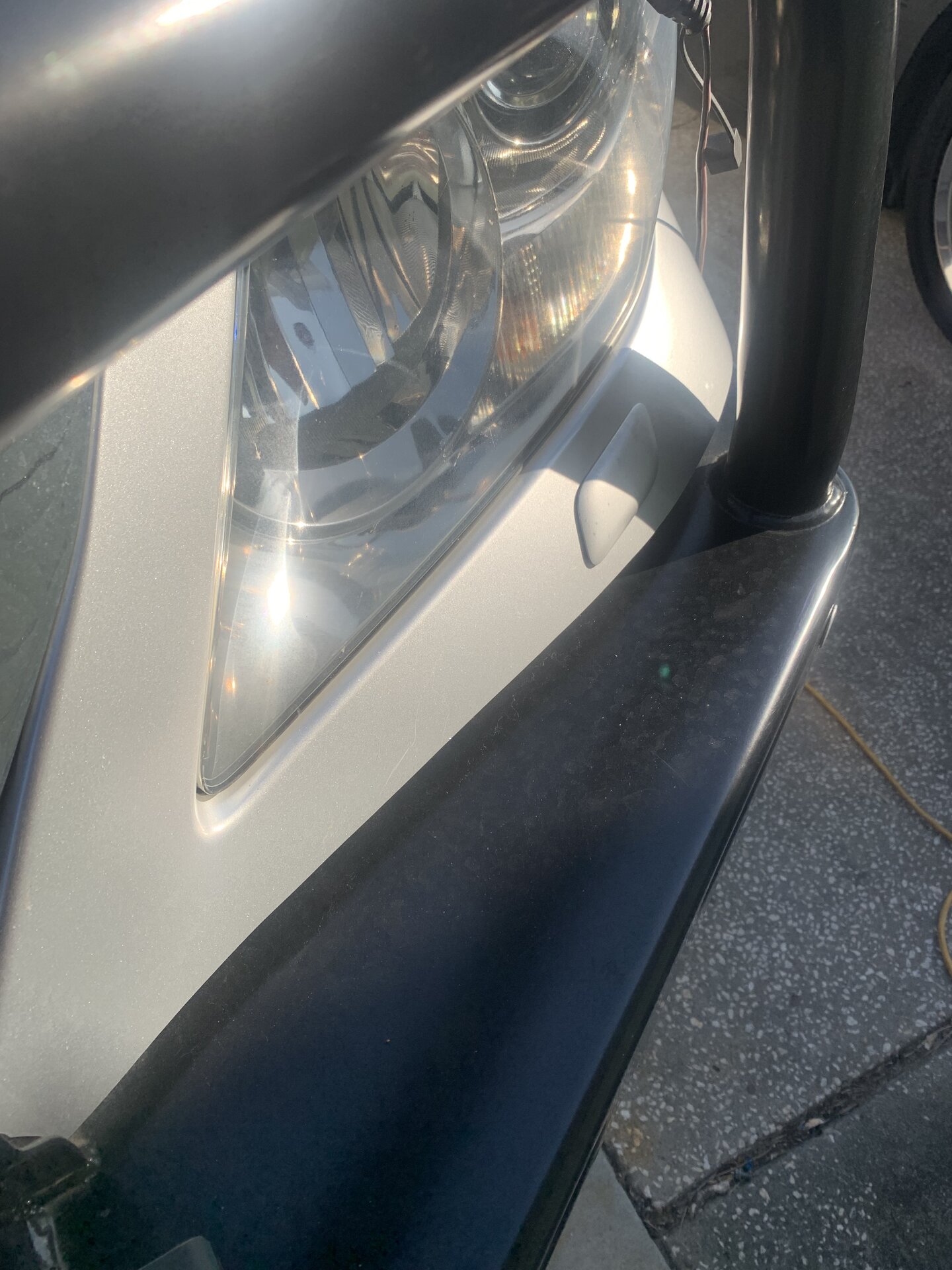

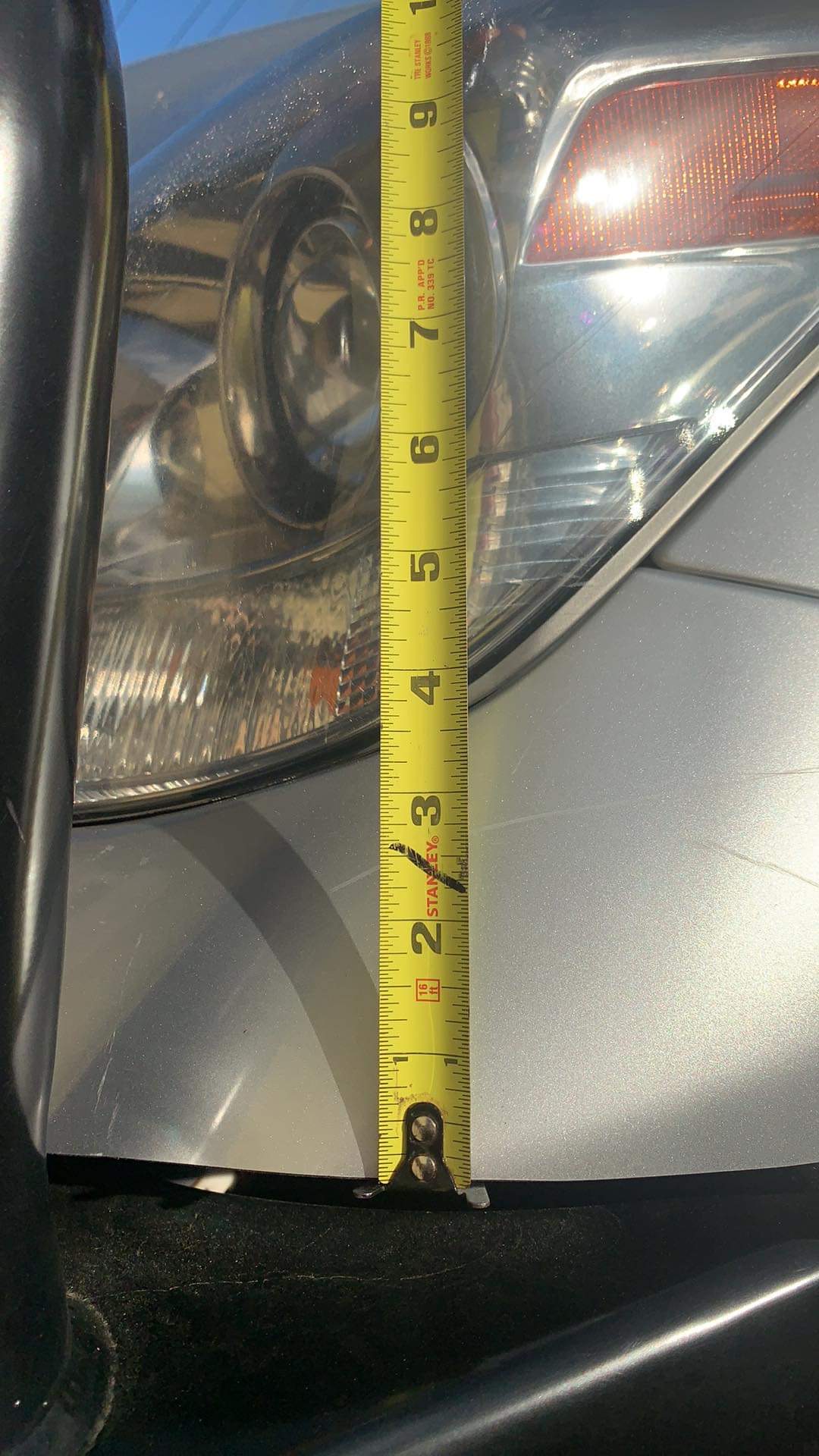

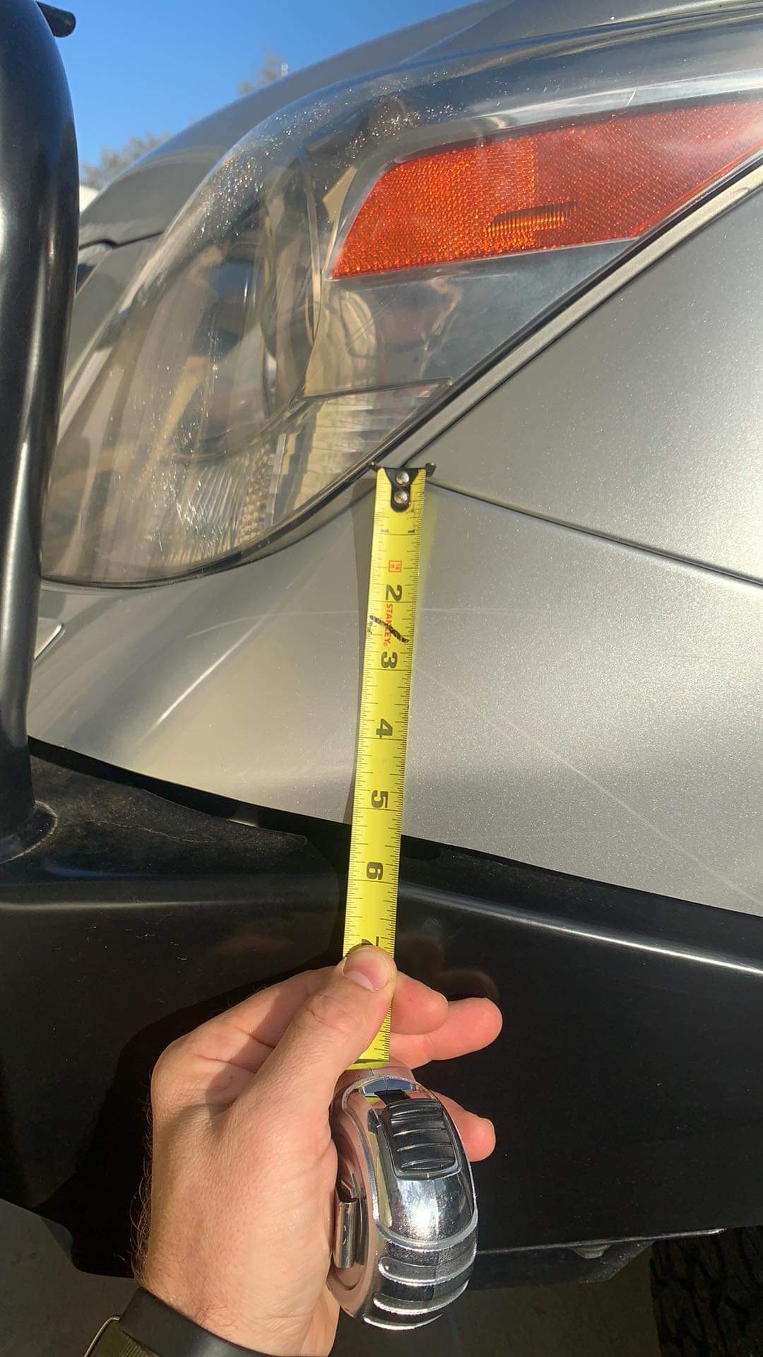

I don’t know if I’ve already posted these photos somewhere but I’ve been asked for them a couple times via social media…so I’m going to post them in this thread.
(5 photo limit)

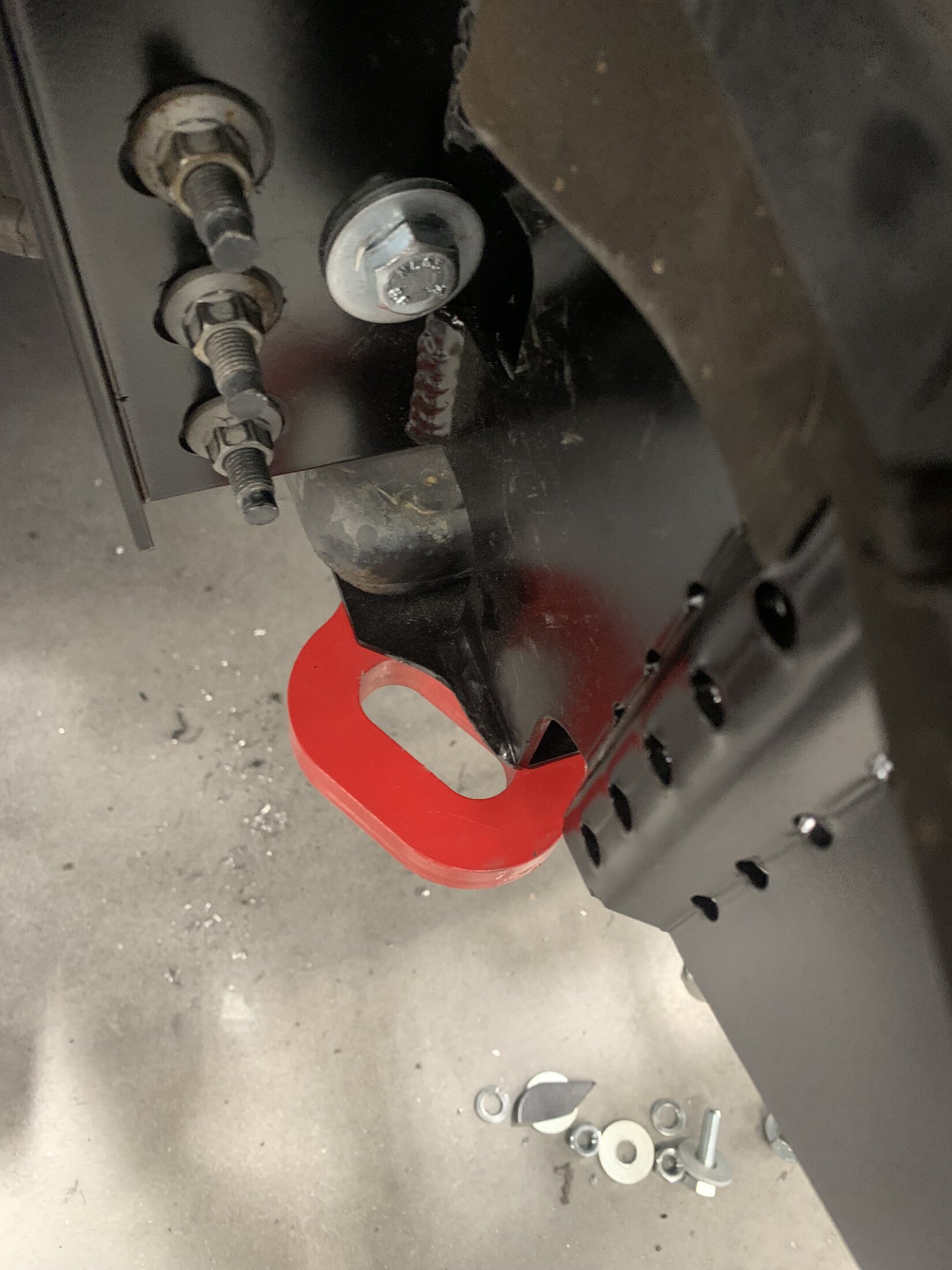

Just notch the iron man brackets and run whatever you want.
Hey all. I have ironman bumper and factory points are blocked by the bumpe mount.Any sugestion whst yo buy?
Like tbisaacs said, you can notch the mounting brackets for the ironman and run arb recovery points…images attached.

I ended up not using them. They eat up like 4” front clearance because they hang so low. I notched the iron man mount and am running arb recovery points.

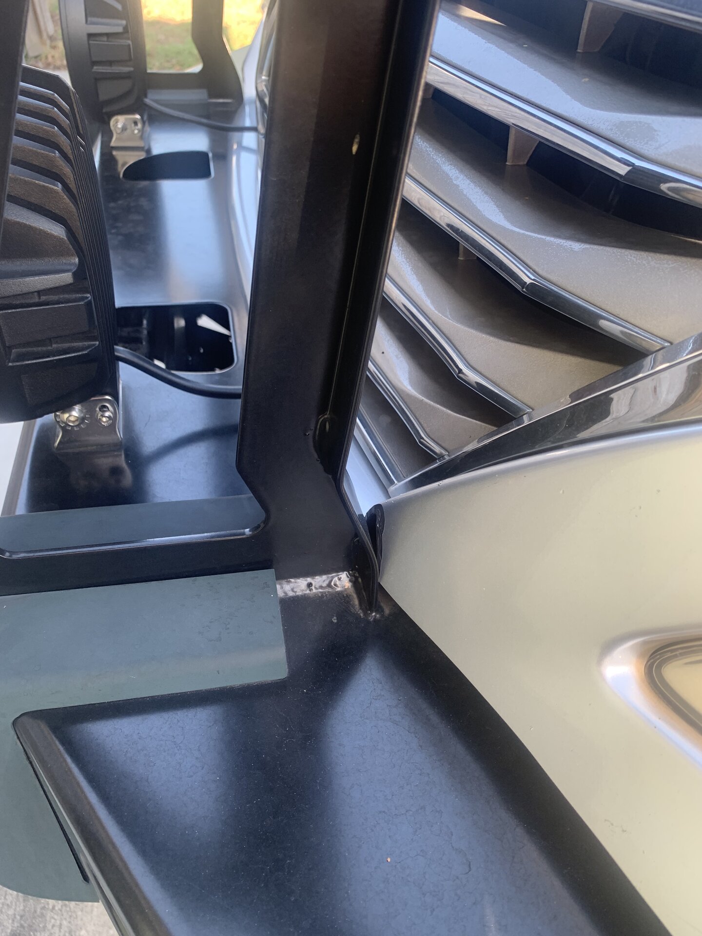

The Apex does barely fit though. For example the mounting plate to relocate the control box is about 1/4” deeper than the bumper.
Currently having the same issue with the mounting plate for the Apex control box, how’d you end up making it work?
notched the bottom to slats of the grill to make room
