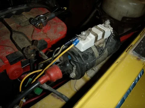

77mustard40 SILVER Star 10 Year 15 Year Joined Nov 28, 2010 Threads 59 Messages 2,918 Location Austin, TX Jan 28, 2013 #42 Courtesy photo for the buyer of my original small cap dizzy with Pertronix and coil, here is how my 8/77 was wired. That's the red wire from Pertronix to the top where the BY ignition comes in, black Pertronix ground to the ground terminal on the coil.
