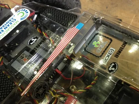

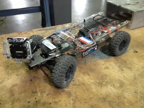

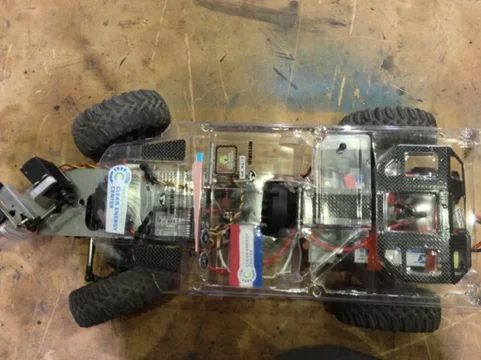

Update on the project. Still need a couple things to compleat it.
Wire harness from gopro to live video out transmitter.
Ball bearing support mounting plate to eliminate stress on the pan servo.
Lights
Retrieval system. (Deep sea real)
It will also have a disconnect system on the front that will remove the pan tilt system and re attach the camera lower in order to view deeper into the tips of a blade.

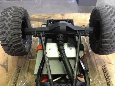

The suspension has been completely removed and the axles are hard mounted. Witch is perfect for this application. The added weight of battery's and the soft tires gives this thing crazy grip and can climb up the walls of a blade beyond my original expectations. Ill post video when i get the live video all hooked up.
And of corse its rocking IH8MUD stickers! You guys were a big help thank you!
