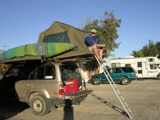

we carried fuel both in and above the truck all over the place for a year and more.
If we are talking about one or two cans, roof rack is fine- I doubt that 10 gallons a fuel is going to make the diff between tipping over and not tipping in the vast majority of situations.
There's no way I'd carry 8 cans right behind the driver's seat. I know that they are built tough, but in the event of a collision, do you really want 40 gals of gasoline sitting 6 inches away? I don't.
Finally: Where are you driving that you think you'll need 40 extra gallons of fuel? Thats at least 300 miles from the nearest gas station (65 gals total, 300 miles each way with another 25% or so "reserve").
I mean... I've done 300 miles between gas stations in Baja. But never 300 miles *from* a gas station.
Just curious.
edit: in my opinion, a better solution is to carry 2 jerry cans on the rear bumper, then, if needed, a third and/or fourth on the roof. 4 cans should get you an extra 200-300 miles.
