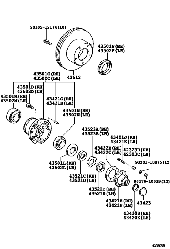

Does it look something like this?
Yes when you slip the hub assembly over the steering knuckle you preload it spin it and then Loosen and retorqye it
