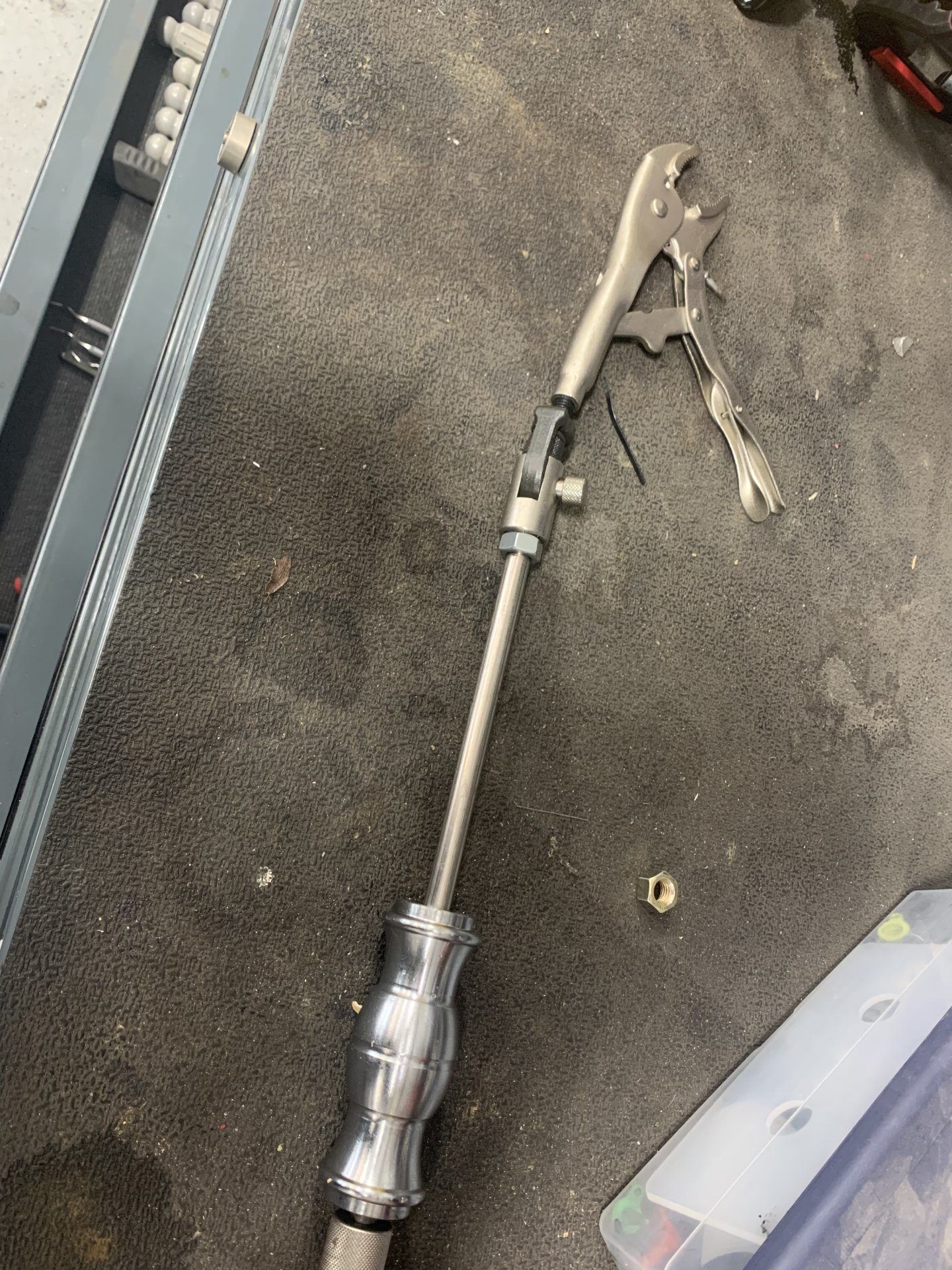

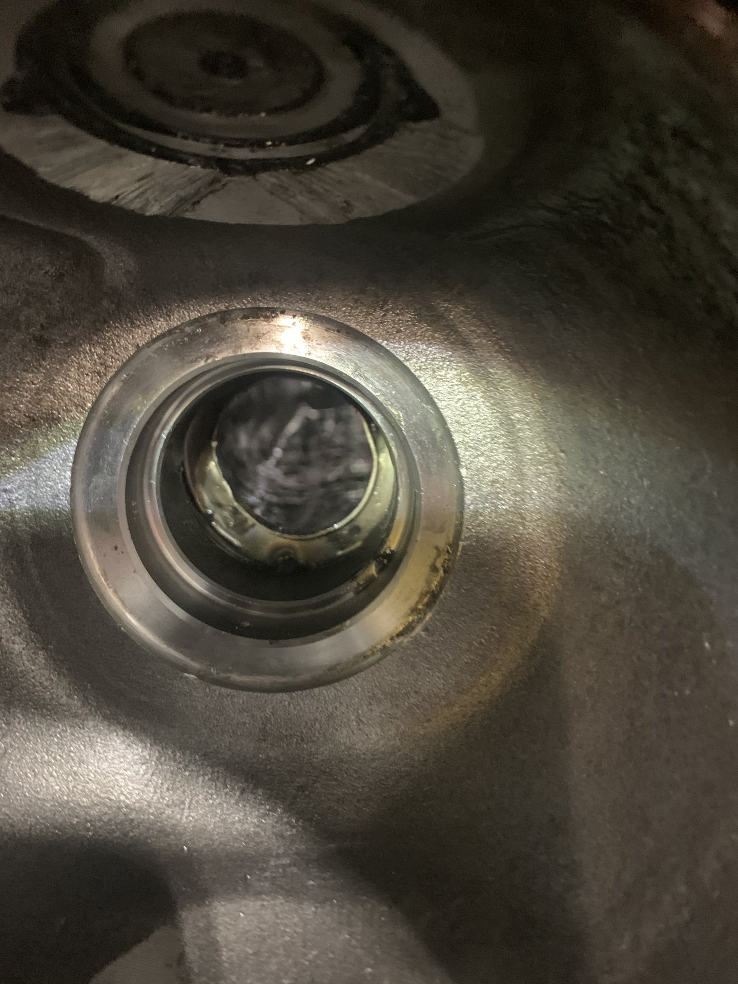

Got it handled, wasn’t that bad after all. Decided to reset the index ring. Straightened it out pretty good. Then made this tool hooked to a slide hammer to drive it from the inside. My 3rd member is out so it was easy to slide it in. Then I placed a tack to keep it from moving.
