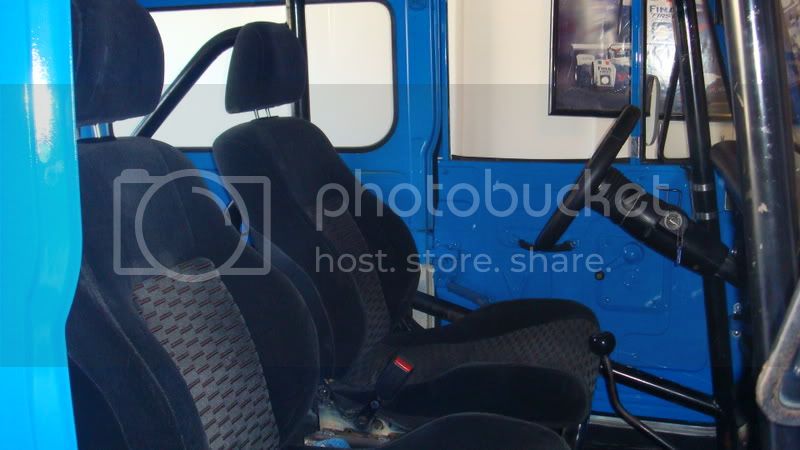

I changed my seats out to 2002 Celica ones. I did use the brackets from the original seats however.
We could meet up somewhere if you'd like to see what I conjured up. No welding was done for this

I just went from non OEM seats back to original seats. The brackets for the driver side was missing so I just made some out of steel plate for the front and 1.5" sq tubing in the rear of the seat. You could do the same for after market seats.
