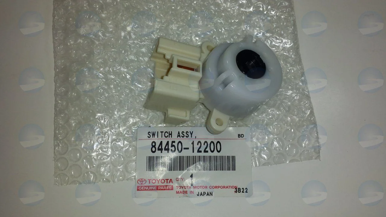

I ordered a new ignition and that didn't fix it so I took it back and ordered the wire harness for the ignition to see if there is some sort of short in it that the key grounds when it is in the ignition

Any fuse I could remove to keep truck from draining the battery if it is something in the ignition switch? (I pulled the crazy EFI relay and fuse last night)
if you put the new one in, and take apart the old one and snap a pic that would be awesome. I wonder how worn the inside contacts are.
Plan for the moment is to through the replacement into the drawers and wait to see if it starts up again, long list of things to do and I did NOT need this right now... sucha s the passenger window that just broke it's mount. I would prefer to do the switch and the ignition bracket at the same time, but that's another $300 <sigh> My FJ62 never gave me this grief ;(
But when I do it yes I will snap some pics and post back here
